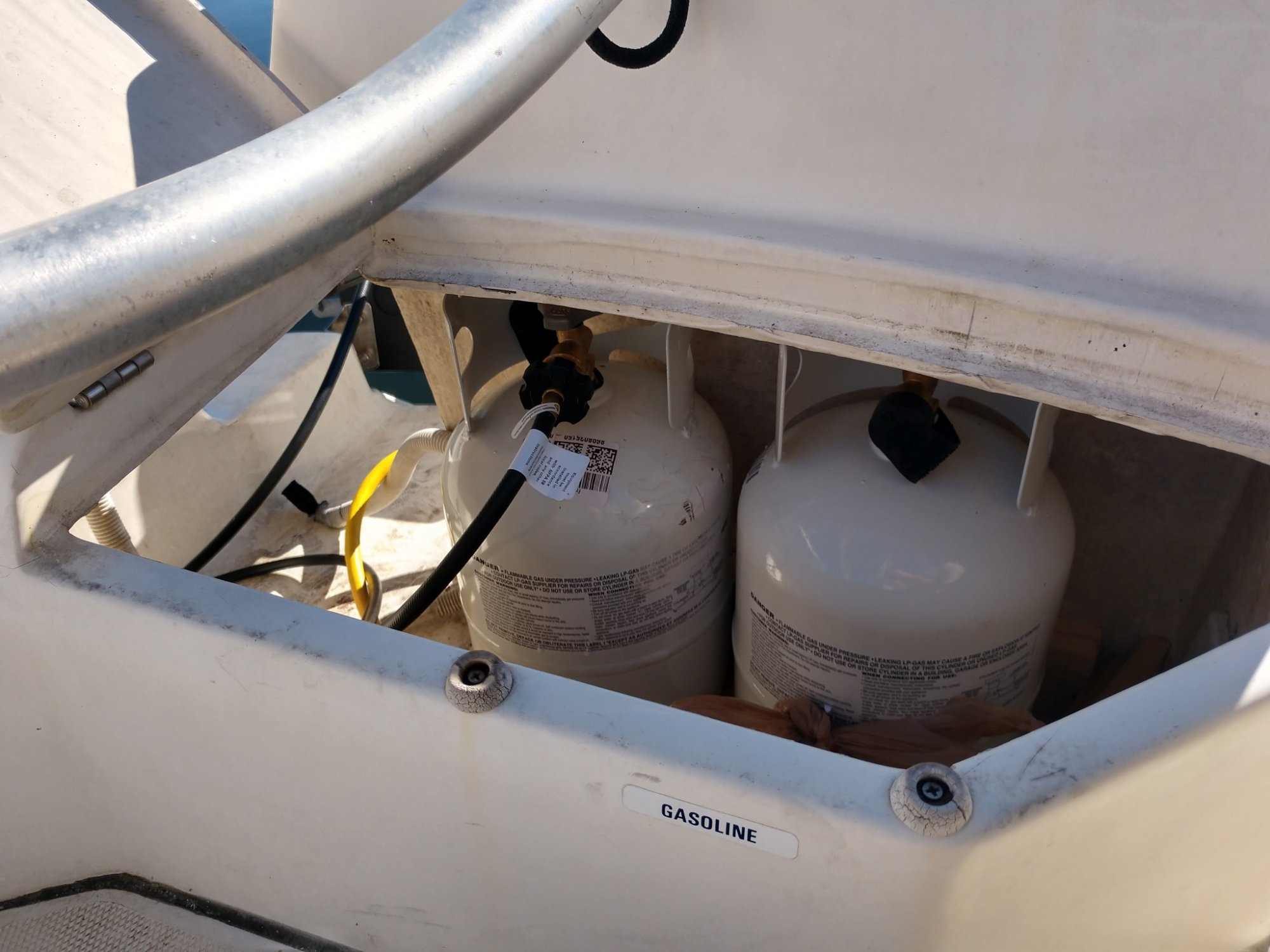

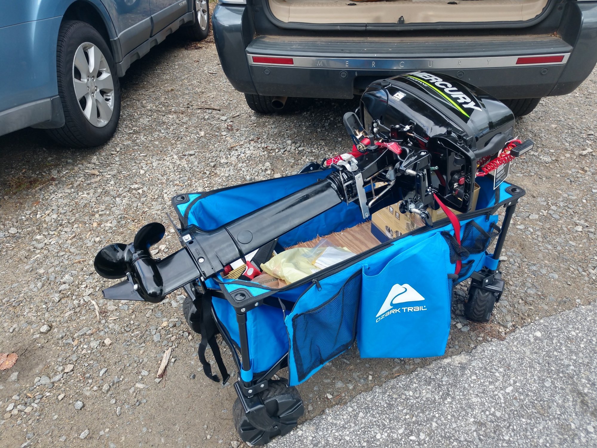

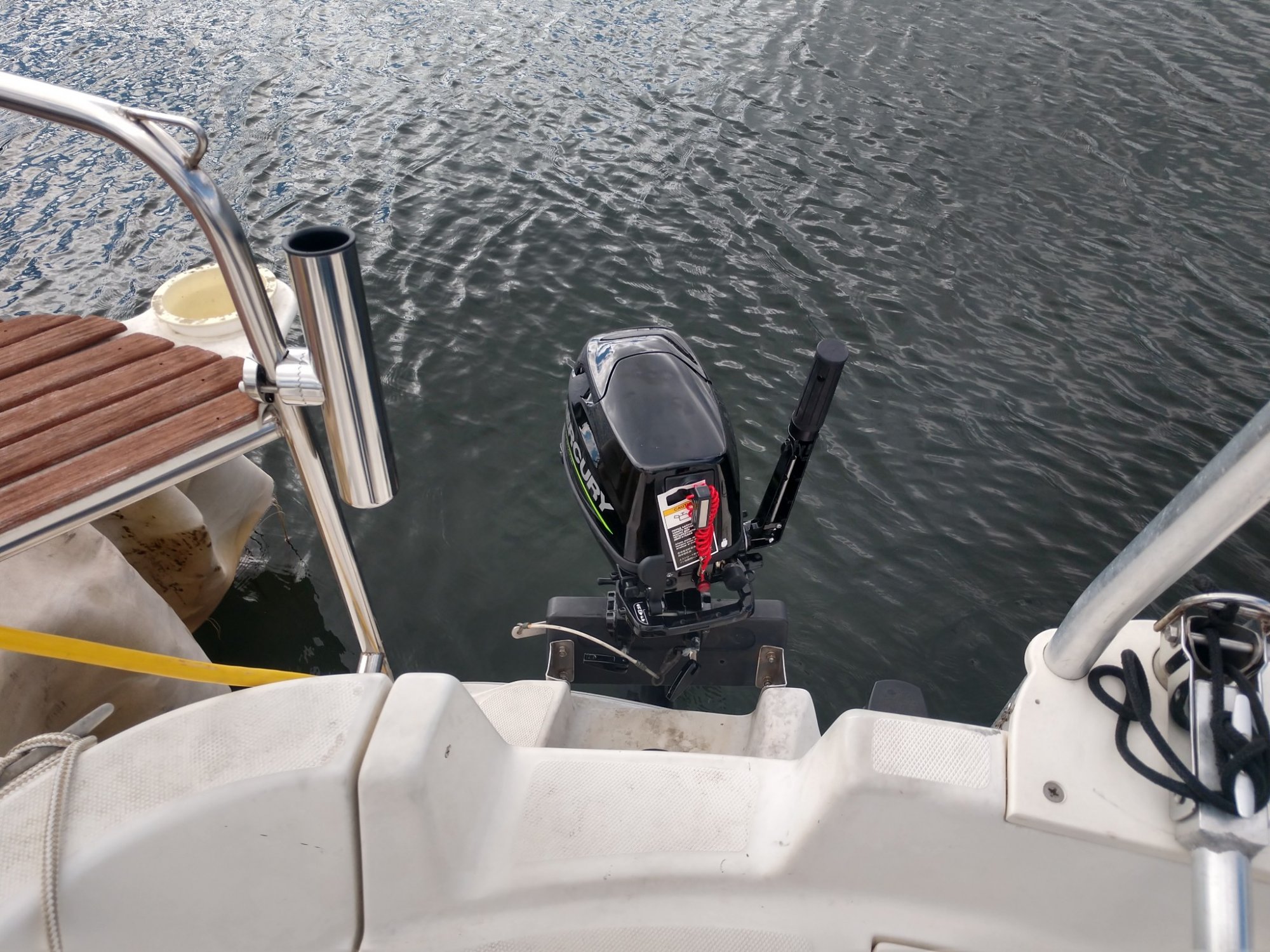

My H240 came with a 2006 Honda 8 hp outboard. It ran great the first two times then would not start. I checked everything electrical and figured that it must be the carburetor. I like the motor but it was to heavy to pull by myself. It weighs 90 lbs. I keep my boat in a slip and only use it go get in and out of the marina. I bought a 5 hp Mercury Propane and I would do it again. It moves the boat at it's hull speed and only weighs 57 pounds. $1,800 from West with the longer shaft and the charging system.
