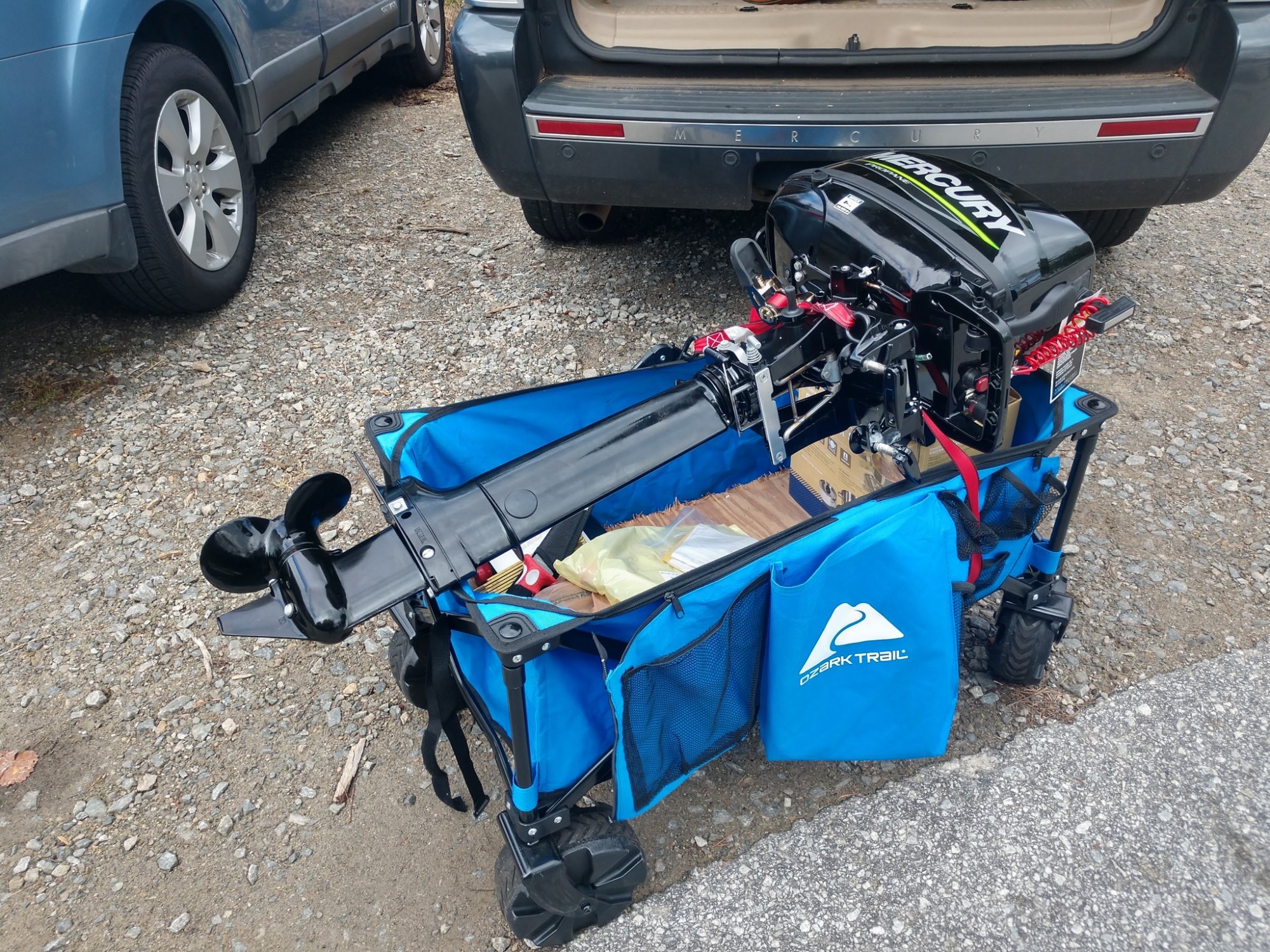

If you get into trouble with the sails up and you have to power out, as working off a lee shore, the longest shaft you can get is great because the shaft is not in the center of the stern and the windward side of the boat will lift the prop up and out of the water. I am on a lake and as my sailing memory came back from many, many years ago, my standard length Mercury Sailpro (propane, made by Tohatsu ) has been adequate.Mercury on wagon.jpg
