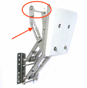

Ok, first, for the Garhauer mounts sold by Catalina Direct, and, if you're a manufacturer or distributor, maybe from Garhauer themselves. (I understand they are easy folks to deal with...) Here's a pic with the nice, broad handle, and nice locking detents for up and down positions:

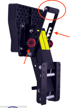

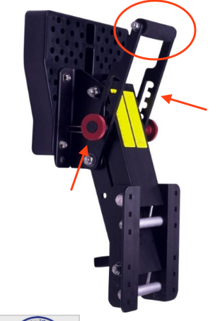

And now here's the newer Garelick 4 stroke aluminum mount they may have been talking about. Hmmm.... looks like they've added a really nice full hand handle at the top. Deep teeth for position detents. Oh, and look at these big red knobs! These must be the locks! Nice touch! Funny, seems like the same overall design of the Garhauer, executed in folded sheet metal, where the Garhauer is welded tubular SS.

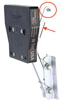

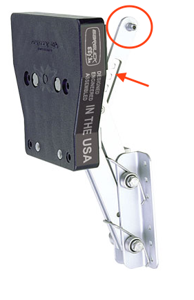

And now for the old skool 2 stroke mounts which were very common to find everyone selling about 5 years ago, and which is the stock on my boat. Yeah, it sucks. It works, but it sucks at the same time. Notice the exceedingly small 2 finger lifting handle, and the relatively shallow position detents. Mine often doesn't lock into position well, but then again, it is over 30 years old. I suspect at some point, I will have to replace mine, and I'll have to cut all kinds of access holes in the starboard lazarette or transom in order to install a new one. I'll also have to fabricate a wider mounting wedge, but it's not really a big deal, what with building it up with plywood and then fiberglassing over. I've seen enough folks post pics of their build, I'm sure I can do it pretty easily. Not that I want to cut holes and contort and reach in to do this particular project... :D

Nice comparison Brian. Some other things you might add,
Garhauer has bronze bushings at the pivot points the Garelick has plastic bushings
Garlick has multiple depth stops vs 2 for the Garhauer (we actually used them all on the O'Day 23, one was perfect for maintenance while sitting on the dock)
Garlick is anodized aluminum extrusions (not sheet metal)
Garhauer has stainless around the mounting pad and at least on the older ones the screws on most outboards would compress
on to the stainless
Wow I'm confused :) we should have used specimen A :beer:and specimen B :beer:
I've never realized until Brian posted pictures exactly why Lee likes the Garlick over the Garhauer (she does 90% of the driving sailing and docking), It's the stiffness of the handle side to side and especially, the direction of the catch slots. I'm guessing it is easier for her (and me) to pull toward us to get the handle to release and push away to lock. It never catches in the slots when you are making the pulling motion to raise and we don't have to hang over the back of the boat as much to raise and lower. Oh well we have an inboard now and she loves it.;)

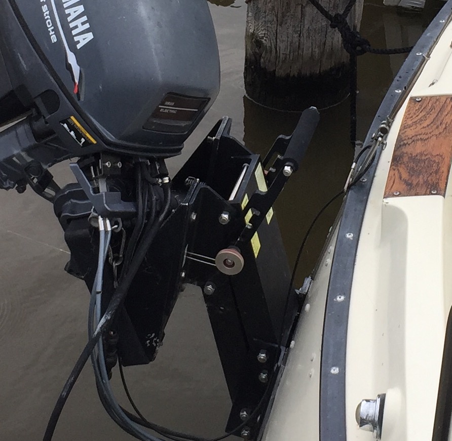

On my last boat I installed a 2 stroke mount like the one pictured and it worked OK. My current boat came with thw Garelick 4 stroke mount and it is great! I can pull the motor out of the water with one hand to the top and tighten the red knobs to secure it. The only problem is if the motor is locked straight, the remote control lines will hit the bracket and bend. I unlock the motor and turn it to the side before I raise it and everything works
