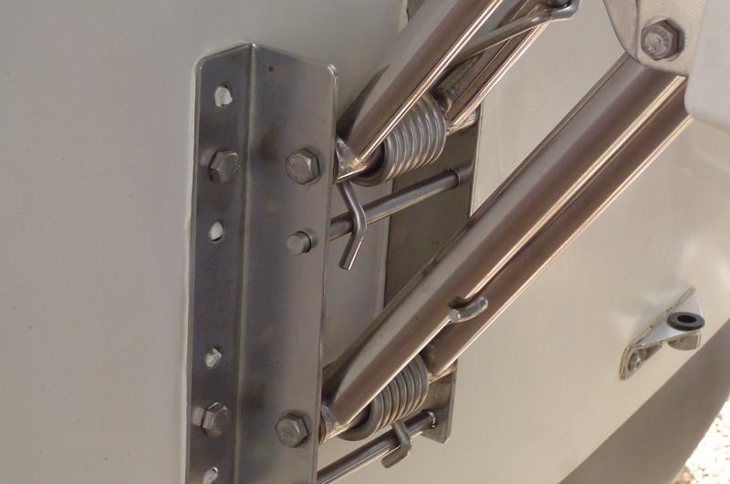

I have the 25" Nissan it's come out of the water no more than a couple of times both in some nasty water over the years, both those times I dropped it to the lower setting and had no other problems. You've guessed by now I use the top settings on the motor mount. You didn't say which motor mount, I have the Garhauer tubular mount. (pic)

We have the same mounting bracket. I'm almost wondering if ours is mounted a little low. In the higher of the two low settings, the board that the outboard clamps onto catches about an inch of water at its base when we are under power. It seems to me like this would cause some unecessary stress on the bracket, although I guess it has been like that for over 30 years now without pulling out of the transom.
