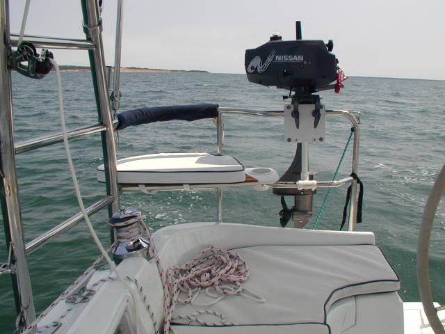

What I Did
Here is what I made to just try out and plan to replace with stainless tubing,but it's been two years and no reason to change,now having all the free time in sunny warm Florida I may change to stainless for a nicer look,maybe.

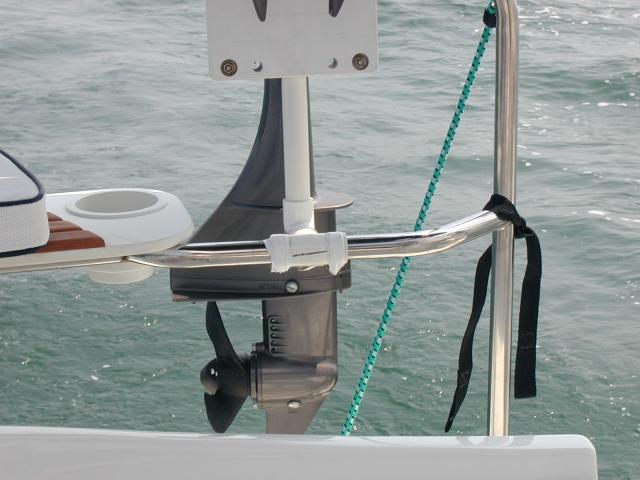

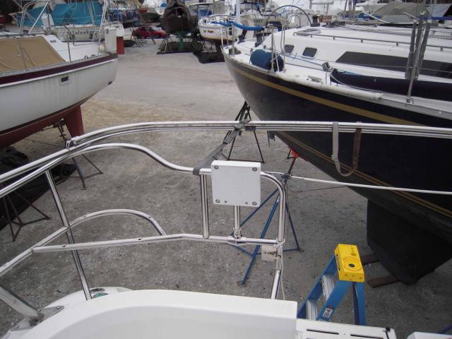

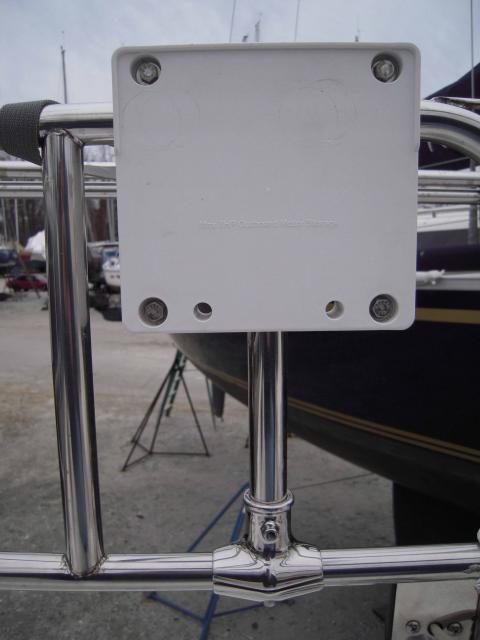

Bruce,
I went to the boat today to catch up on some work and took a few photos of the outborad motor mount for you. This is the smaller West Marine plastic mounting board installed with an inserted vertical rail using a 1-inch split Tee flag post fitting. The Tee fit over the lower horizontal rail and I cut a 6-8" scrap piece of 1-inch rail tubing to fit into the vertical groove in the mounting board. It fit easily between the stern rail seat the vertical pulpit rail at the transom walk through. I took the stern rail seats off today to refinish them.

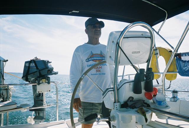

I found a similar fix, though my stern rail is not as curved.
I also went to WM and bought the small, white, two-part panel but was told that WM no longer carries the 'flag pole, split bracket. Jeff, the WM staffer in S. Daytona, thought about it and came up with a Bimini top mount bracket which hinges at the bottom. (See Web Page Picture)
I took the 1" ss tube to the local machine shop and had them cut out the tubing so it would fit flush with the bracket shoulder. They also to drilled two holes in the tube to accept the ss screws that hold the bracket closed once mounted on the rail. Put the bracket on the bottom rail, close, then put the straight flanges inside the tube, put in screws, tighten, install tube into motor bracket and then the whole assembly to top rail. Make sure you buy the correct size for your rail.

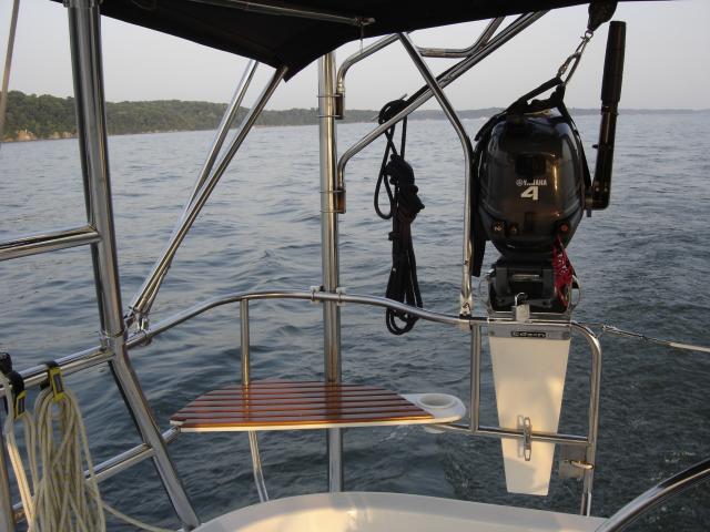

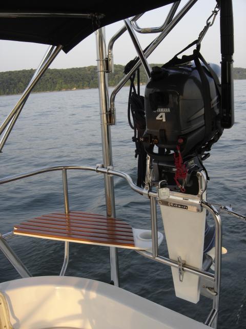

Bruce,
I used the Edson mount on my H33. I had to trim the starboard stern chair (cut a small notch in the wood base to mount the Edson) but it works great. I hang a Honda 5 hp off the starboard rail and the Edson connects at both rails for extra support. The mount is closer to the center of the stern eliminating any curve issues and does not interfere with the swim platform or captain's chair. Had it like this for three years and no problems.
Good luck!
