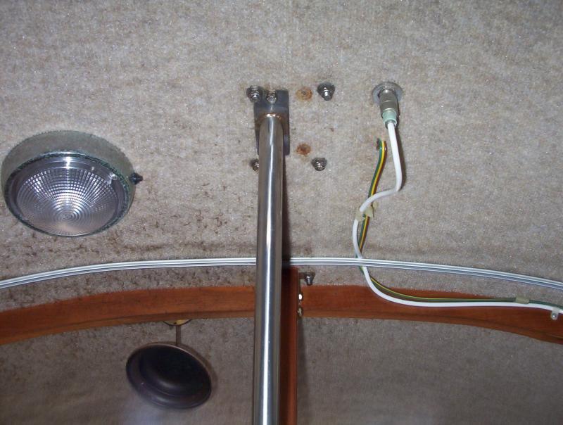

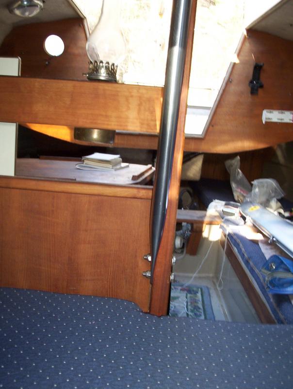

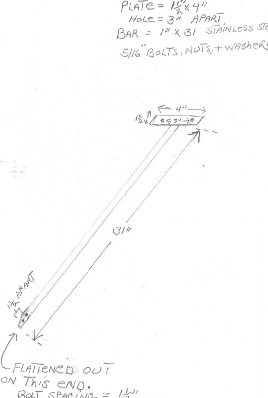

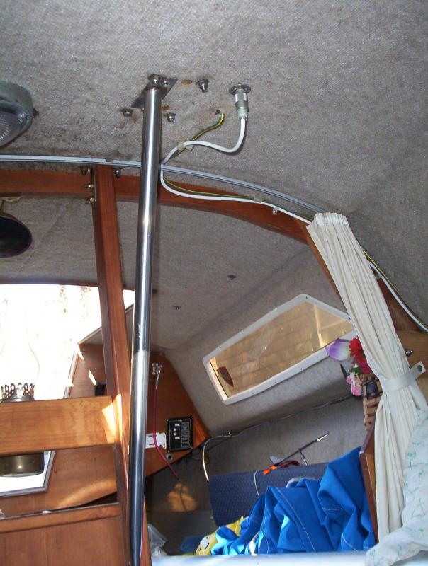

Most of the 1984 O'Day 222s came through the factory without a 1" stainless steel tension bar attached to the wood post of the galley cabinet to the bolts of the mast tabernacle. Does your boat have one of these? If not, I'll be glad to give you the info and sketch of it with all the dimensions. This tension strut is something that I feel that this boat really needs for extra mast support.

Also, I didn't have the tension bar on my 85 222 so I used Joe's plans and had my brother-in-law make one for me. Both of these are shown on one of my albums on this site (http://forums.oday.sailboatowners.com/album.php?albumid=2157). The tension bar reduces flexing on the cabin top, since the mast-step is not directly above the compression post in the cabin.
Thanks Trinkka, I am installing a compression post by the end of February, I hope. If you can e-mail me some photos or sketches that would be great. As for the OB I am interested in a 6hp Tohatsu 4 stroke, 25" long shaft, with an installed alternator. I don't know if you can mention prices on this site, but it is not overly expensive. I have seen quite a few used 8hp's on Craigslist, but none of them mention having an alternator. Like I said, any help or info I can get from you great people is appreciated. George
