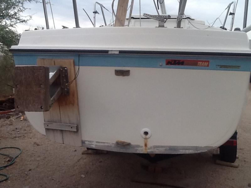

I'm shopping around for a used outboard for a Mac 25. From looking at the way the motor mount sits, it seems like a regular short shaft outboard would put the prop in plenty of water. Am I wrong? Should I only be considering long shafts? I'll only be using this in lakes and rivers.

Without a photo of your transom and the mount in its lowest position, yes, it's necessary. ;)

I too asked that question when I got my Mac25... everyone said yes you need to long or ex-long shaft... when you are motoring and you hit a wake it will pull your prop out of the water and over rev your motor and can do damage... with the long or ex-long shaft this will not happen or will just be a moment and now let your motor over rev and damage it...

As to the long shaft, while you may be able to set a standard shaft up to get the ventilation plate at the bottom of the hull, the power head is likely to be low, making it hard to work the tiller handle, and reach the choke, and so on. I would hold out for a long shaft, or even an extra long shaft and use an adjustable mount so you can tilt the engine and raise the mount to get the prop out of the water if using a dock or mooring. The extra long shaft is good for rough water, where the off-center OB has a greater tendency to come out of the water when pitching and rolling.

I have a long shaft and there are times when motoring in short chop that I really wish I had the XTRA long shaft. One to help keep the prop in the water and 2nd when I have to get at the power head I wouldn't have to dangle so far behind the boat.
