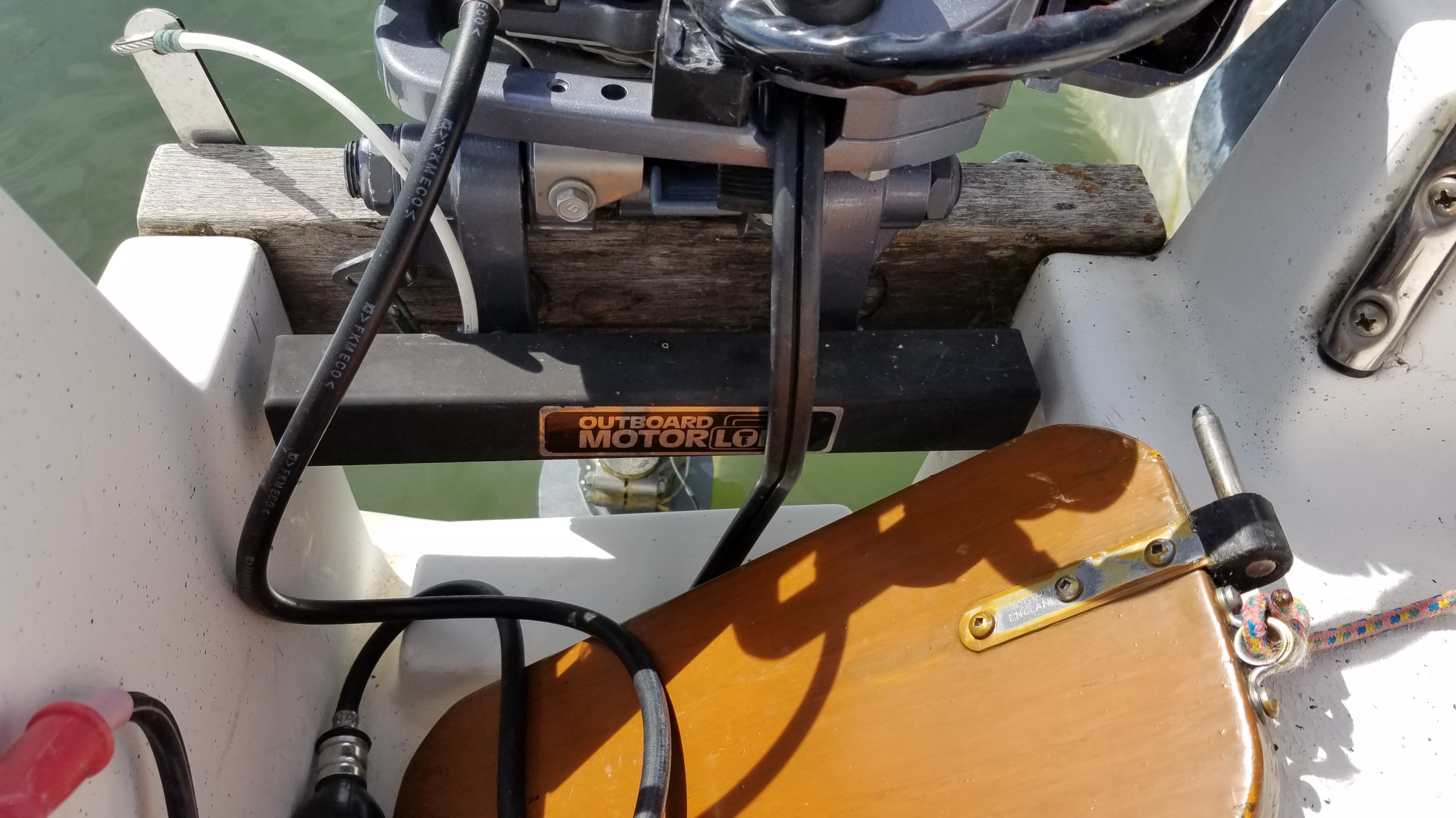

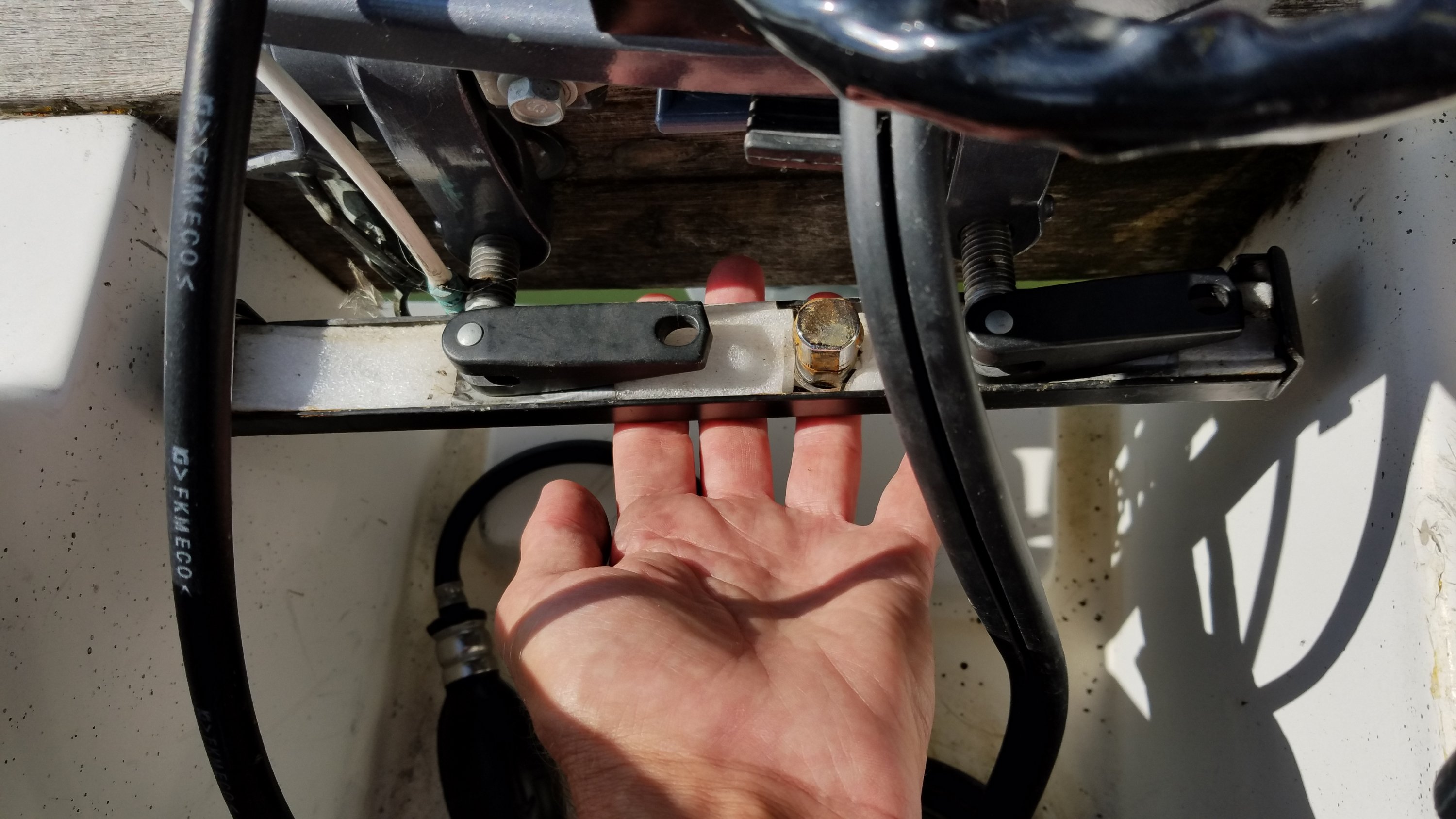

Rick & Karyon,
I've been using the square tube lock on my 1995 H23.5 for 15 seasons now. The trick on my boat was to point the two levers both towards the rudder rather than towards each other or in opposite directions. There's a narrow range of position for the outboard to sit to make it work, but it's pretty much centered in the well and allows the engine tiller/throttle arm free movement. I think I also added extra foam padding inside the tube so it doesn't rattle.
Rick, I've also been using your rudder lock design for almost as long. Thanks again! :)

For my H26, I use the Master Lock square tube bar. Because of the tight fit, it would only install upside down, with the lock's key hole facing up. After a year or so, the lock corroded enough that the key wouldn't open it. With a Dremel tool, a portable battery booster, and a cheap power inverter, I cut through the square bar in about 1 minute. Still, I bought another one just like it as a replacement. This time I I packed the keyhole with bearing grease. Like they say, if someone really wants to steal your outboard, they will. BrianW

Rick, how did you get that square tube to slide over the handles given the sides of the hull opening right up near the ends of the tube, even if they are both pointing toward the rudder?
Jun 2, 2004
649
Hunter 23.5 Calgary, Canada
My tube separates into 2 pieces top and bottom. just put the bottom half in place and snap the top part in place. Maybe there are different styles?
Jun 2, 2004
3,506
There are, I was really confused. The ones I have seen slide on from one side and I could not see anyway it would work. Where do those come from and who makes them?
Jun 2, 2004
649
Mine says "outboard motor lock by Fulton". I believe I got it at Canadian Tire 14 years ago.
