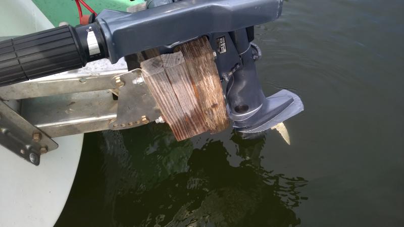

An additional item to consider. A Yamaha 2.5 HP has no reverse gear. You have to swivel the engine around backwards to go in reverse. This would be particularly difficult if you lowered the motor. It is, in fact way too small for your boat. I had one on a Compac 16 and it was ok but not for any larger displacement boat.
However, it is a very desirable motor for small sailboats, fishing boats, etc. It should be easy to sell or trade for an older 6 or 7.5 hp longshaft motor in good condition.

While a 2.5hp is not ideal for his boat and he knows it, he wants to make it do. It will get you in and out of harbor and will get you home if need be. I used a 4hp on a 26 when I first got it and it would push it to full hull speed. Just go ahead and do what you must do. Chief

In my opinion it would be a mistake to relocate or modify the motor mount to latter find out that a 2.5HP is grossly inadequate to power a 24' boa..t.
I agree completely if you are planning on dealing with any tidal currents at all. On an inland lake you can get to and from the dock but even there if you had to get home in high wind conditions you would struggle.
Our Mac has a 9.8 HP so we could get electric start and the extra long shaft. The extra long shaft allowed us to raise it for easier access to the controls and still be in the water the same as a long shaft. 90% of the time we didn't need the HP/thrust but a couple times in cuts in Florida I was real happy we had it. An 8 HP would of done well also but Tohatsu doesn't make it in the extra long shaft.
The 6 HP sailpro or one of the 4-5 HP long shaft models would work if one was careful getting in and out of tidal cuts but the 2 1/2 could get you into real trouble real fast if you aren't super careful. You should be able to find a decent 4-6 HP Tohatsu/Nissan for under $600 used and sell what you have to pay for a lot of it. We found a nice 5 HP Nissan on craigs list for $600 a few years back.

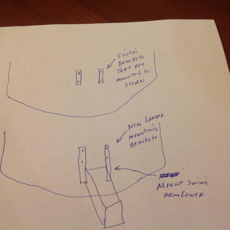

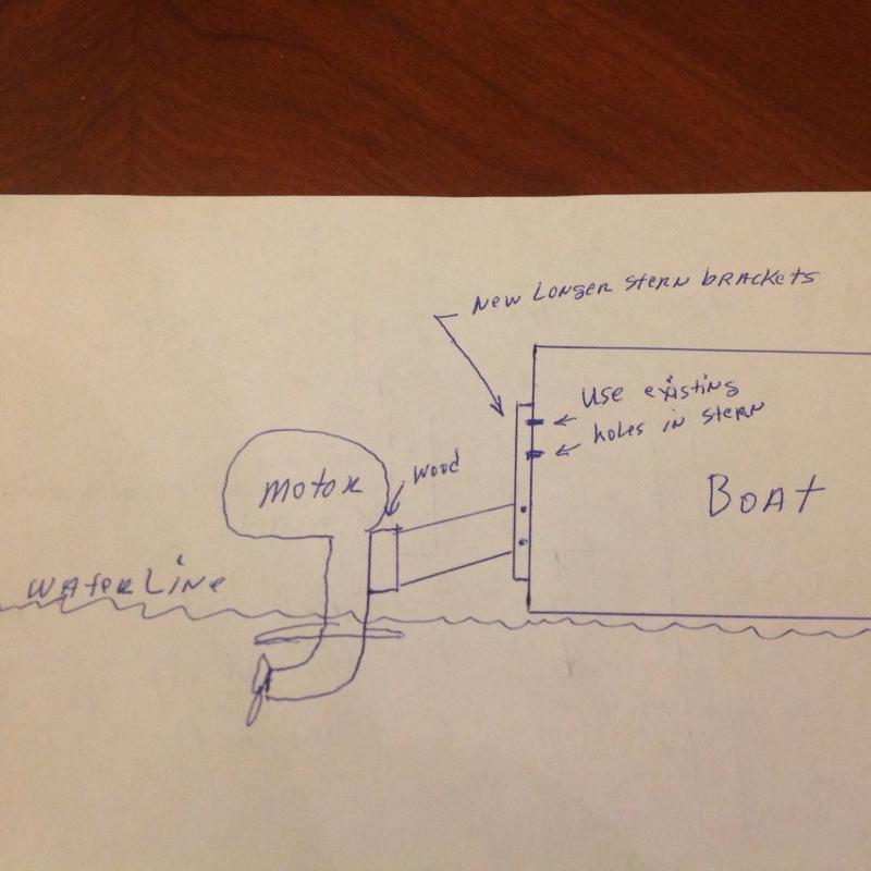

I'm just going to replace the motor if I can. Been looking online and have a few $200-350 options I can afford just need my car back from the shop to go check them out. Plan on getting all the info off my current motor and listing it on Craigslist and see where it goes.
I think I'll need to build a new wood mount though b/c the existing one just doesn't seem in very good shape.
