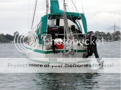

I did the opposite to my Vega which is now sadly sold :(. I converted it back to a diesel inboard. The PO(s) had sailed the boat from Sweden to Australia with the outboard.This link will show you the picture of the outboard and fuel tank location.
This outboard was a extra longshaft Suzuki 4 stroke 15 hp. It was installed without a backing and the flexing had damaged the fibreglass. If I were doing it I would put a 3/4" to 1" plywood backing and big washers to prevent this.
The shaft blog was sealed by simply jamming it with a wooden dowell matching the inner diameter of the log about 4" long and then laying a couple of patches of fibreglass over the opening from the outside. This seemed to hold up very well, and except for the fact that the stern bearing had been trimmed off with a saws-all, it made it very easy to remove when converting back to the inboard. I don't have a closeup of the original sealing, but here is a picture of the log shaft once the plug was removed and it was cleaned up ready for the new bearing housing to be attached:
I never used the outboard, so I can't report how it went. Logic would say closer to the centreline would be best, but the offset on this install apparently wasn't a problem.
