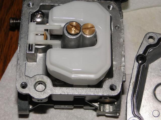

There are no screw adjustments for gas/air mixture. The picture shows the location of the two jets (under the brass colored screws). You have to remove the carb, take it apart, use a special screw driver to get the jets out, etc - ie, not a huge hassle - but certainly a significant one - especially to do twice - once before the trip and then once again after the trip.
