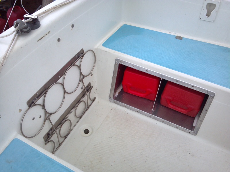

View attachment 131490 I really like this idea. I think this is a mod by Centerline.
Hey, thats my boat......
In my 21 andy 25 this space below the settee was unused and unaccessable, so i constructed an aluminum box, put a lip on it and cut a hole in the side of the footwell,and installed the box...
I made a sunbrella coverto snap over it so the tanks arent visable.
Also note my homeade folding fender holder... holds the fenders secure and ready when needed...

That is a good one. It would interfere with my stock flotation underneath however.
I doesnt interfere with the floatation.
Anyome who has removed the floatation to get into the area back there can testify that it isnt packed as solid as one would think... its filled with more smaller pieces back in there and the larger pieces put in last to either hold the small pieces in place.. or to make it look good.
But no matter the reason, when i did the mod NO floatation foam was removed, but only stacked better.
And rhere is actually a lot more room for foam if someone should want to add some as the space is only filled to the level of the settee with the coaming being empty.... with the tank well added and the foam stacked around it and up into the coamimg along the side and transom area, one can create enough extra space so that when the last blocks are added, they fit well under the cockpit sole, leaving a large accessable storage bin in an area that was once filled with foam.
Stacking the foam can be done below the vberth also... to create a large amount of storage for water, drinks, ect... after stacking the blocks, once you get the very last ones where they fit the best, use a little dab of spray foam at 2-3 strategic spots to lock them in place so they wont come dislodged and fall back into the space you just made...
