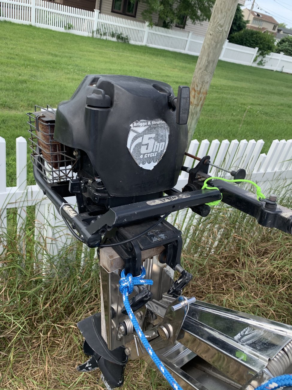

So my 192 came with an air cooled 4cycle 5hp outboard but I’m not too psyched about it. Since it’s air cooled there’s no cowling so the engine it totally exposed and fairly low to the water. It was previously used in fresh water lake but I’ll be in a choppy salt water bay. Plus, the new version says not for salt water use so I’m assuming this one isn’t either. So, I don’t think this is going to last too long for me.

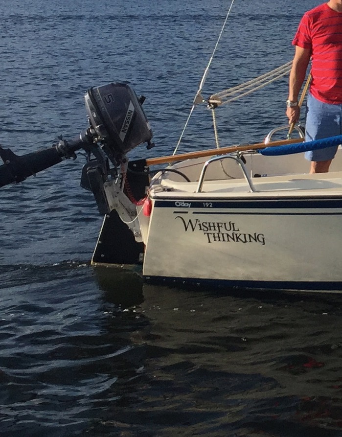

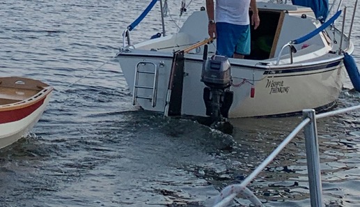

I use a 5 hp Nissan 4 stroke with mine. I've put the high thrust Tohatsu prop on it, to get the RPMs closer to operating range. I don't have to deal with current, but remember whether the hull sees 5 knots over ground, or 2 knots over ground against a 3 knot current, it's all the same as far as the limitations of hull speed. I've motored into some stronger winds, and that's where HP will get you somewhere, as long as you aren't bumping up to hull speed.
Given the difficulties small motors can have with oxidized ethanol and varnish in the carb, not to mention the possibility of aluminum corrosion if there's any salt water that gets into ethanol fuel, I would definitely get the propane Tohatsu unless you have a good source for ethanol free gas (I do have a source.)

What size shaft is your Nissan? I’m looking at the Tohatsu SailPro Propane that comes with either a 20” or 25” shaft.
I honestly have no idea how long it really is. It is probably the shorter of "long shaft"options, but not as long as the longest 25" on a SailPro. Provided you can lift the motor mount and tilt the motor (as I do on mine) I don't think anyone ever regretted having a longer shaft outboard on a sailboat. I'm lucky I don't have to deal with big, rolly waves, so I don't have problems with the prop coming out of the water, but for a boat that lives on bigger water, longer is probably better.

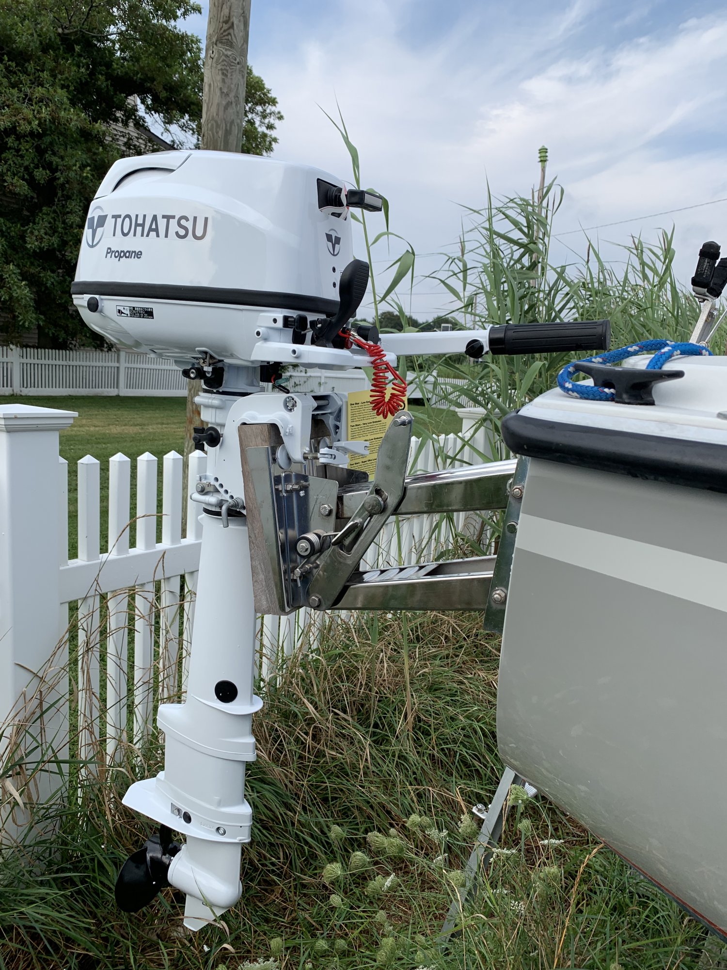

The Tohatsu 5hp SailPro Propane with a 25” shaft was the winner.
I’ve gone out twice with it so far and it’s been great. It starts up easily and is very quiet. Plus it’s got plenty of power, I haven’t needed more than quarter throttle even motoring straight into the wind. And because I barely use the throttle, it’s very efficient on propane use.
The Worthington 4.25lb Propane tank is a perfect fit in my gas locker and I can even easily fit another with room to spare. On that single tank I can run 4 hours at wide open throttle. Since I don’t even use more than 1/4 throttle, this will last me a long time, and it’s good that propane doesn’t go bad.
When I first mounted it on land I thought I made a mistake and the 25” shaft was too long. But in the end, it works perfectly in the chop and boat wake I have to deal with. It does drag in the water so I have to tweak my mount a bit over winter. Even with it dragging I was able to do 6kts in about 12kts of wind on starboard (as high as it goes) and 5kts on port. It may be a 1 knot difference but it doesn’t bother me. 5kts is enough to get me around the small bay fast enough.
I would definitely recommend going propane to anyone looking for an outboard. This one also has an alternator but I don’t have it hooked up yet since the pigtail is too short. I’ll have to make a new one over winter but for now the solar panel is working on the battery.

Congrats! It looks awesome too. I know you'll really like that 25" shaft. I don't know for myself but I've heard the propane engine's carburetor won't foul like a gas engine's will. So you'll not have to worry about that problem. Happy sailing!
