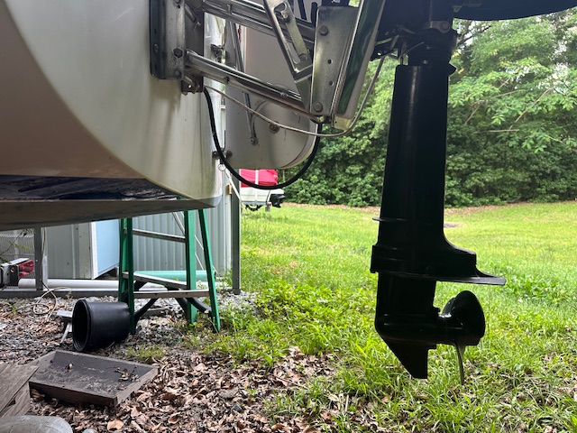

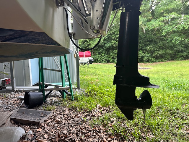

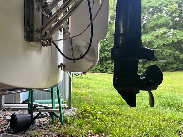

Reviving this for a moment. Finally have the boat on the trailer. The water rides about 1/2”- 1” above my bottom paint line in the stern. Shown pictures (above) has the motor in the top position of my 3 position mount. Cavitation plate looks to be about an inch below that but not the full hull due to its underbelly shape. Any issues u see here?
13,438
Yes, the prop will capitate because it needs to be in clean water. At the level you have the prop it will be in disturbed water. The motor needs to be completely lowered on the mount.
When sailing the motor should be tilted out of the water and the mount raised. Dragging the prop will add significant resistance and slow the boat.

Up position while trailering
Normal motoring position
Bottom position, only when it gets snotty, doesn't look much lower but it makes a big difference
