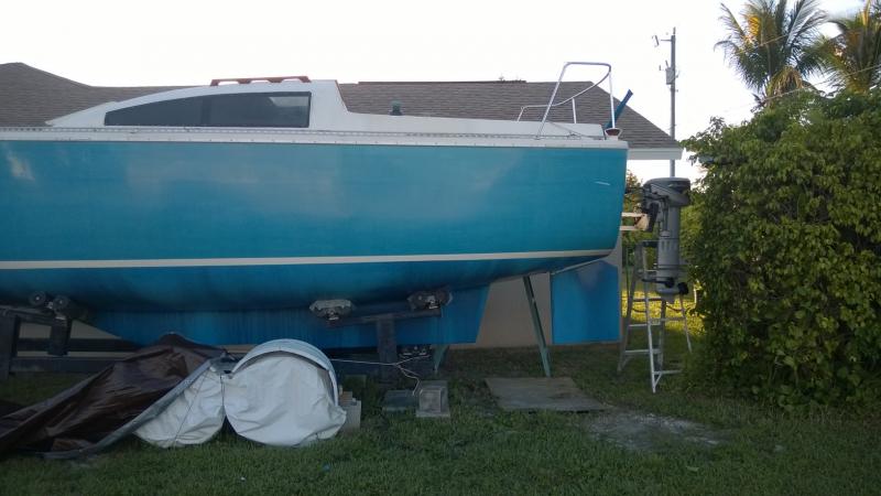

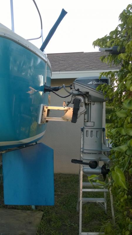

The saildrive was gone along with the fuel tank when i got my 8.0a. After doing a lot of research, and wieghing options i decided to go the out board route as well. I removed the saildrive mount ring and glassed the hole in from top and bottom. I also glassed in the old exhaust thru hull. I then reinforced the inside of of the transom with several layers of woven-roven. I bolted the motor bracket to 2 pieces of starboard on either side of the transom. on the outside I used 5200 to seal the starboard to the transom.
As for my outboard, its a 9.9 electric start Yachtwin with the extra long shaft. I got an incredible deal on it because it didn't have any spark. I fixed that quick with a new power pack, rebuilt the fuel pump, changed out the old water pump and changed the lower unit oil. Starts right up and purs like a kitten.
For the controls, i used the original saildrive control with new OMC shift and throttle cable. Also rigged up a choke cable all from the original control panel. In order for the controls to work I had to buy the OMC remote kit for the motor which was 100 bucks. Now, the only reason i should have to lean over the back is to prime the carb or raise lower the motor. I also installed a new 20 gal fuel tank and fuel filter/water strainer.
Please let me know if you have any questions or want to seem some more detailed pics.

Stillwater; I just created an album in my profile all about my outboard repower. Have a look.
CaGuy; I wanted to mention you can get a cable thru hull hood from west marine. I think i paid about 15 bucks for it. kinda neatens things up and helps keep the water out(I hope u don't mind me saying). There's a good close up of mine in my album. I really like the looks of that engine bracket. Never seen one like that. who makes that?

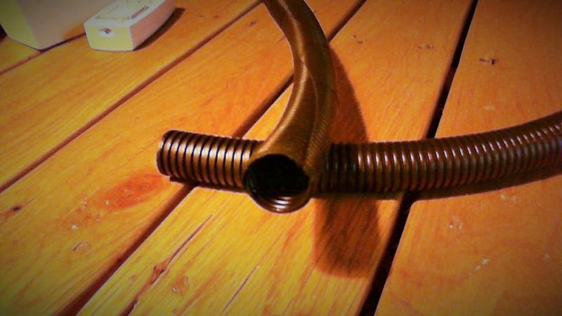

Nice job jlillie. I too have one of those boots just haven't installed it yet. I think I will bundle my wires into one of those plastic cable wrap encasements. I've seen some at the surplus yard that will work nicely.

Ok, I was just afraid you'd take offense at me mentioning about the boot. I ended up using a plastic spiral wrap from west marine which I really don't like much. They had these nifty wire covers made from nylon material with Velcro on one side but they were pricey and way to big for my small group of wires.
Raising the motor takes some muscle for sure, lowering of course not so much. All the way up or down the cables are ok though. The problem I still have is when I raise the motor all the way up the cables are ok but if I try and tilt the motor at that point I don't get much more play. I really do not want the lower unit sitting down in the water in the worst way. Also, not even sure how I could tilt the motor form the cock pit. How do you tilt yours up?

Not offended at all. You inspired me to pick up some tubing to clean up the wires. The stuff is pretty nice it is not a spiral but split. It was a buck/foot for he 1" and .55 for the 5/8".
