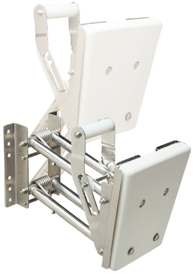

I've been looking at this one and really like it.
Garhauer emailed me yesterday and it's $200.00. It's not on their website. You can order it by calling
(909)985-9993
That looks like a nice bracket for the money. In fact, I think it's pretty similar to the one that my friend Wayne has on his Seaward 22.

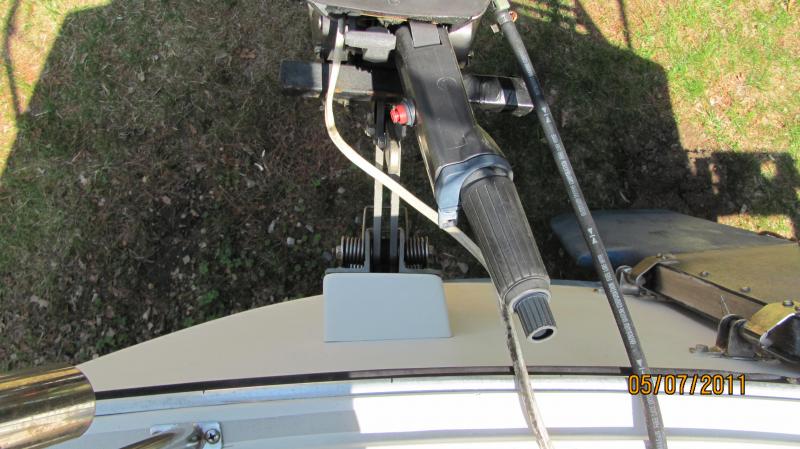

If your transom isn't perpendicular to the centerline of your boat, the angle of the block will will take care of it. You can view this by looking down over the stern from the cockpit. The outboard should be straight with it's own bracket and not at an angle to Starboard if the bracket is mounted on the Starboard side of the transom.

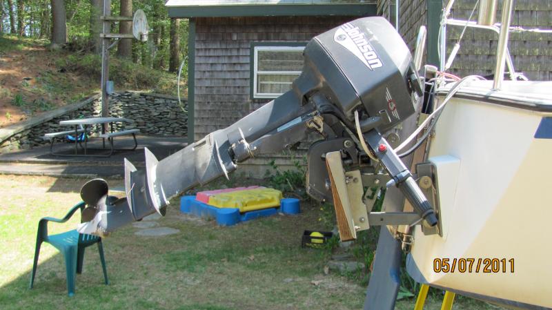

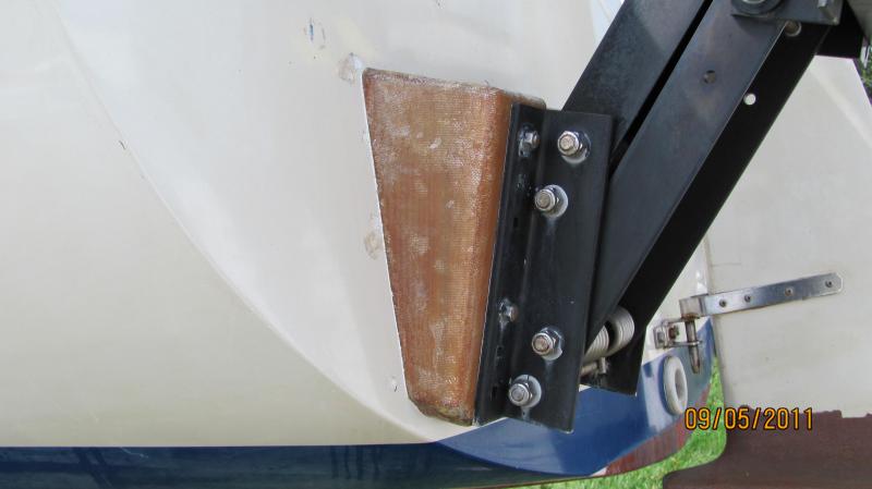

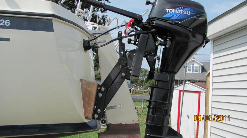

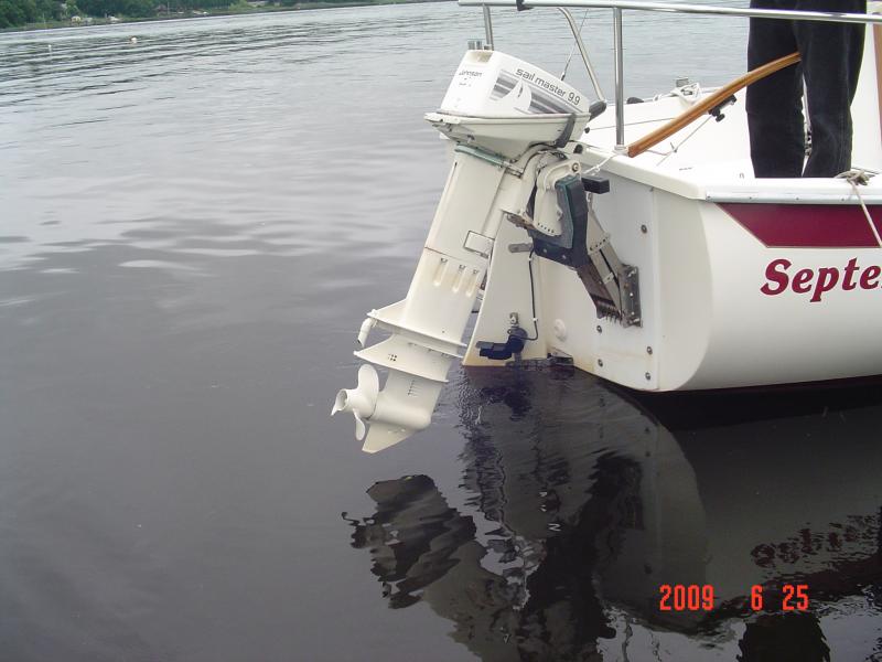

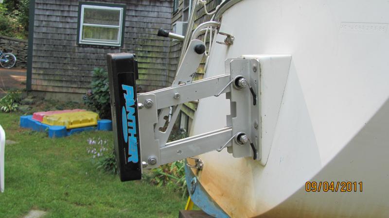

A picture is worth a thousand words so I'll post a few here to illustrate.
The first two pics is my old Fulton bracket. The third pic is a bracket that my friend Del gave me last year. It's a Panther. The holes all lined up when I mounted it. The next two pics are of Ray's O'Day 26. He made those two blocks out of thick pine and fiberglassed them. The last pic is Wayne's Seaward 22 with his old Johnson 9.9 two stroke. He now has a late model Tohatsu 9.4 hp four stroke mounted on this same bracket.
Like I said. I'm no expert on this subject but if I ever buy a heavy duty bracket for a four stroke, it's not going to be a $350 four stroke bracket. If I can get a decent heavy duty bracket for a couple of hundred, I'll buy it as long as it is rated to take the weight of my outboard. If I ever have to buy a four stroke 8 hp, I'm going to go with the Panther bracket pictured.
