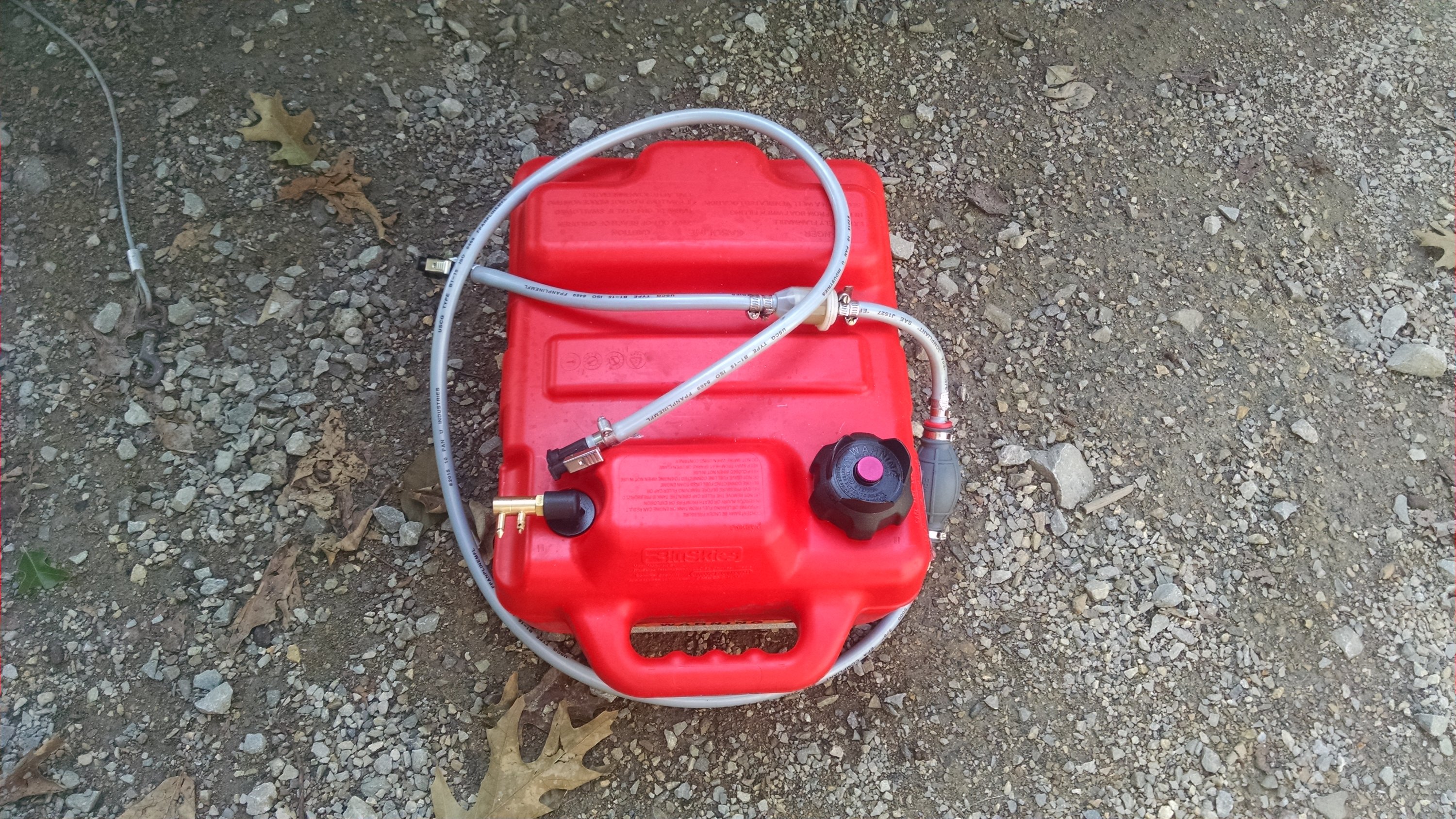

Had the same problem with a new Tohatsu. Ran fine at slow speed but bulb collapses at speed or when trying to restart. Solution was to open the tank cap and leave it open whenever outboard is in use.
