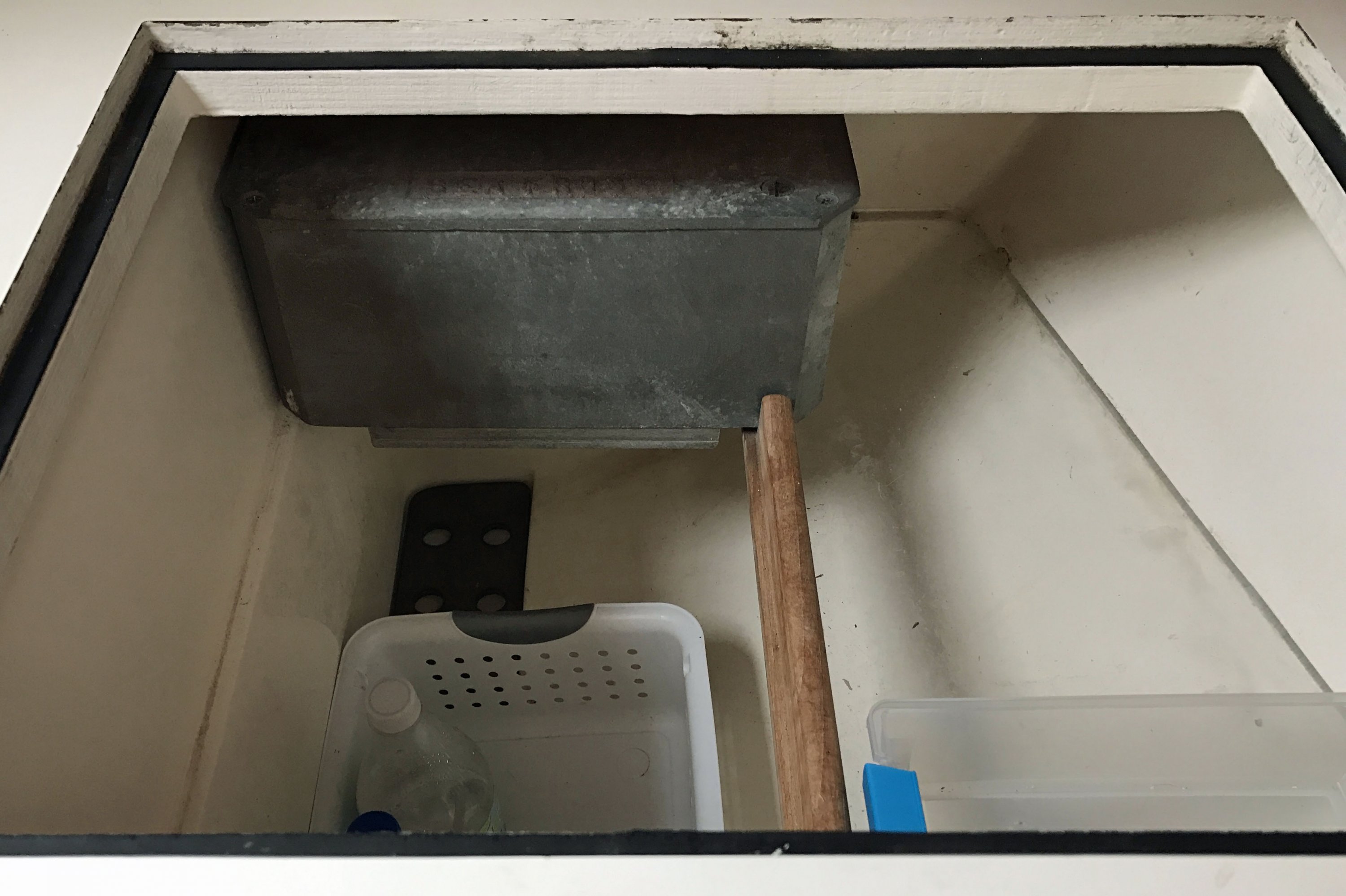

Larry, that's a lot of amps for a very tiny volume! I like Ron's Chesapeake experience better. Here's our box:
That gray thing is the holding plate, frozen by the conmpressor on the engine. A SeaFrost freezer bin is about the same size, so we'd have the same space, but the block would be a tiny freezer. Not big on iced drinks, but to keep steaks frozen; dare I dream of ice cream?
Not a lot of insulation under the top, but might be decent around the sides. Some measurements be worth it. Could easily add a slab of isocyanate foam under the top.
