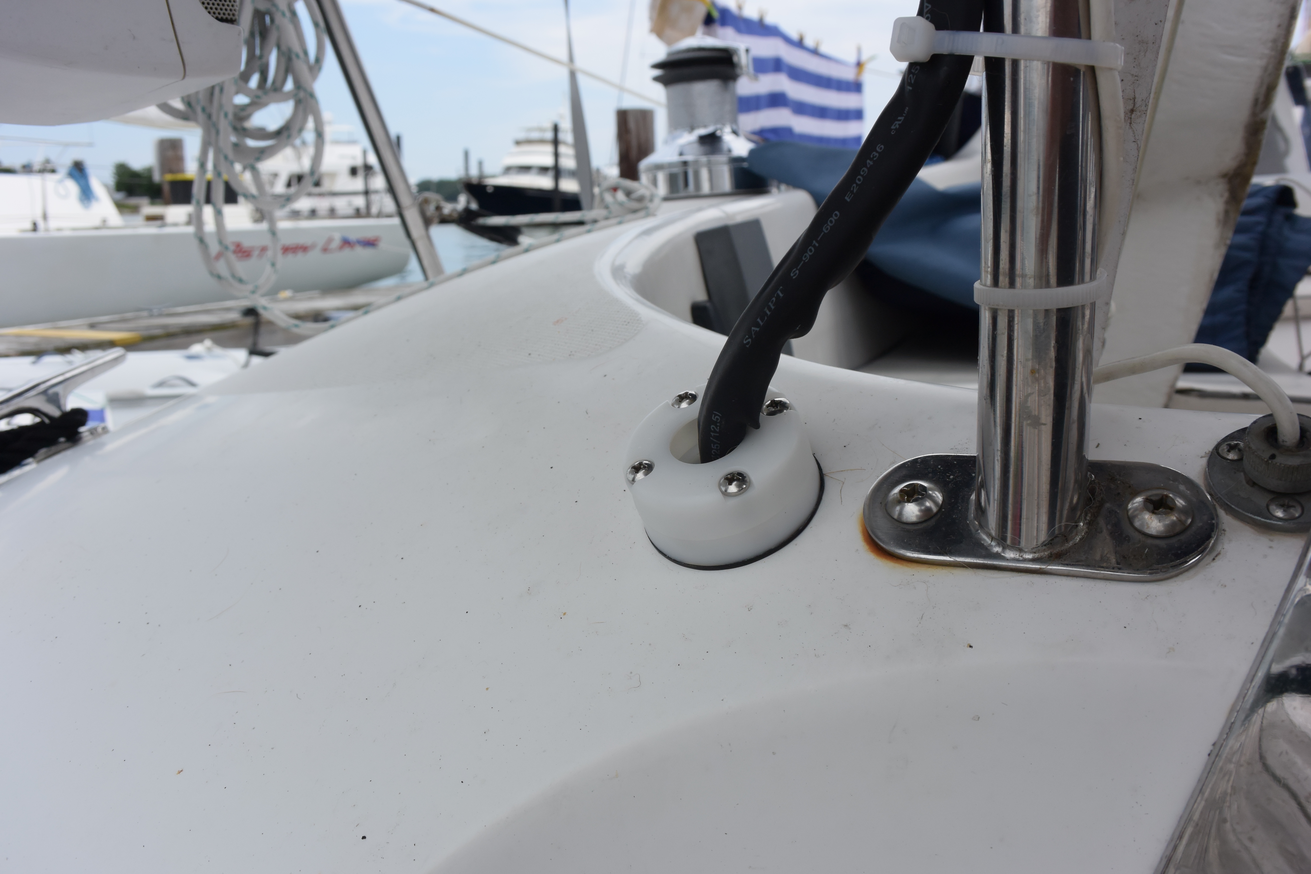

The wires pass through the hull using a Blue Sea Systems Cable Clamp. I didn’t put this hole far enough away from the stanchion. As a result I had to drill through the metal plate. Funny story about drilling this hole. I first drilled it too small for wire bundle. I had to run off to the local box store and get a 3/4-inch drill bit to allow me to redrill the hole larger. When I went to try and redrill the hole, the drill bit caught the edge of the existing hole and spun the drill out of my hand. It landed right in the water! I let out some of the loudest string of foul language most people had ever heard. I was rushing and the cost I paid was a practically brand new Makita 18 volt lithium-ion drill with a brand new $50 drill bit. Always tie of your tools when working over the water. When I ordered the new drill off of Amazon, I also got an interchangeable end tool lanyard. I now will not use my tools on deck without this.

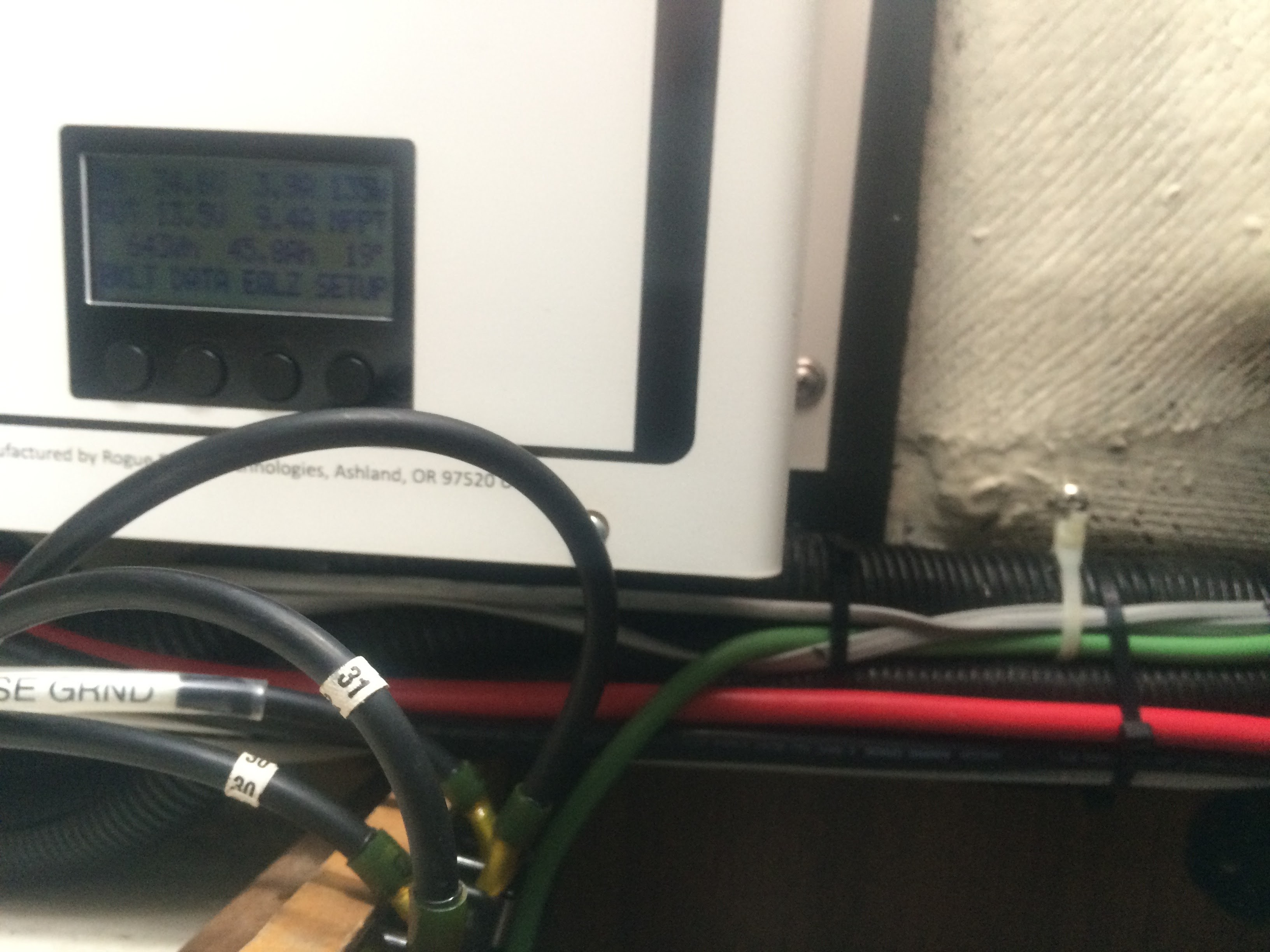

I installed the Rogue Controller next to the battery charger. I mounted it on a piece of starboard and through bolted the controller. The bolts are in the lazarette and easy to access.

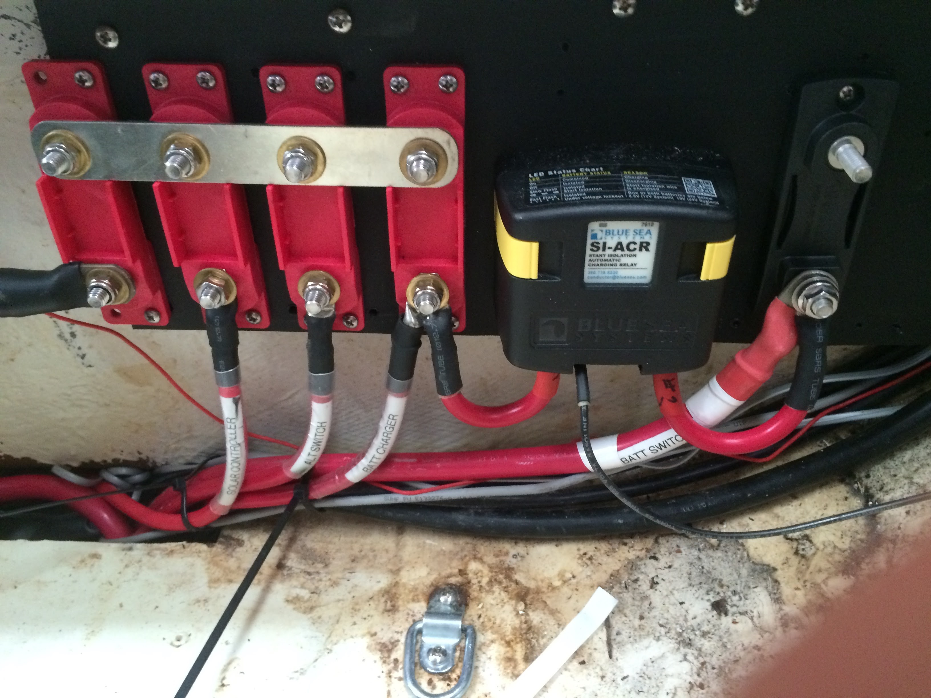

Down in the battery compartment I reconfigured my positive buss. Using a Marinco Pro Installer Link Joiner from Defender I created a positive buss that had inputs for the shore power charger, alternator, charge controller and the positive feed to the battery no. 1 spot on the battery selector switch. I then linked over to my Blue Sea Systems Automatic Charge Relay (ACR). The ACR brings charging juice only to the reserve battery. All of the different lines are protected by appropriately sized ANL fuses. All of the lines were labeled and then the labels were covered over with clear heat shrink following Maine Sail’s method.

By the time everything was installed, it was late in the day and I didn’t have very good sun to check the operation. But at 10 AM the next morning things were looking good. The panels were producing 34.6 volts of power at 3.9 amps and the controller was delivering 13.5 volts of power at 9.4 amps to the batteries.
