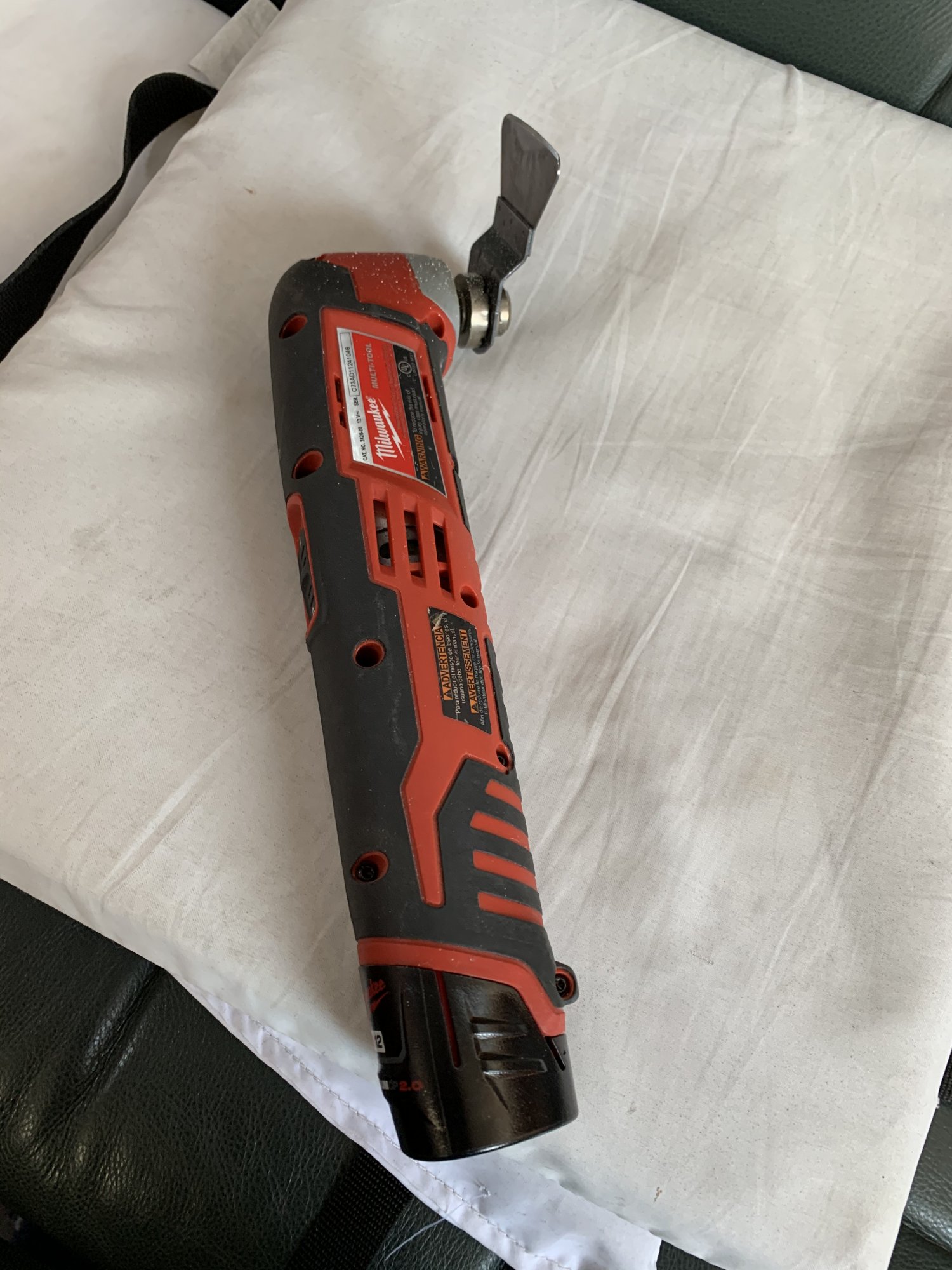

On my C400 I had to replace my rub rails, both sides, a total of 74 linear feet bedded with 5200. Until I learned to put a slight stretch between the rub rail and fiberglass and then insert the oscillating tool I made almost no progress. Once I learned to stretch (I used a wedge between the rail and the glass) I finished the boat in two hours. A great tool.

Wow! That's a lot of 5200 to deal with. It's equally impressive that you managed to get it done in two hours once you figured out the key. I'll definitely give it some light to medium tension as I use the oscillating tool
