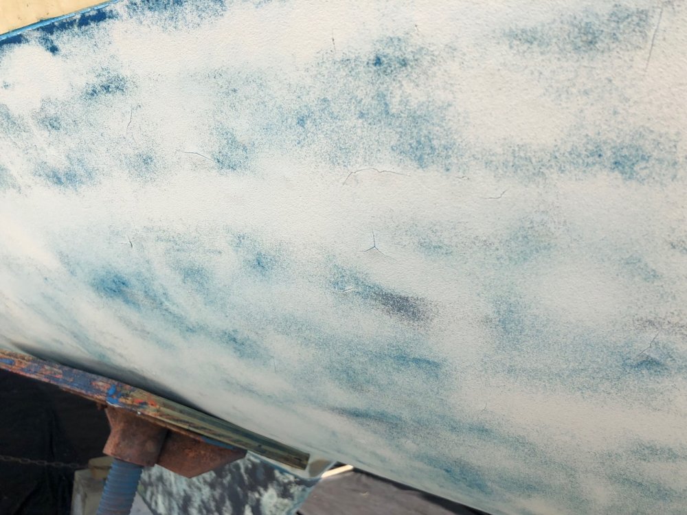

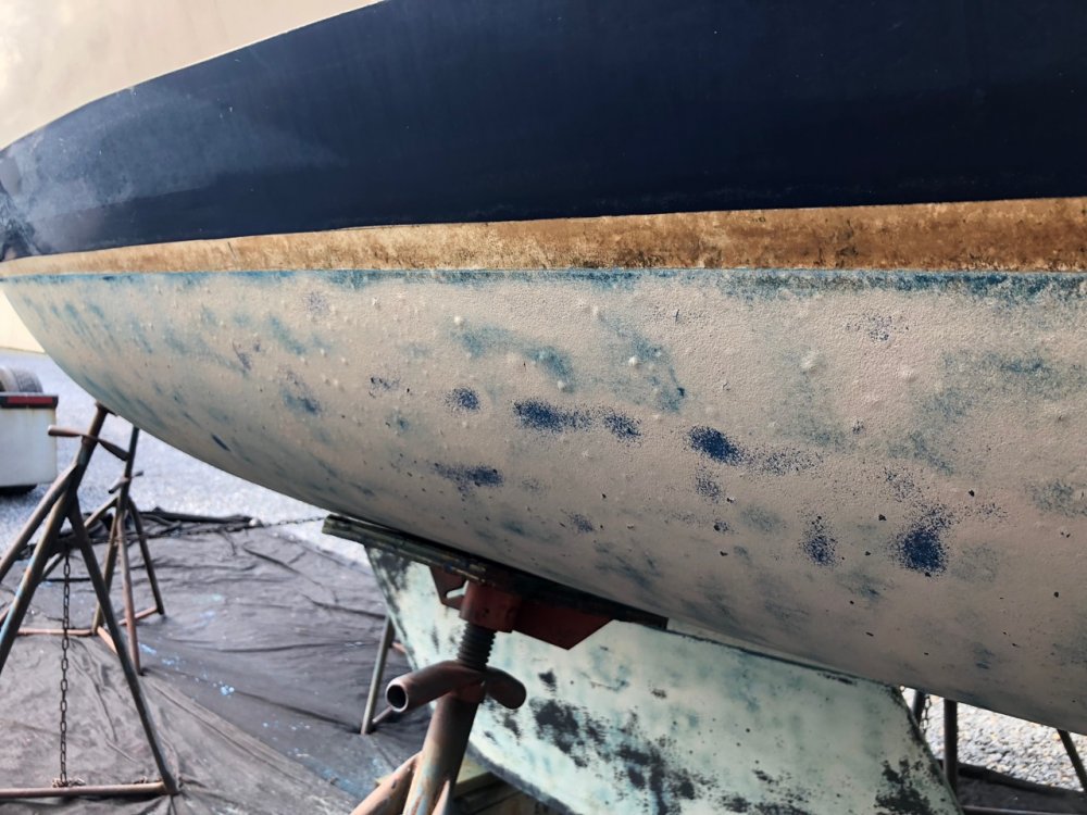

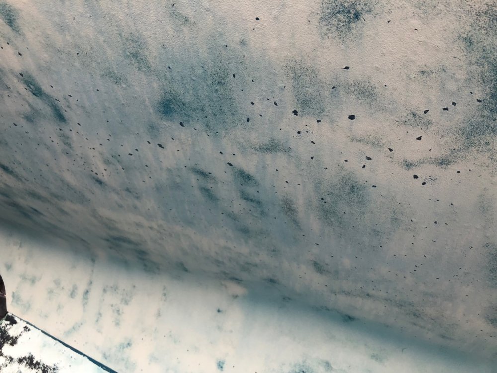

I have a 1984 O'Day 28 I purchased a few years ago after a survey. I've discovered many more challenges than the survey revealed. My $10,000 boat has cost me close to 4X that amount so far and I'm at another fork in the road with a big decision to make.
I had the boat soda blasted revealing thousands of blisters and cracks. According to my contractor (who was going to epoxy and bottom paint) the bottom is reading very high on the moisture meter. His recommendation is to peel off two layers from the bottom and then to build it back up with better fiberglass cloth and resin before applying epoxy, barrier coats and ablative paint. This is a $5,000 job on top of the cost of soda blasting that I've already paid for. He says it will make the bottom stronger and lighter. Others warn me that he is trying to sell me an unneeded peel job.
I realize making this investment is spending money I'll never come near recovering when I sell the boat. Of course I've already passed that point with my other repairs and improvements (new roller furler, traveler, rub-rails, toe rails, eyebrows, slider railers on the cabin top, stove, auto-helm, navigation GPS chartplotter, standing and running rigging, lights, cockpit rebuild as the core was rotting, VHF, forward hatch, tranny rebuild, replaced most motor parts, batteries, battery charger). We still have moisture readings in the topside of the bow area and cabin top but readings are not that high and there is no sagging. This is a problem still to solve. (I need to get my own meter, any tips on a good affordable one?)
We sail the Chesapeake Bay and plan for an ICW trip south to the gulf side of Florida then open water cut across the Gulf of Mexico to Apalachicola or Mobile Bay. We have a retirement home on the ICW off Mobile Bay with a boat lift. Our plan has been to stick with this boat though our retirement "go-go" years - the so-called last boat.
Still some friends and our surveyor advise against sinking another 5 grand into this boat. The option that reduces the cost seems to be to sand off more of the bumps and blisters, fill in the holes with fairing compound then apply epoxy layers, barrier coat and ablative paint. This also means letting the boat sit on the hard longer waiting for it to dry out more. It possibly/probably means no more sailing this year which could be my last year to sail the Chesapeake. Hiring the same guy to do this work will reduce the cost but I've not obtained his alternative cost estimate yet. I just retired so I have time to do this myself but am a complete rookie at this stuff and am challenged with caring for 2 puppies and have an hour and a half one-way drive across the DC metro area to get to the boat while dodging rush hour.
I'm looking for advice. Painter tells me the bottom is about to start coming apart in a couple years if not dealt with. (I'd hate to have a major bottom leak while cutting across the Gulf.) He says the boat was likely in the water a long time without chances on the hard to dry out. That was a new revelation to me as I recall my father's 1980 Newport 30 was always in the water and he did not suffer severe blisters after having the boat about 25 years. What is different though he bought that boat new and my boat was already 30 years old when I bought it.

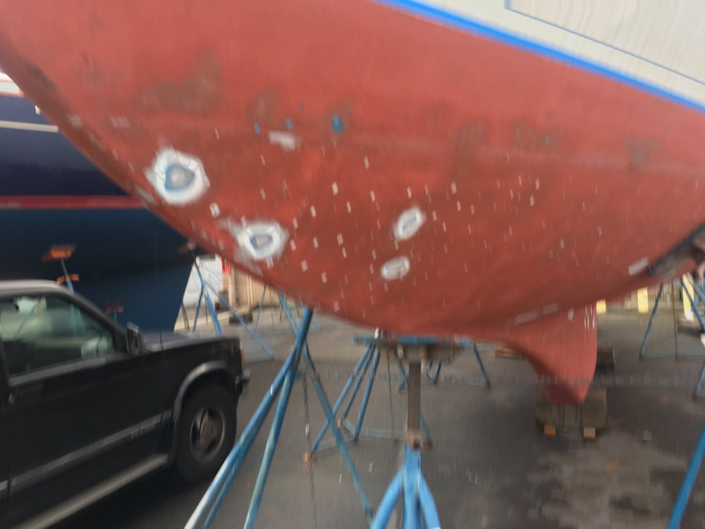

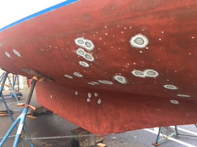

I feel your pain. It is a hard decision. A quick search for O’Day 28’s developed 6 boats with prices ranging from 9,500 to 16,500 in about the same year. Some of what you did to the boat electronics and engine work was deferred maintenance or up grades. The labor on a boat is part of the experience for some, for others a nightmare.
That said, do you labor on the hull or not would be based on if the boat is the one I love for the type of sailing you intend. There are some who are willing to shave the hull, let it dry, add new glass and epoxy, bottom paint and have a boat that will be there’s for 20 years. It is a delema. The other way is to let the boat dry, grind out the blisters as long as the blisters are not into the fiberglass mat, epoxy patch the big ones, seal the patches with a barrier coat, bottom paint and go sailing. I took the later approach this past winter. Took 3 months. Was it worth it? Time will tell.

When I pulled my boat, for the first time since buying it, the blisters were evident. They were in the gelcoat. The fiberglass layer was not involved. I chose the patch approach. Factors were depth of blisters, condition of hull, costs. There was another boat in the yard. It had been there for 2 months. The owner was in the middle of stripping the gelcoat to the fiberglass. Repairing the fiberglass then regelcoating the boat. 3 months later the boat was still in the yard.
