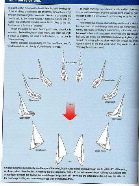

J,
Over the years, i've given lessons to new sailors to the sport.
One thing I give them right away is a page from Chapman Piloting. I print it and set in protective plastic so they can have it in the cockpit for reference.
It shows approximate sail shapes in a 360 degree layout. I let them know that this is just representative as all sail plans are different and performance varies. But this is good for starting out. Master this theory and everything else for sail trim is just fine-tuning. I have it attached........
C' ron
