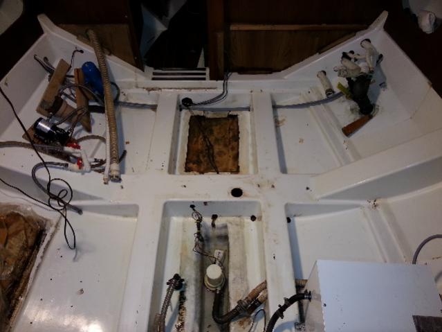

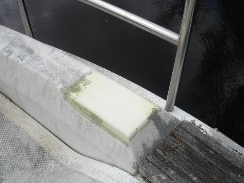

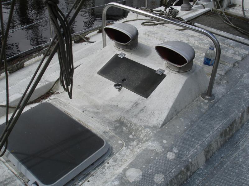

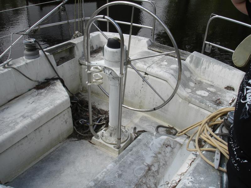

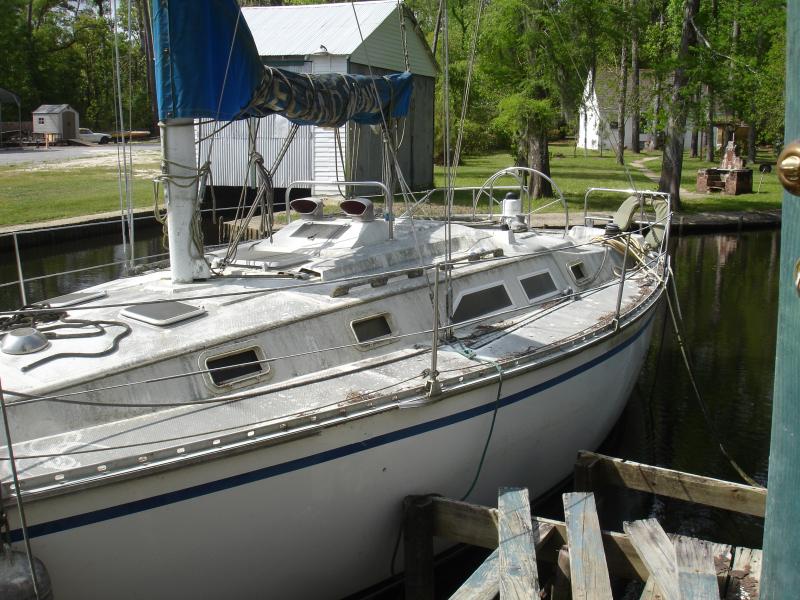

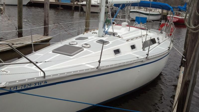

Once again Claude, thanks for the kind words, and yes it can be done. As most have stated time and money. We were lucky to have a friend let us keep the boat at his dock so we could make repairs and start the restoration. Once we got to a semi-completion stage we moved it closer to home. As you can see by the pictures it can be done and yes we are living on it 3-4 nights a week in (Mississippi) and return home (Louisiana) for weekends. I have a ton pictures before and after if interested.

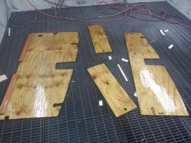

how well resin coated are the sub-floor structure and sole of this boat?
Pull out the sole if it has been submerged. They are not coated. You will be glad you did.
Then you coat your own.
