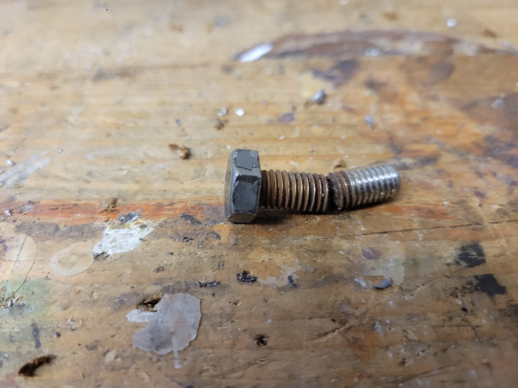

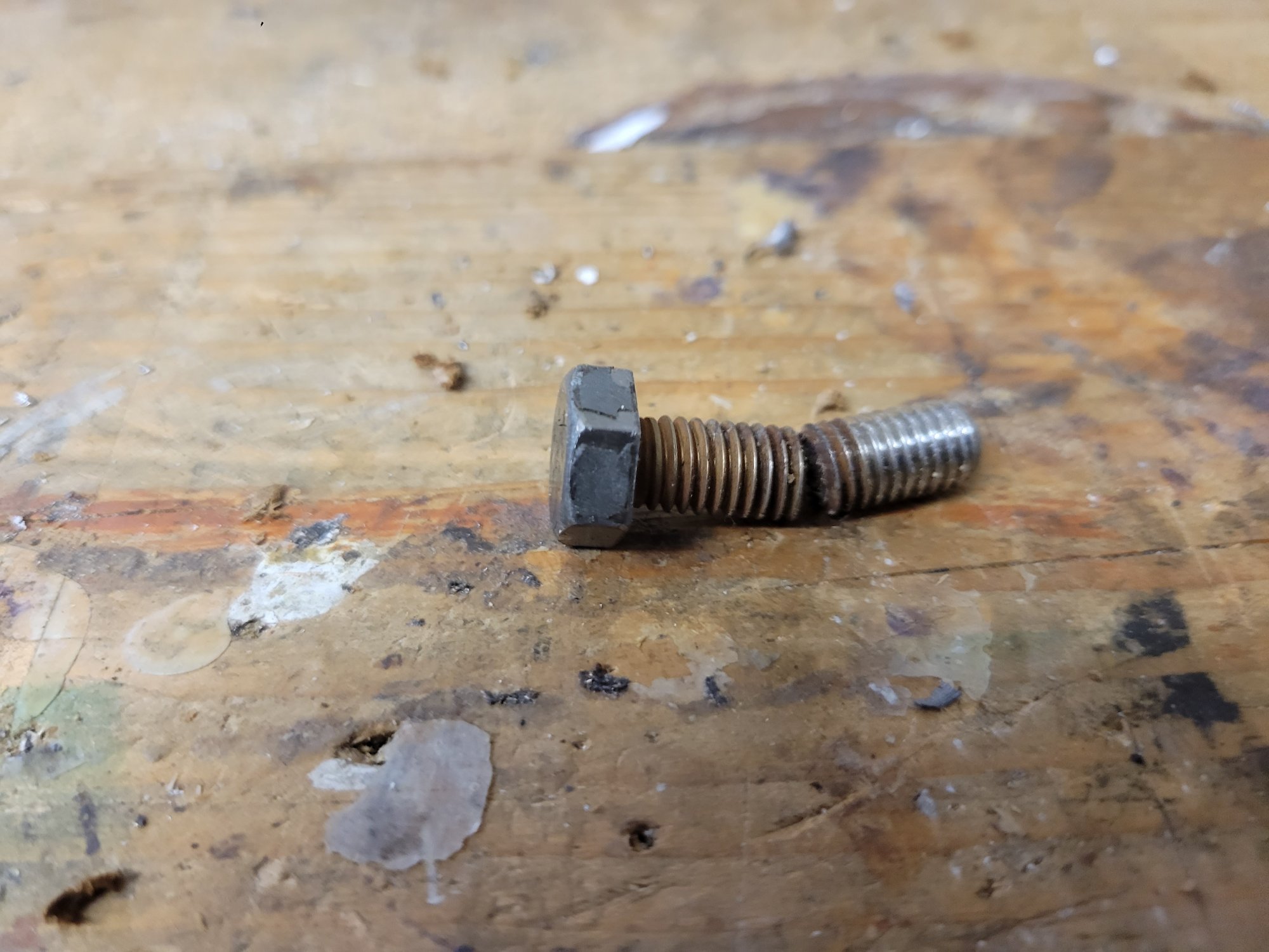

Some of us would like to see high resolution photos of the bolts that broke. I'd be guessing, but you may have had a gasket leak. Fix that and your stainless bolts won't deteriorate as quickly or nearly not at all. Don't fix it and your non-stainless bolts will not last long at all.
Alloy choice depends upon how often you'd like to change these out.

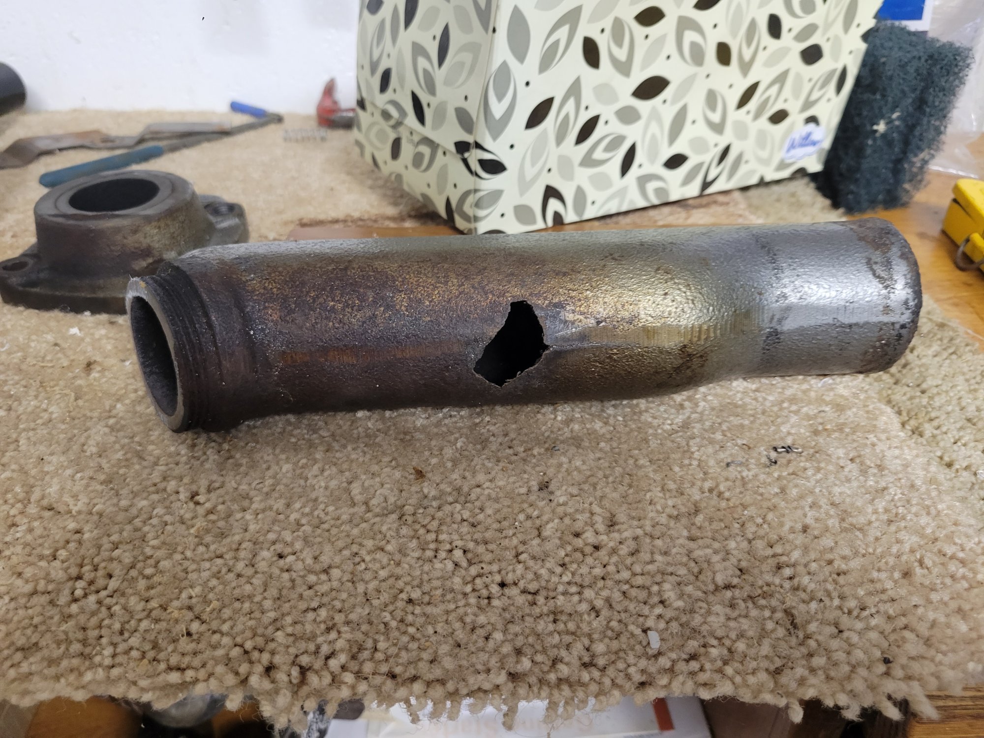

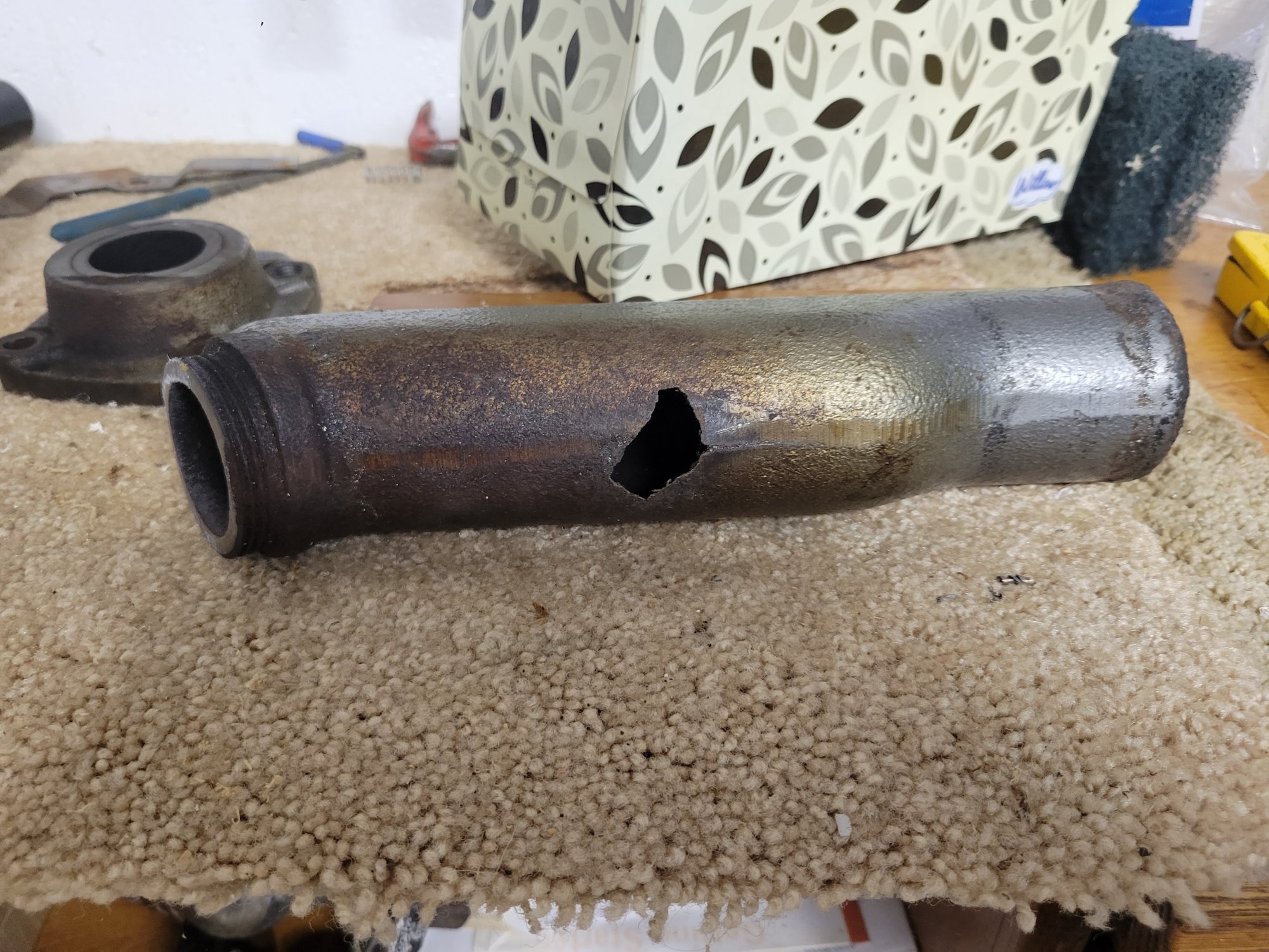

Here are requested photos. One is of the mixing elbow showing where it rusted through. The other is the compromised bolt. The second bolt broke off in the manifold. Being stainless, it was a real challenge getting it out. I think that there must have been a leak at the flange. All the old bolts showed some corrosion. It is, as far as I know, a fresh water boat.

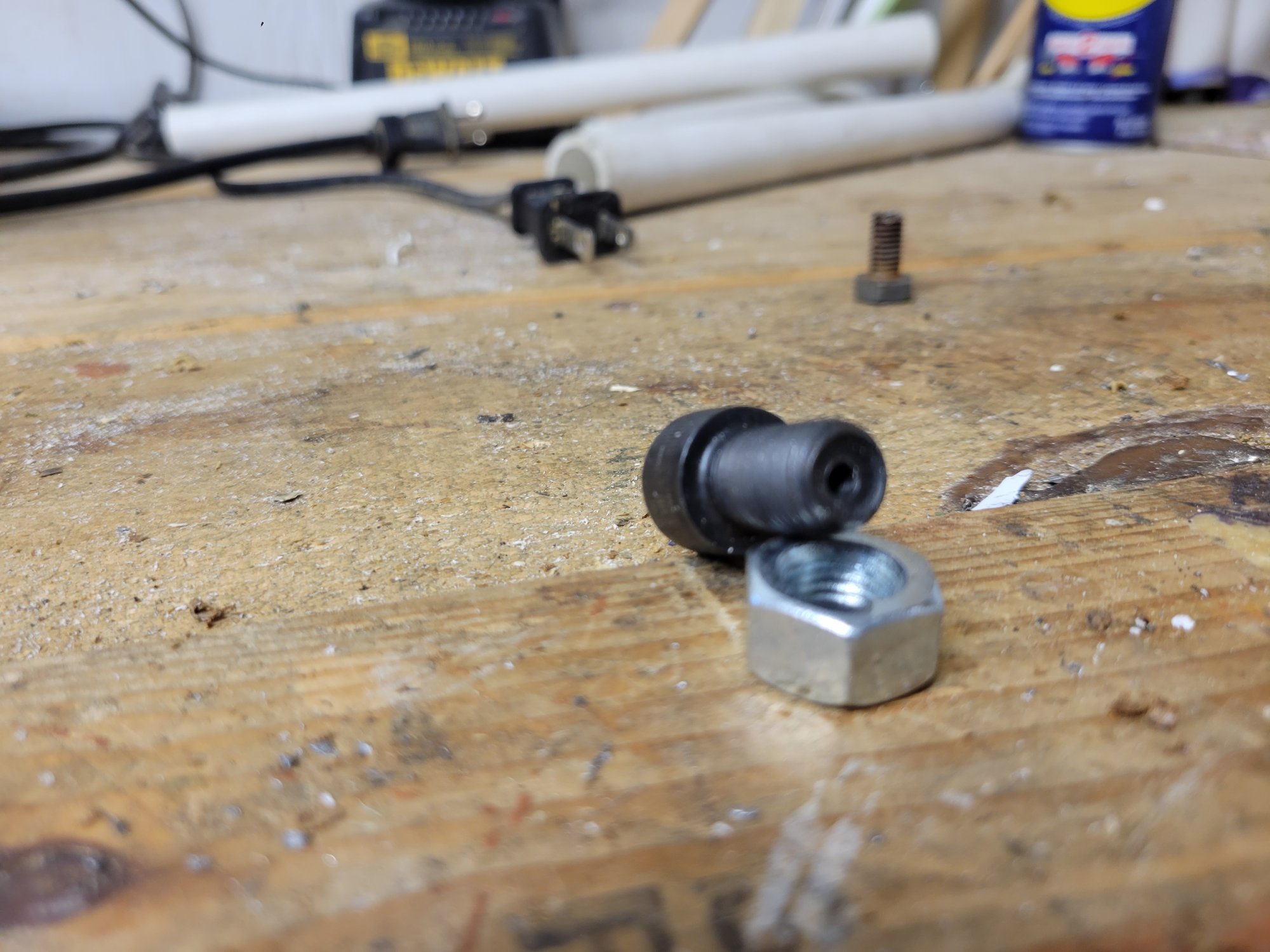

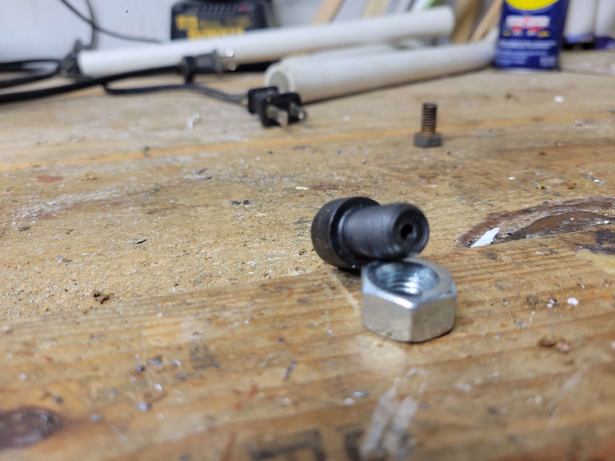

The broken bolt posed a real challenge as it did not break off cleanly. I needed to drill it out for an easy-out, but there was no flat surface where I could start without the drill bit sliding around and damaging the threads in the manifold. Thank God for YouTube where I got the idea how to get around that problem. I tapped out the one hole in the old flange to 5/16 and hollowed out the center of a 5/16 hex bolt to act as a guide for the drill bit. (see photo). I put the old flange back on and ran the hex bolt so it was as flush to the hole in the manifold as possible. It allowed me to get a hole started, but it was slow going drilling out the stainless bit even using titanium drill bits.
I see something else on your first picture and has nothing to do with BOLTS.
The Exhaust Tube looks Over Heated.
That suggests not enough Quenching Water or poor quenching.
Very hot conditions will separate your bolting flange, cause a leak, and corrode you bolts.
:plus:
That elbow did not RUST through.
