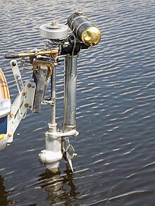

How about upgrading to a.........

Yep, DJ
the dreaded Seagull.
They are certainly not heavy, just as they are certainly not RELIABLE.
There are some Youtubes on the (many) upgrades that can make them easier to live with .
But as one who has owned one. Buyer BEWARE!!!
I guess the best word to describe a Seagull is Funky.

I know them well. I used one for years many years ago. Reliability increases with the technical ability to fix it on the spot. I think they only have something like two moving parts, or something like that. Funky could be a word. Finicky could be another. Downright frustrating also come to mind although the one I had was one of the better ones... I wasn't always working on getting it to run... They also leaked gasoline as I recall, if they weren't perfectly upright...
So - not yours, just a random image?
dj
May 29, 2018
629
Canel 25 foot Shiogama, japan
Not mine Dj.
Mine died in Singapore where I bought a 4 HP Japanese engine that lasted 35 years with no maintenance at all.
Leak gas. Yep almost every time you moved the thing.
It was the fouling plugs ( a unique type if I remember) and the exposure of the plug cap to the weather.
Nothing as basic as an engine cover for Seagull!!
Oh and no neutral. That was fun.
gary

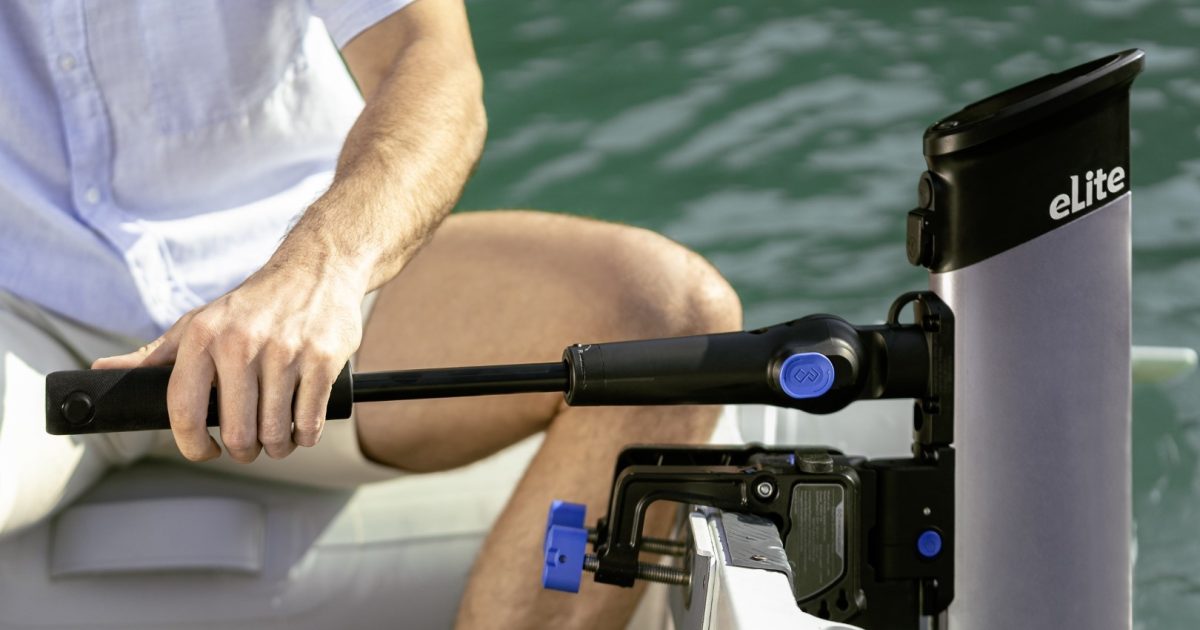

I just ordered one of these:
I'm afraid it won't push the Don's dinghy. I'm replacing a 2.5 HP Lehr propane outboard, which will be for sale this spring. That won't move the Don's dinghy either, so I've got nothing for you. Mine is an 8' Portabote. The Elite should actually do fine for that. I do know that Honda makes a pretty reliable outboard, though.
I had to contend with one of those on my dad's Dragon for several years. I may be a bit of a masochist, but I kind of enjoyed the challenge of trying to keep it running. Sometimes I won, sometimes the Seagull did. Fortunately it isn't hard to paddle a Dragon.
