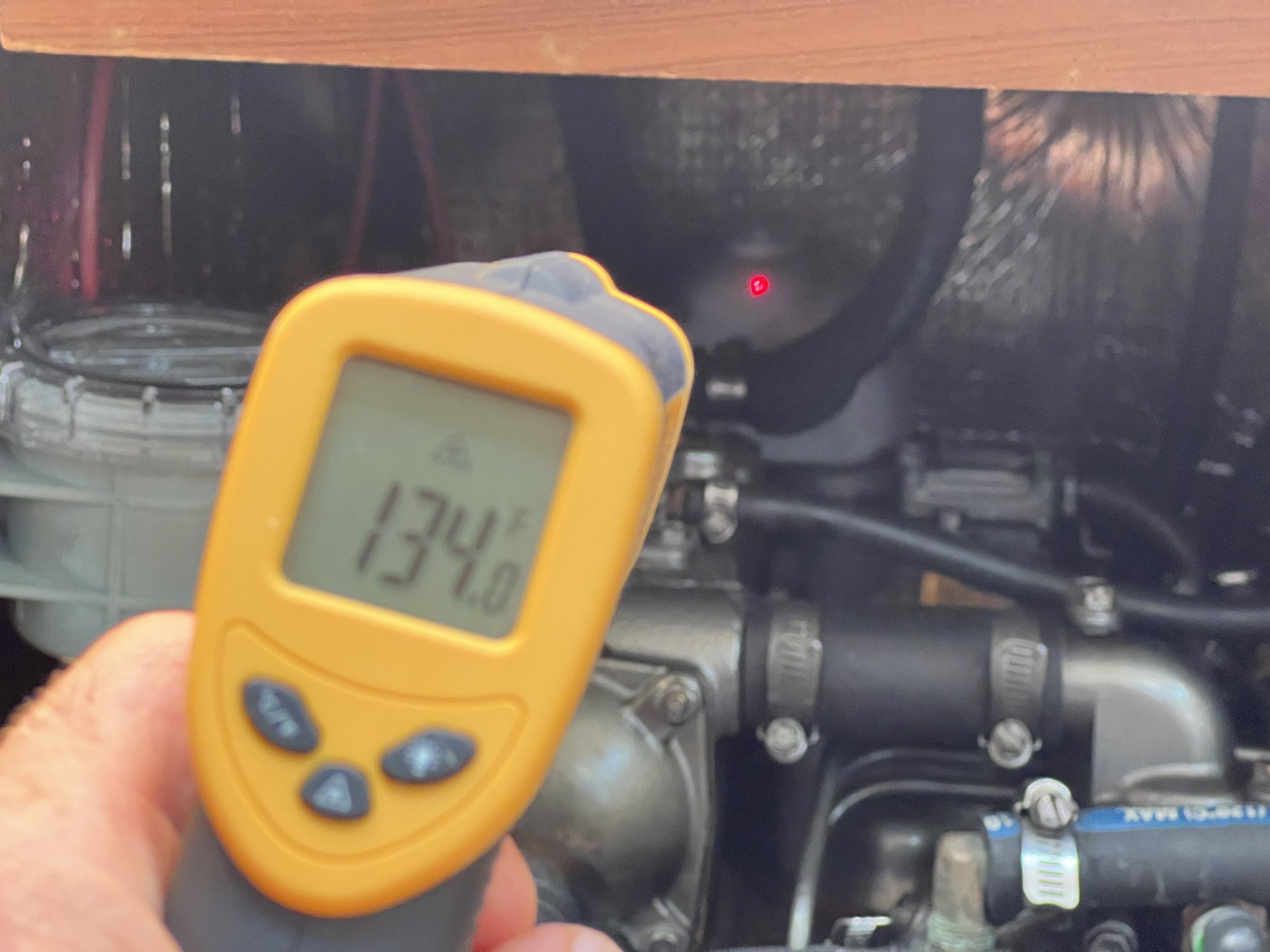

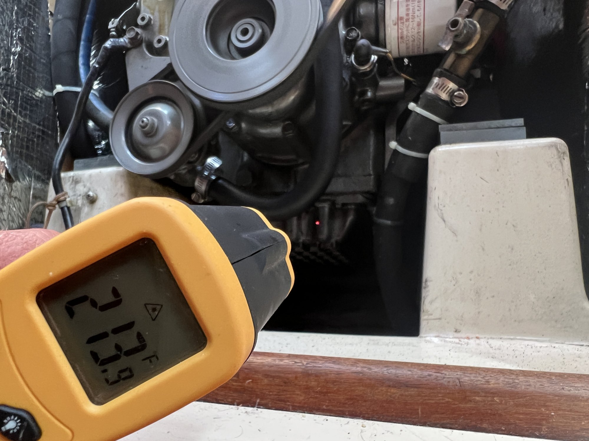

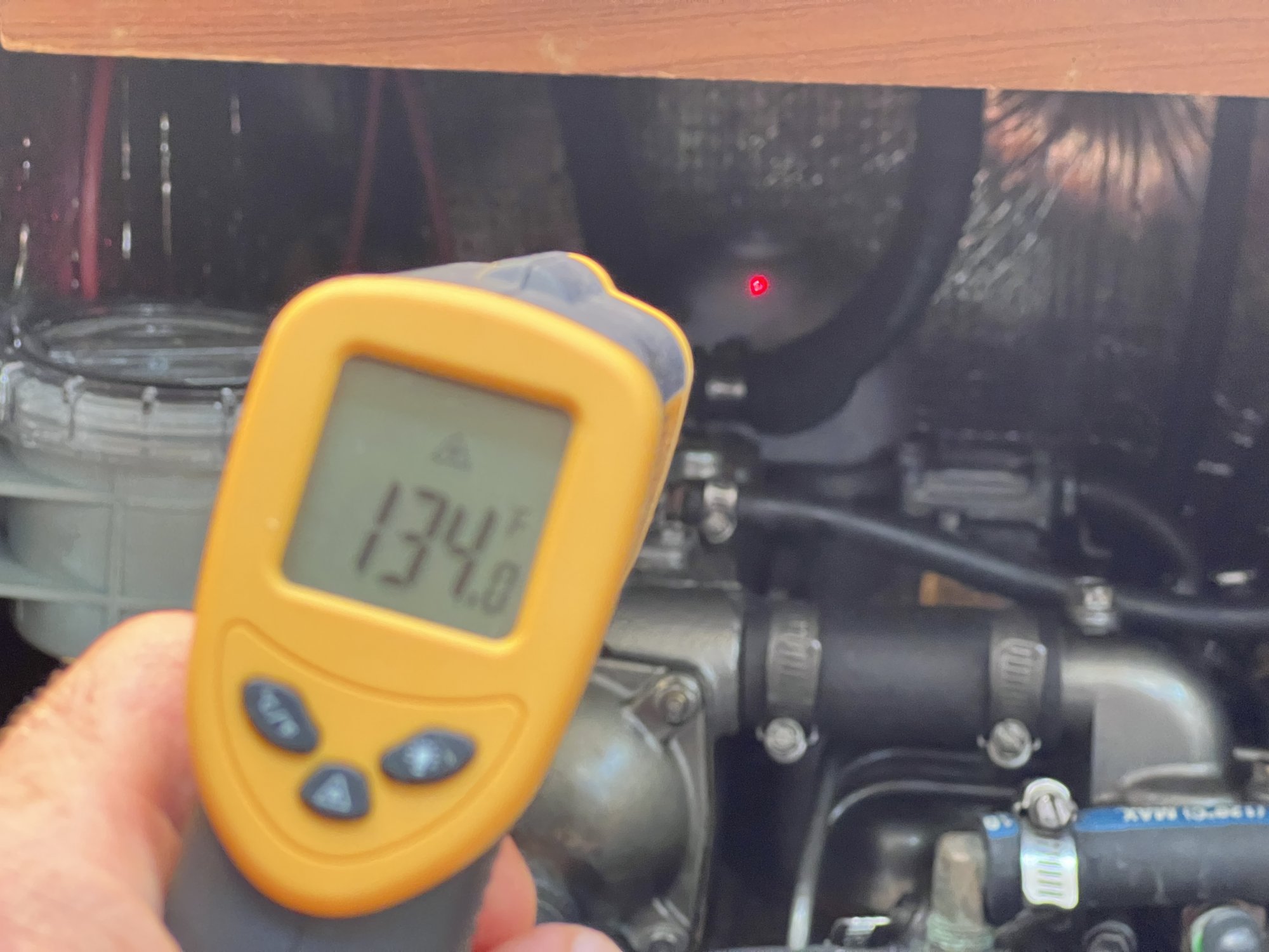

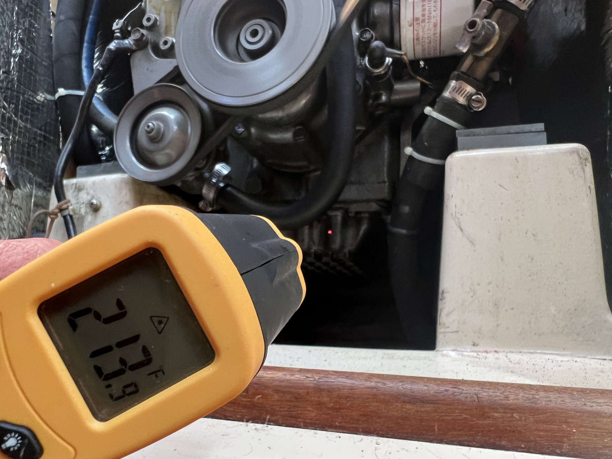

I took multiple readings of temp on my engine, and they ranged from 134 to 214. I’ve read these engines should be operating <180.
Am I taking these readings correctly? Are they within range? I took one at the sensor (169), one at the oil pan (214), and one at the mixing elbow (134).

The reading you took at the temperature sensor is appropriate, the others are not. If your engine was just idling then that may explain the lower than expected results. Your engine thermostat regulates the engine coolant temperature so as to not exceed its setting. The coolant will travel through a by pass pipe until the thermostat comes into play. Try taking another reading at the sensor (as above) or at the thermostat housing when the engine is being worked harder, say, pushing the boat at hull speed for a while. Should that result still appear lower than the thermostat setting value, then you could remove the thermostat and test it in a pot of heated water to see when it opens. At idle, particularly with a water heater, your engine may never reach full operating temperature.

I have the same engine and my temp gauge never goes above 165 under load. There was an explanation that I can't remember exactly - something about the sensor not being located in the optimal location, I think. Previous owner explained that with an infrared thermometer he consistently measured 180 at the thermostat housing (or the heat exchanger outlet - I don't recall exactly). As long as I read 160-165 on my gauge, I never worry about it. The temp at the oil pan has no relevance (I think) and it's definitely going to be lower at the mixing elbow.

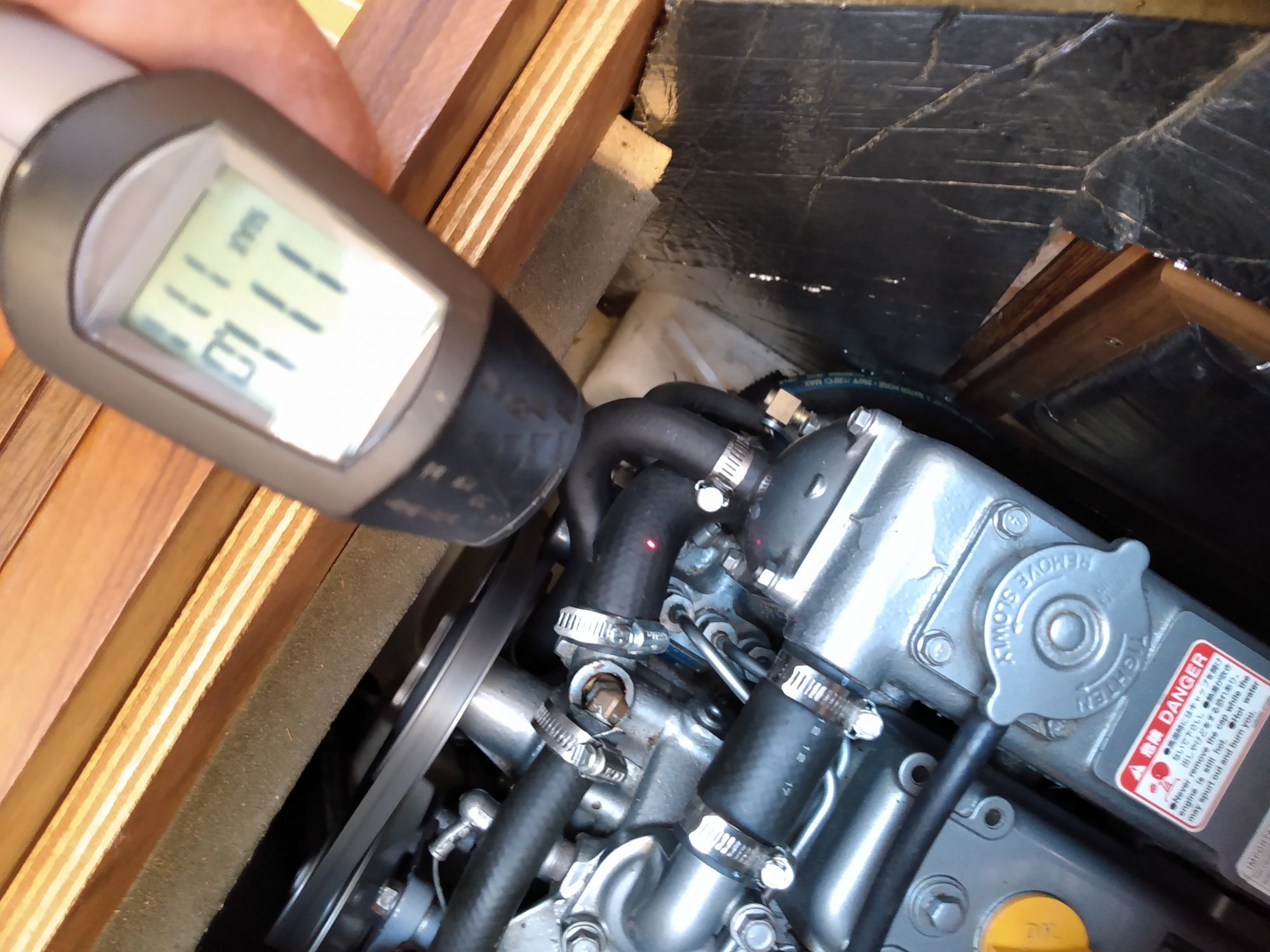

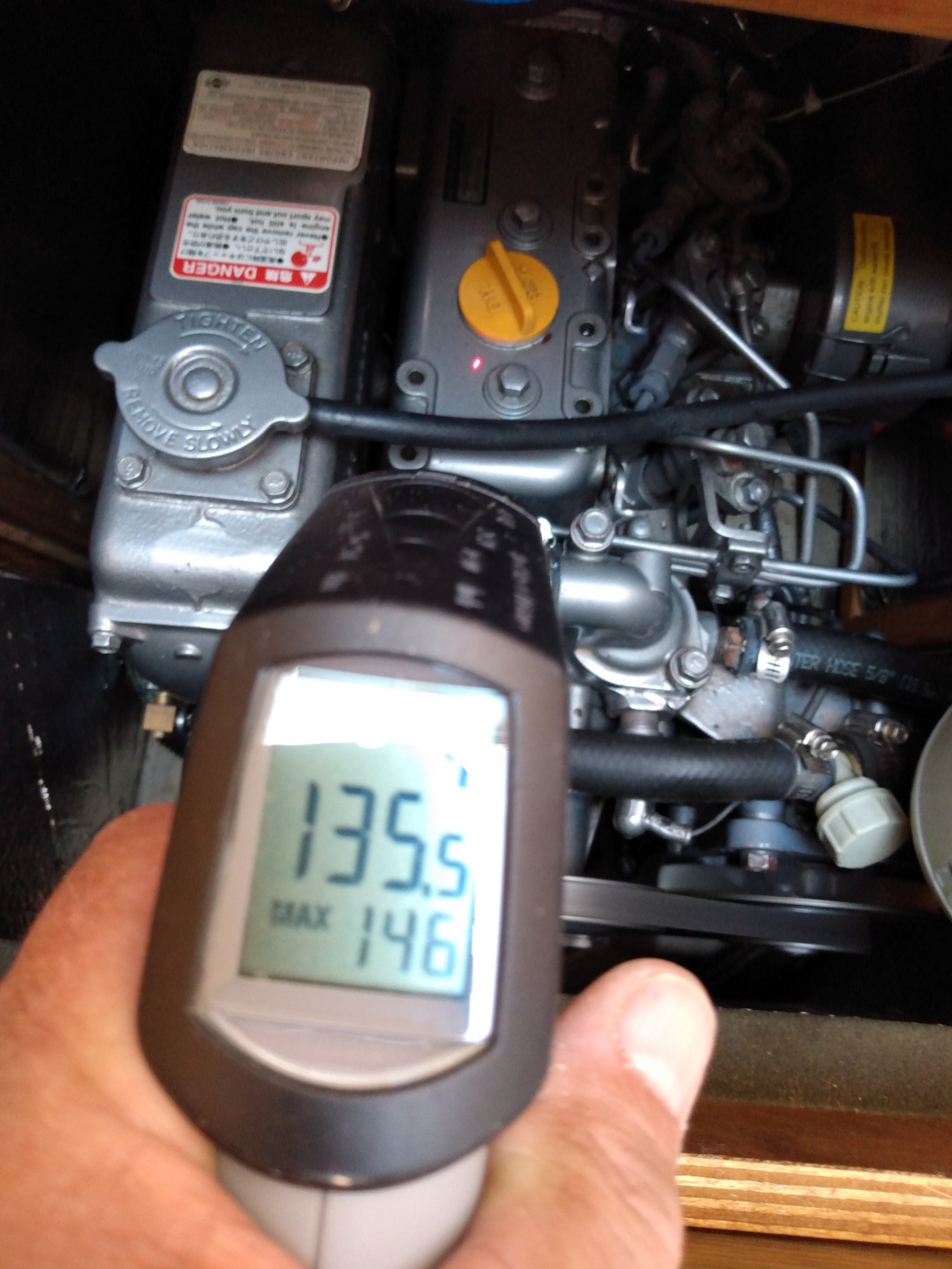

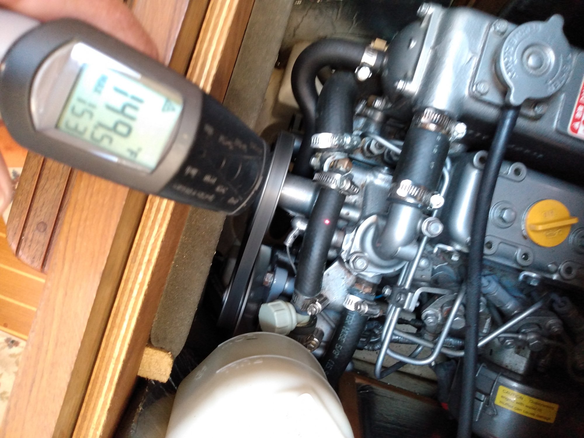

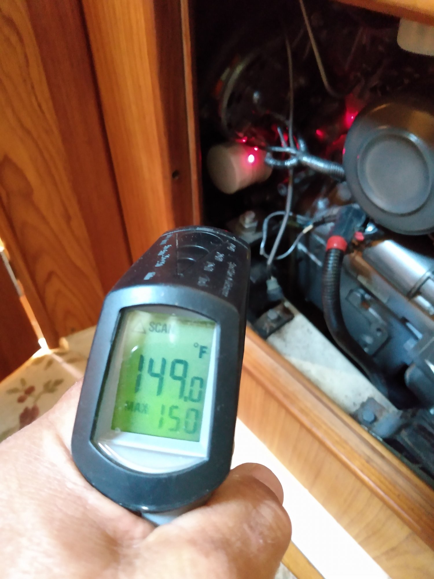

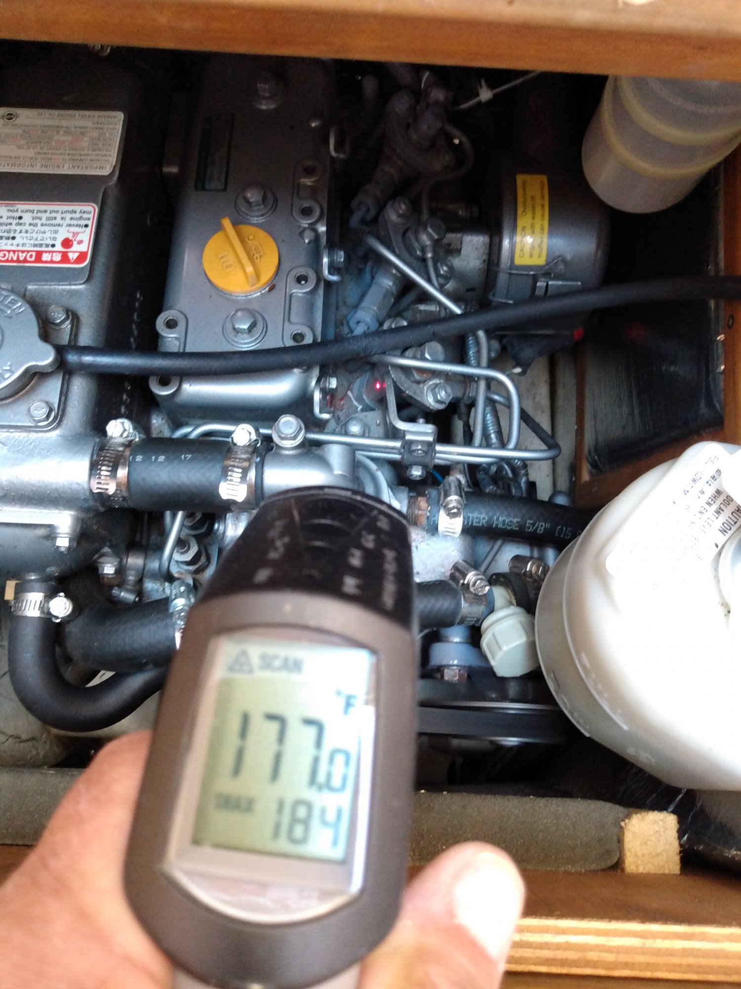

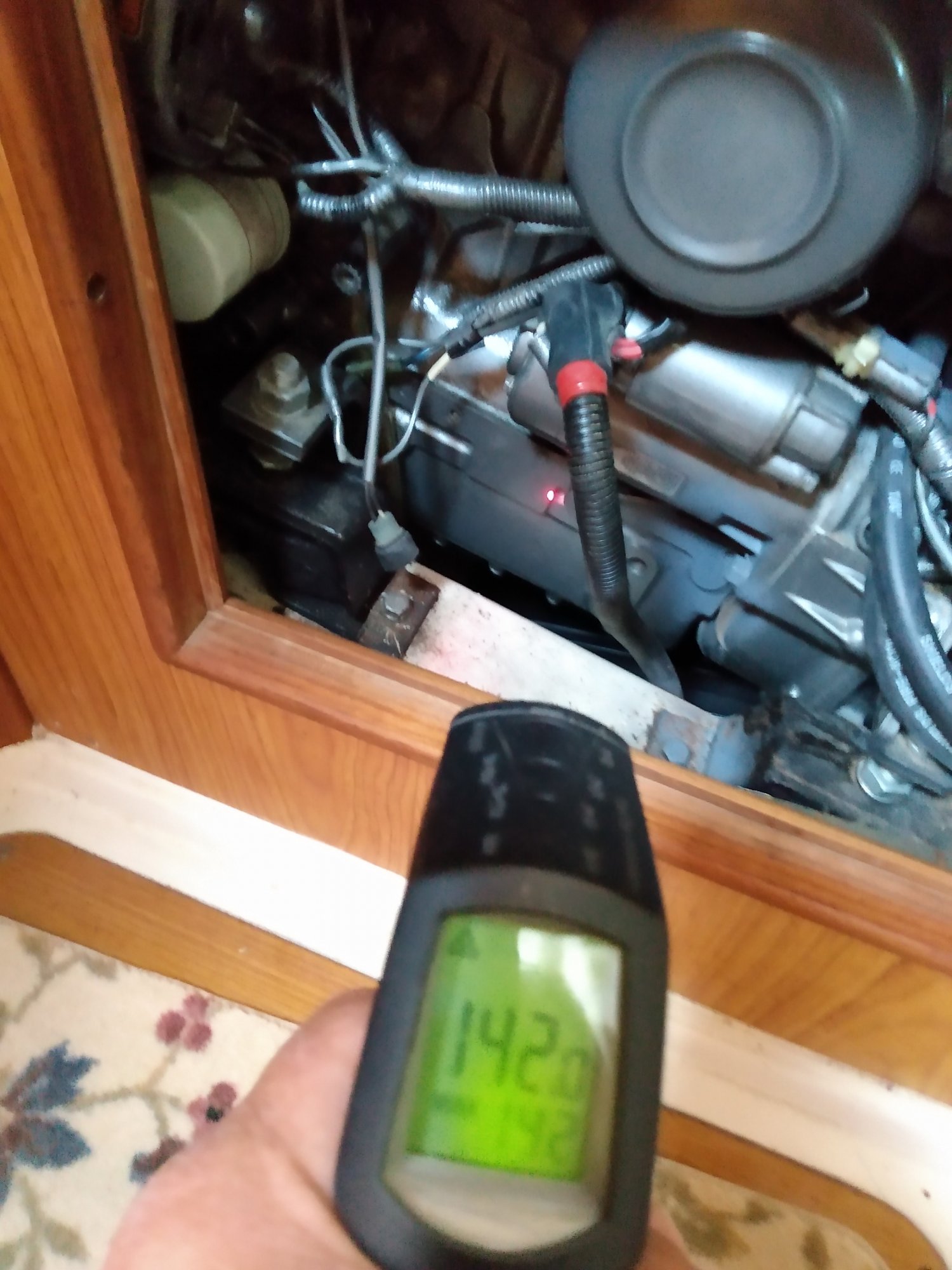

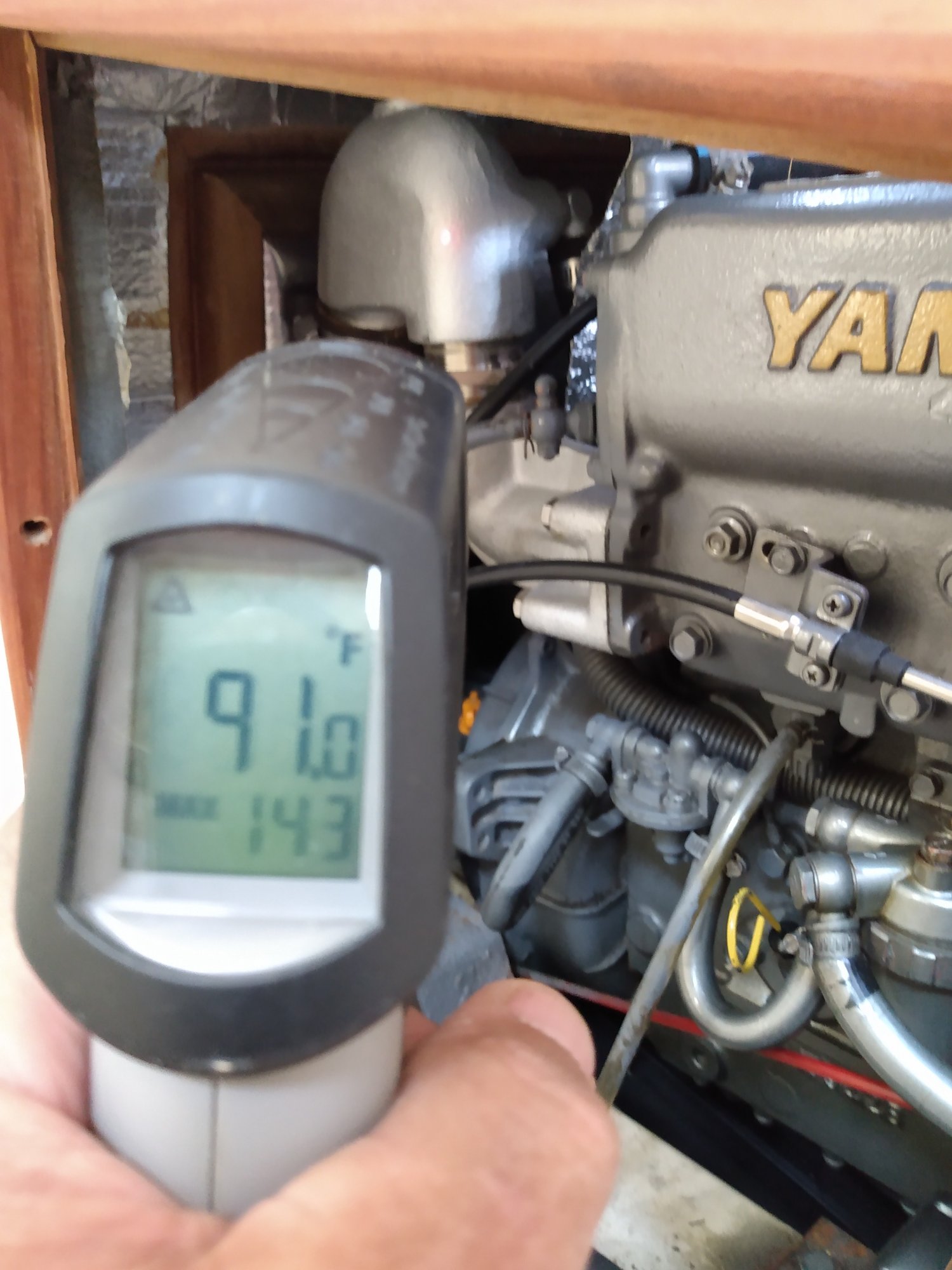

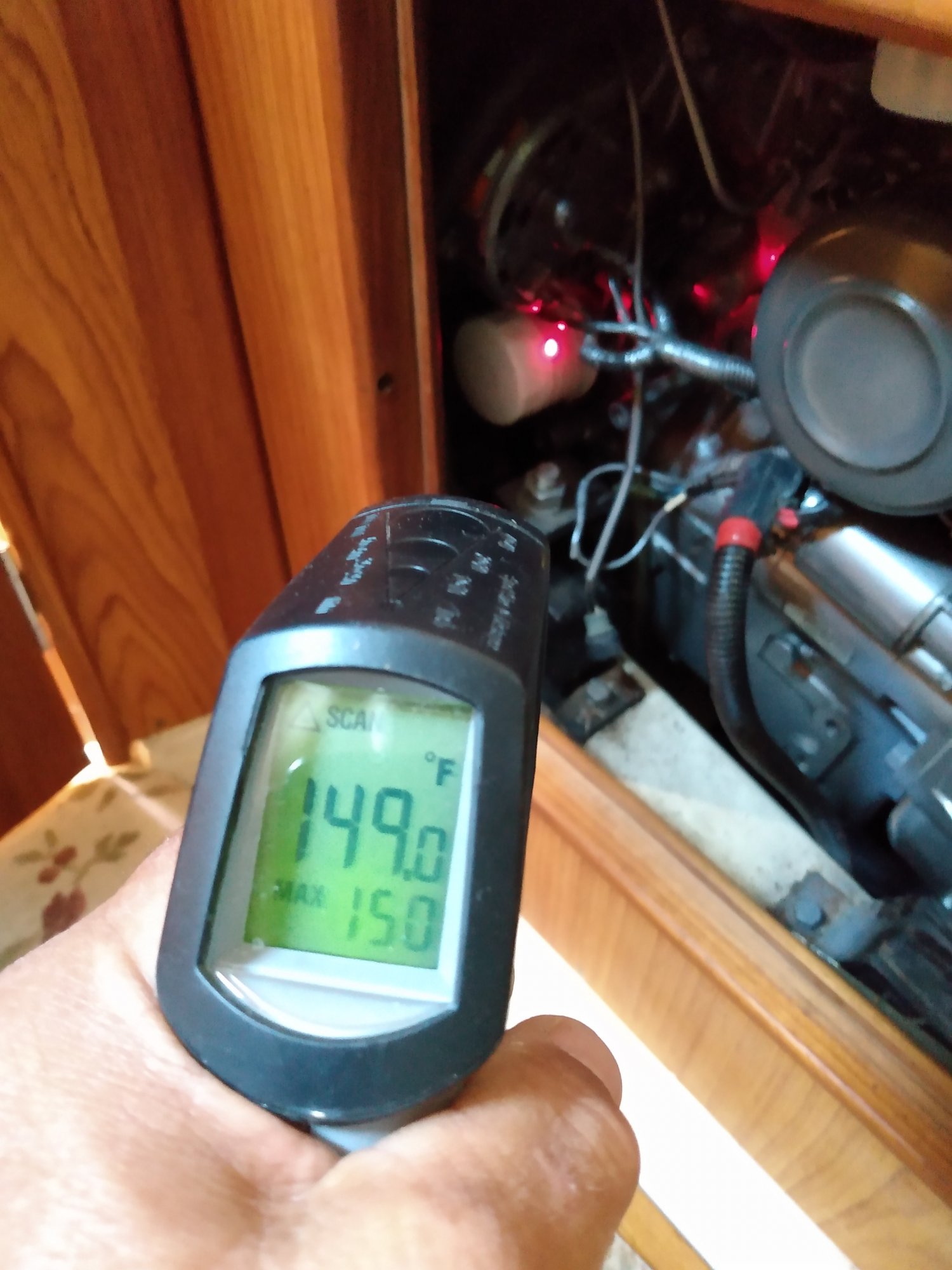

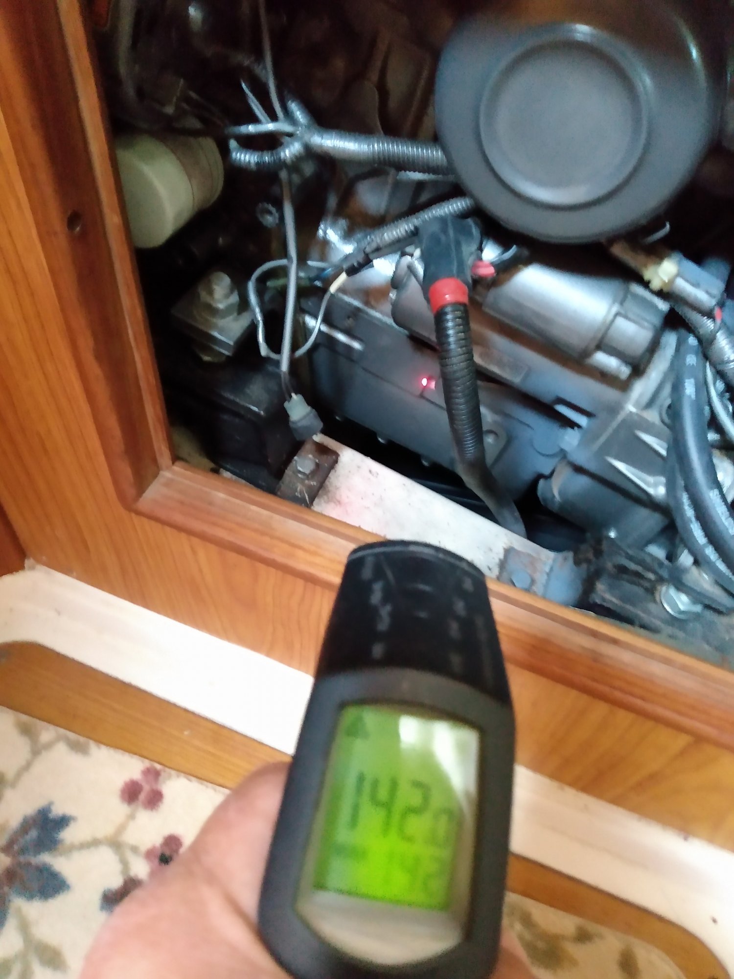

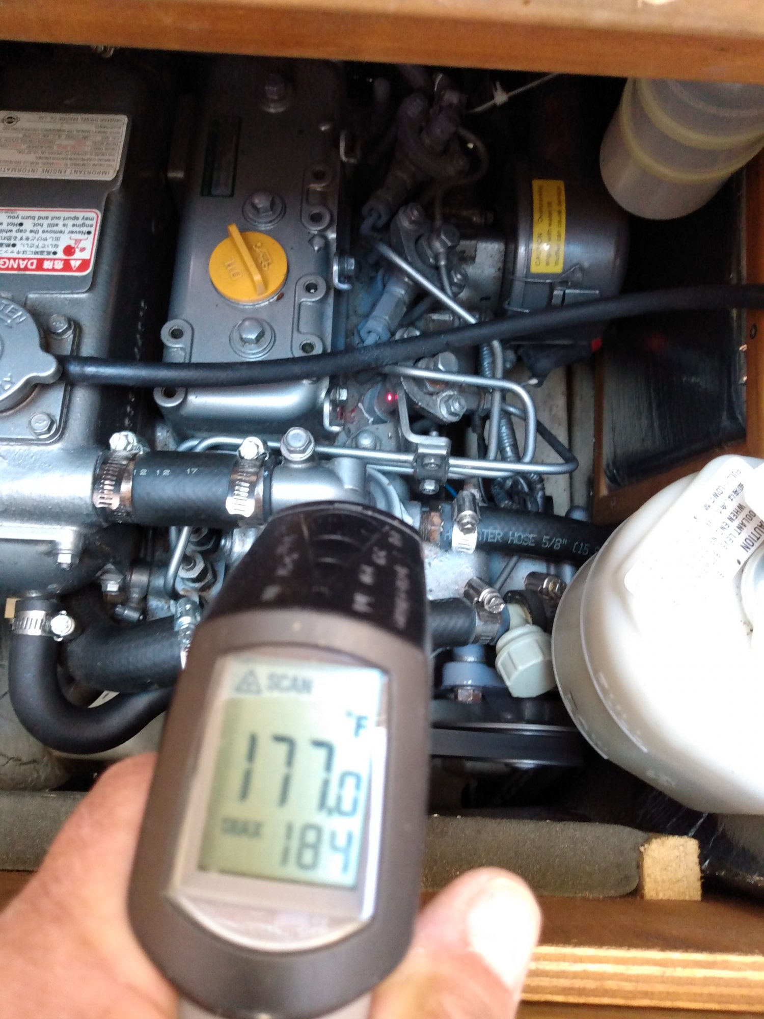

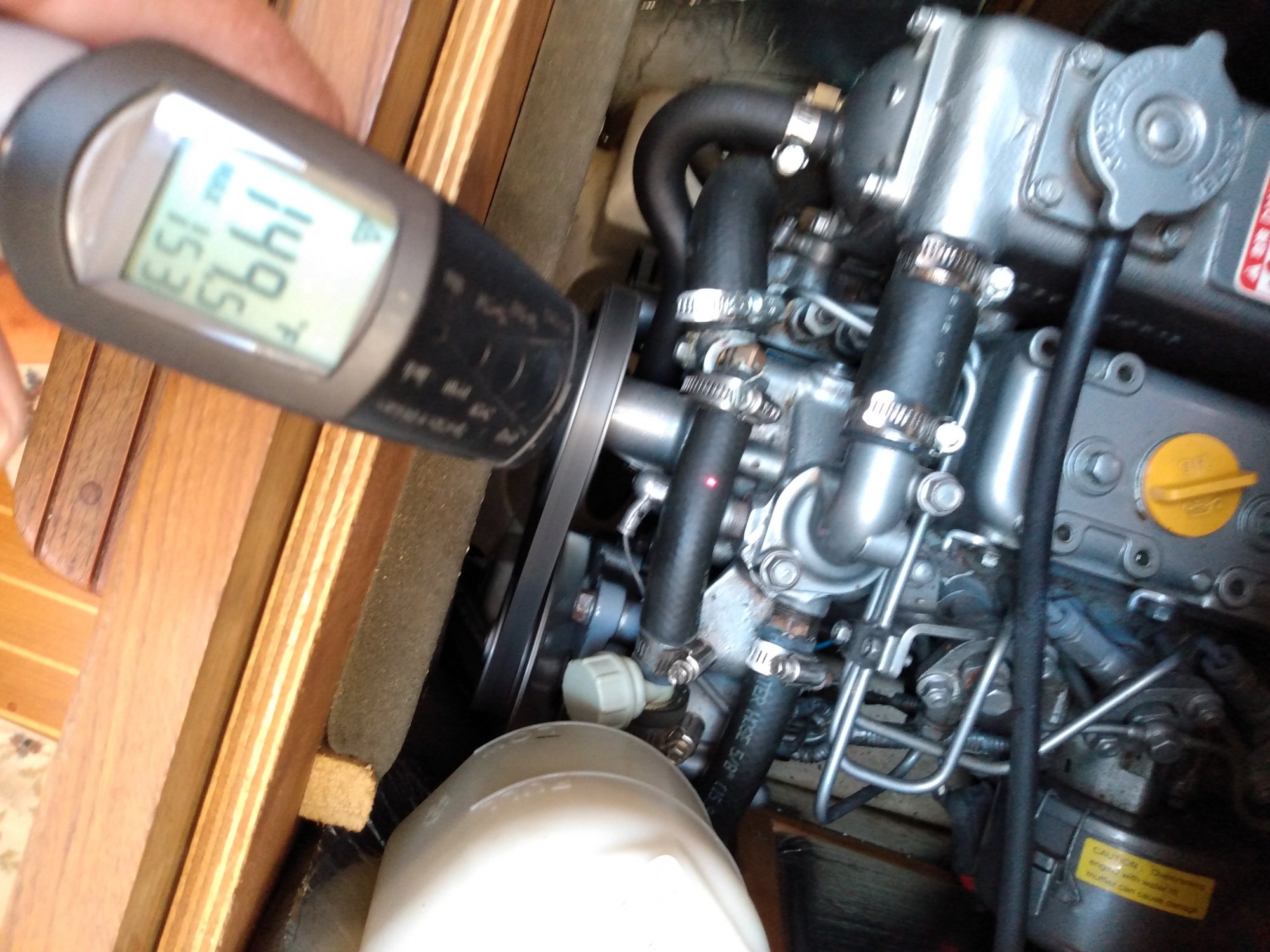

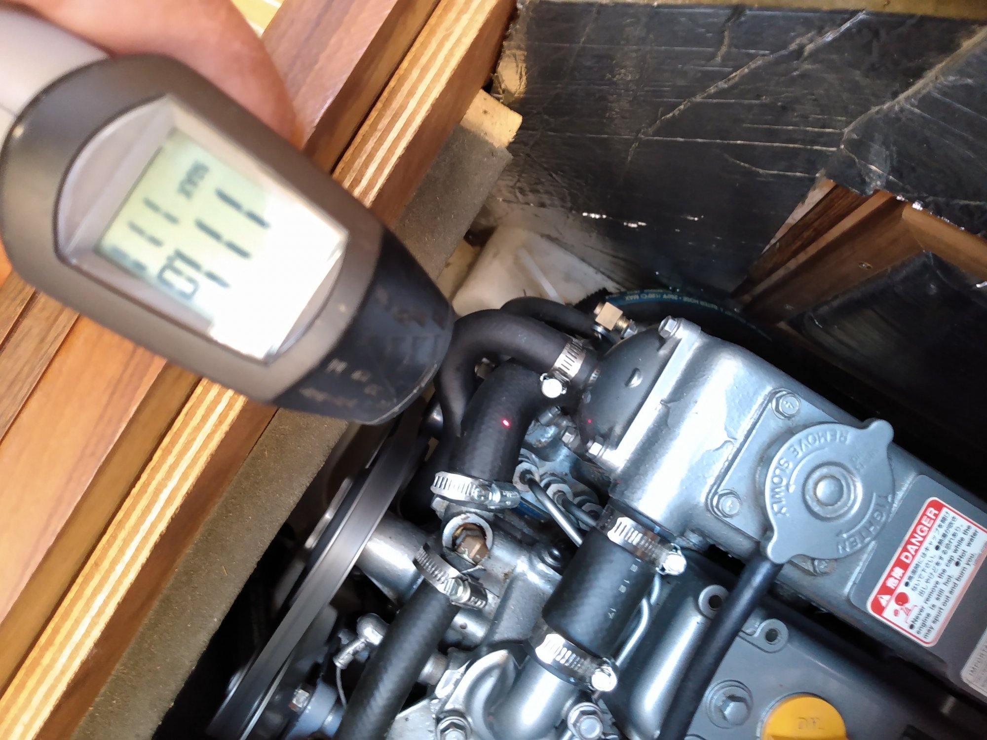

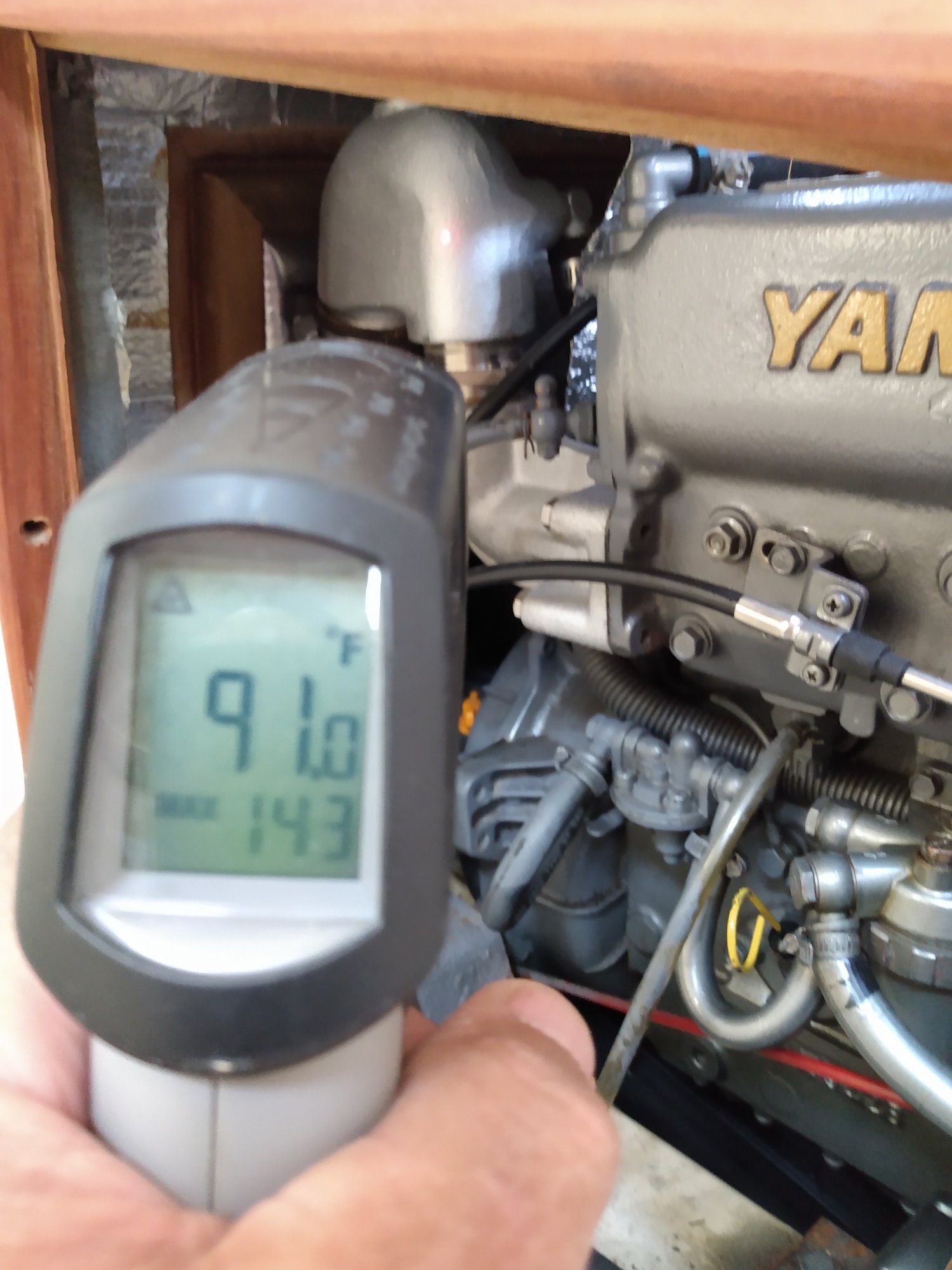

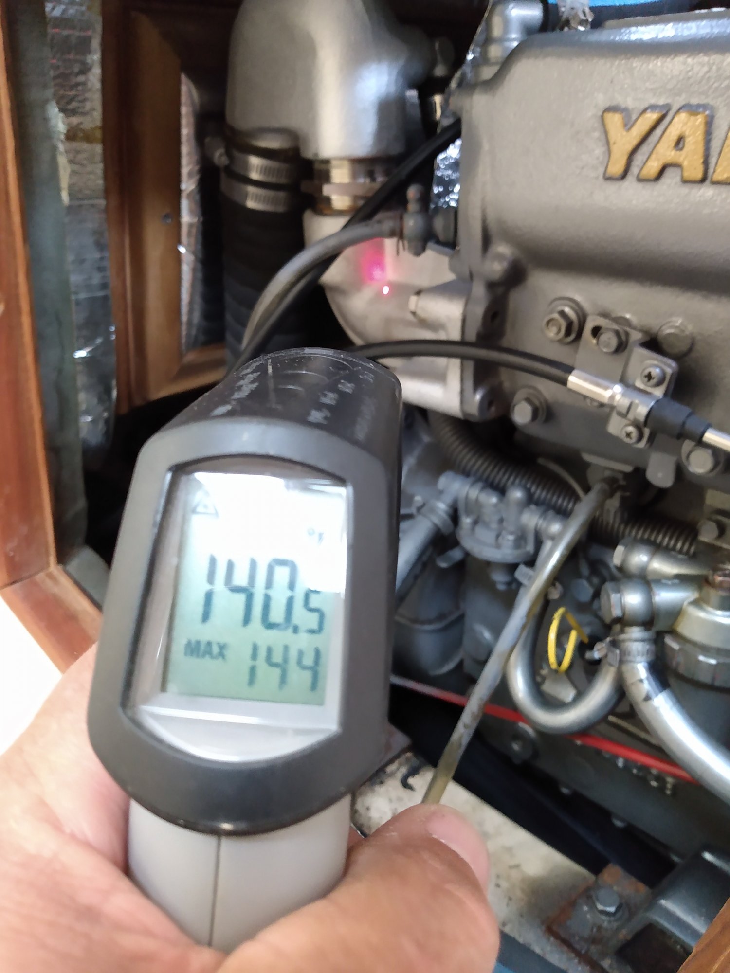

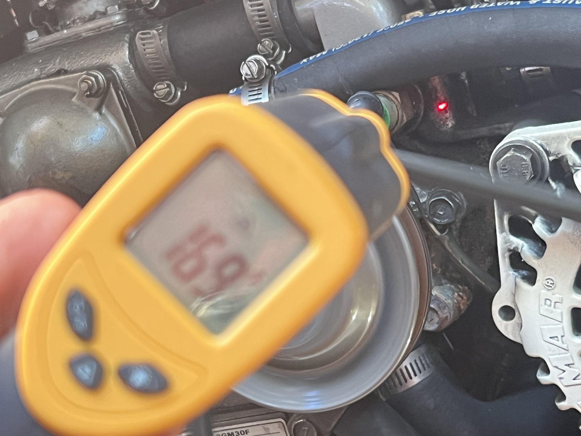

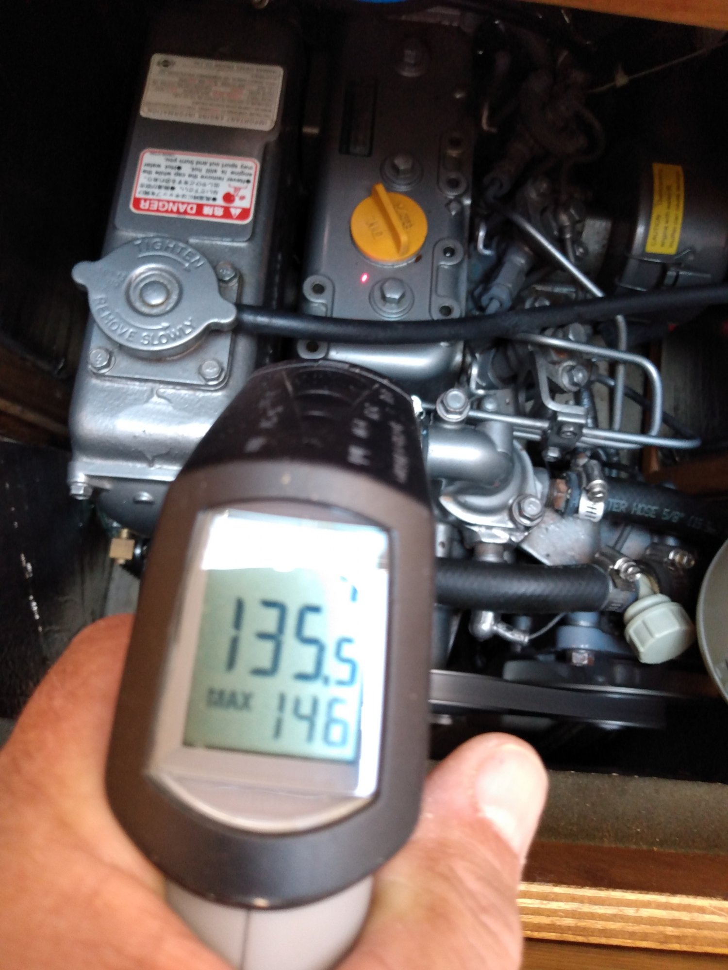

I remembered your post yesterday while I was maneuvering through the marina. About 1.5 hours of running time. Same engine as you, 3GM30F.
I didn’t remember the exact places you took measurement, so I just took a few around. This was also running at <1500 rpm and up to 2000 rpm.
I hope this helps in some way, different areas, but it gives you a comparison to see.
One is of the oil filter, but that was my own curiosity. One was of the thermostat, but it didn’t come out clear at all. I’m not the best picture taker. The temperature was 170.
10,244
Thermostat spec is to start openiing at 160 F and be fully open at 185 F. if you measured 170 on the thermostat housing, that sounds fine. A measurement on a rubber hose will not be accurate for the internal temperature since rubber is a much better insulator than iron/steel/aluminum.
