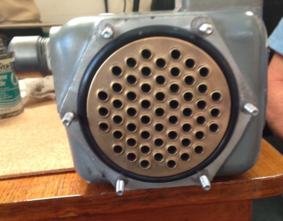

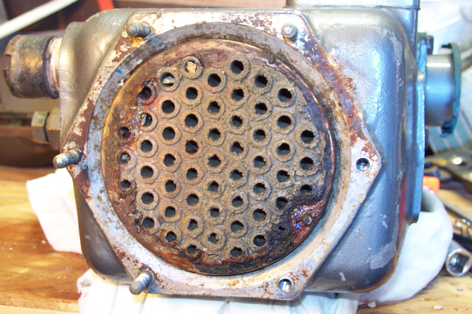

I have attached before and pictures of my heat exchanger to
1 Show that if you removed the end caps the seal provided by the O ring would leak and the fresh water would probably pour out
2 The shop cleaning was really effective - they refurbished the whole exchanger for $170.
Maybe your question is actually pretty smart
I love those pictures... So great to see a well cleaned heat exchanger; Most owners just don't get how much future maintenance costs in parts and labor, avoiding performance loss, and avoiding potential DIW that $170 service can save you.
