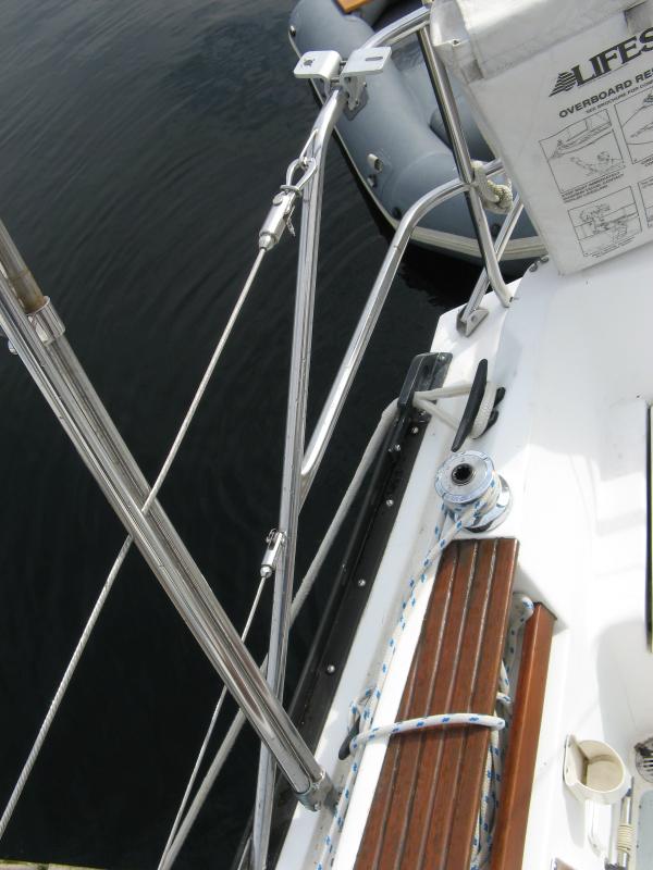

I suspect this is one of the differences between the earlier deck mould and the '83 and later version. I have never experienced this issue with my boat. I was trying to look at some photos to see a difference. I was on Jose Guidera's site and it seems like the cockpit combing is different at the stern from mine. Mine seems to wrap around at a bit higher up back at the transom. Sorry I don't have a clearer picture.

Jim the 79 isn't like that, the side terminates about 4 inches before the transom. No matter I'll modify it to prevent it from migrating along the back.
Sandpiper it's one of my favorite spots to sit so that's not an option, regardless of efficiency.
It's interesting though that they did change the deck molds, makes me wonder if it was one of the reasons.
