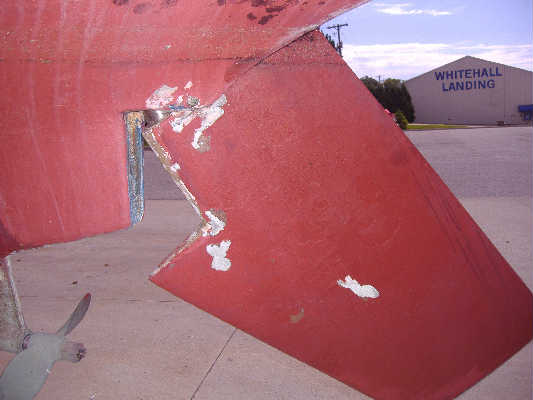

Wow, looking at the pictures that rudder took a hit. I replaced my rudder because the PO had bent it and had it repaired. It never felt right, but it worked OK. There was no other damage at or near the rudder shaft. You should inspect that area very well. The rudder post itself is made of SS about 3/16th thick. I don't know for sure, but I think the shaft was made to bent first and prevent damage to the hull that could sink the boat. I would not replace it with a solid rudder post. You can buy a new rudder from a company in Fla. (can't remember the name right now) for about $1,000. I happened across a used one in Texas for $600. I found it on the net after 8 months of looking. The replacement rudder was from an 1980 Hunter '27. Take good measurement and things will work out.

The rudder and keel are different from later Hunter 27's. Our '77 h27 has a balanced rudder without the notch in the front, and without the shallow keel coming back to fit into the notch in the rudder.

I concur that you need to have clearance below to drop the rudder. On the hard that almost always means digging a hole. And you do want to get it out now to get the repair/replacement started, and to be sure that the fiberglass tube that holds the rudder tube is in good shape before you splash the boat. It could easily be split or crushed if the rudder was bent that badly. Foss Foam is the leading rudder supplier - then and now as far as I know.
