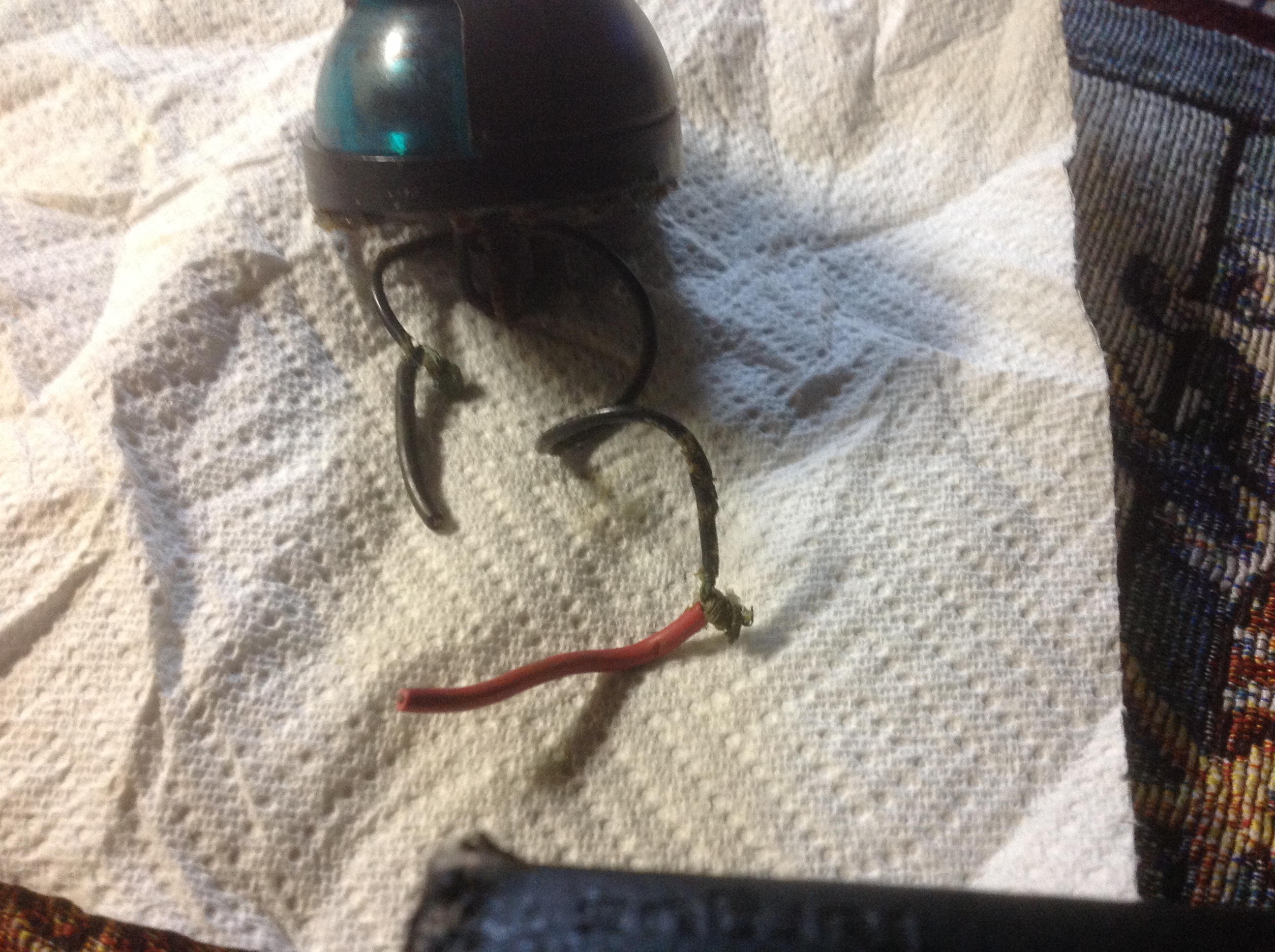

I first pulled the starboard light and found that the wiring was simply twisted together, not even a wire nut (I was hoping for something even if it was bad).

Back up on deck. Check out the wiring and voltage. Hmmmm.. 7.5 volts. LED only lights up 4 of the 10 LEDs, What gives, back down below, 12.5+ volts, remove port side wire and I get 12.5+. Ok now to remove the port side light, yep same twisted wire and still no connector, wire nut or even tape. Nice green corrosion on the twisted wire clumps. Trim everything up, new connectors and amazingly now I have a full 12.5+ and all 10 LEDs light up on both port and starboard lights. Yea success.
Only took all afternoon and twisting myself into a few positions that this old body doesn't fit into anymore. The most interesting part was getting only partial voltage due to the corroded and poor connections. I'm just an amatuer at the electrical and so was flumuxed by the 7.5 volt reading when I expected 12+. One wire with 12.5+ wired to two wires should give me 12.5+ at both end wires unless my 1 semester of college electronics was totally wasted. How corroded and poor connections draw off 5+ volts was a mystery to me and caused way too many trips between v-berth and deck.

Corrosion can do same seemingly strange things. The voltage drop shows you that part of the power you wanted to go to the lights was wasted in heat in one or more of those poor connections. Also, never hope for wire nuts on a boat. They are wrong and dangerous for several reasons. Use quality crimped connectors.
Now you need to look for other twisted connections. They all need to be replaced. We had a previous boat that was wired that way and ended up replacing all the power wires in the boat. I didn't find anything over 18 inches that didn't have multiple poor connections (all done wrong). It's surprising no fire had started. This is just as dangerous as bad rigging.
