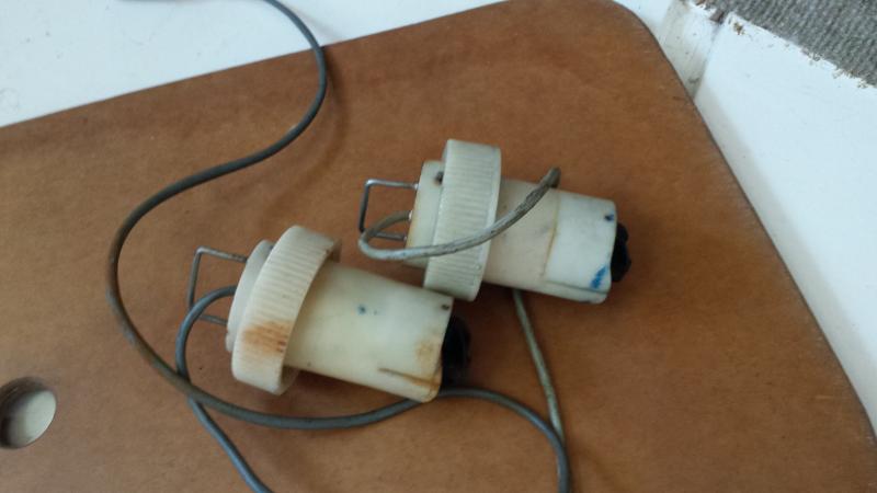

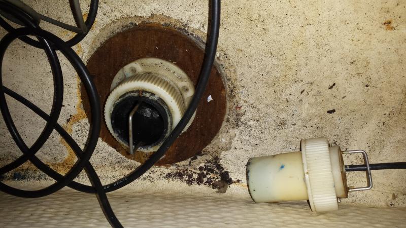

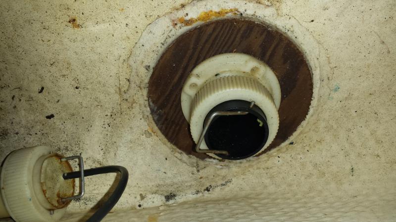

The Through-hull holes have dummy plugs in them where the old transducers went. Are there new replacements that i can just slip in from say raymarine etc? What brand are these any ideas? Thanks.
Just discovered they are old SR mariner Nav-5 transducers. Replacements that fit the holes?

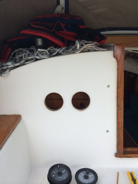

I have the same issue...
Our old SR Mariner instruments were toast. I wanted to find replacements that would fit the old holes but everything was larger diameter. Also, many are now a single unit (speed, depth, temp) and NEMA200 that can talk to a variety of displays.

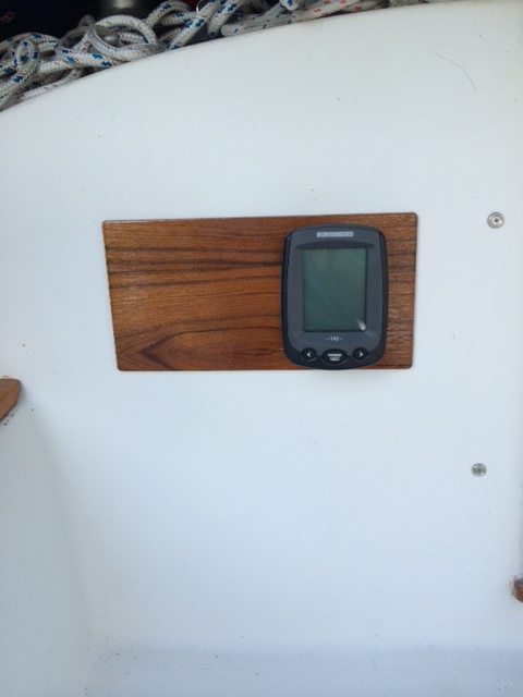

Last season I used an inexpensive fish finder. Epoxied the transducer to the inside of the hull. It worked perfectly and even gave bottom contour info (as well as fish location and size).

I even found a unit that flush mounted in a teak panel that covers the old SR mariner holes. But - it's not "yachty" :)

I used a fish finder on the last 2 boats. It works great and I intend to add one to our newest boat. I like seeing a trend for bottom countours and I really like fish.

That beautiful wood panel looks very yacht y to me!
What kind of wood is it? Very nice finish.

That beautiful wood panel looks very yacht y to me! What kind of wood is it? Very nice finish. BTW ,what do you do with two yacthits?
I do like the way that panel turned out. Covers up those two huge holes and still space for something else. I made it from 3/8 marine ply that is faced with teak. Used Epifines "wood finish" (5 coats, thinned 50%, 25%, 10%, 0, 0). It's attached with 3M commercial grade mounting tape. Love that stuff. It's mildly acid based so it's almost a structural bond, unaffected by moisture or temperature. It's about 1/32 thick so you can use a long razor knife to separate it if needed.
