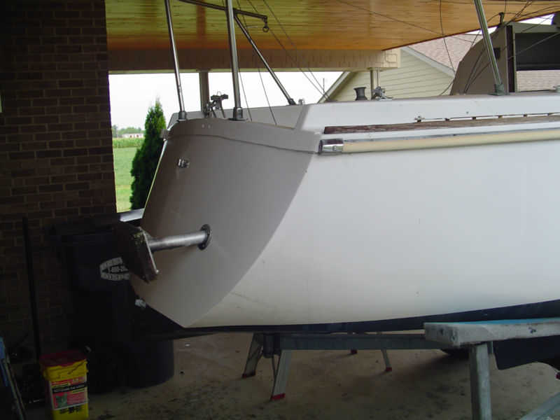

I suspect that you've seen so few due to the brackets wearing out and breaking from age, corrosion of the aluminum castings in a saltwater boat would eventually weaken them. I think O'DAY switched to a stainless-steel version before changing to the later lifting style brackets.
One disadvantage for some people will be the limit of no more than 6HP on those original brackets, also (and I really prefer fixed-height brackets.... but..) I've always felt that those old brackets were located too low on the transom for my taste, not sure how safe from a dunking the powerhead of the outboard will be.

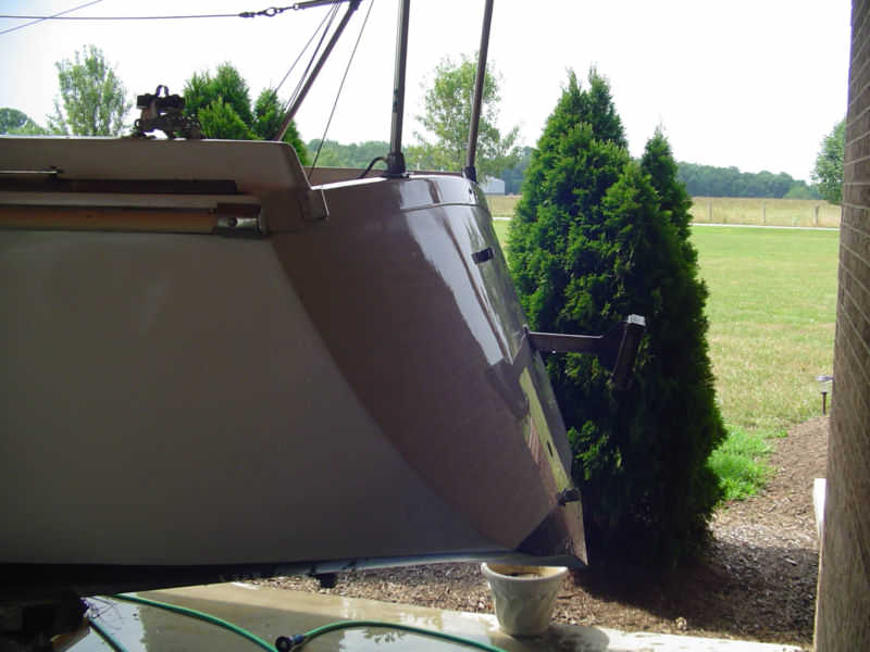

Here is a comment from Robbie Pierce, a former VP at O'DAY. "OD- 22 Outboard brackets - Caution when exceeding 6hp. Some of the early brackets were made by Schaefer Marine, and broke at the weld joint. They were black anodized aluminum tube slid inside another transom tube."
Pictures below! Note that these were used on the early 27s as well! Somewhere I have pictures of one of those brackets removed from someone's boat, if I find them, it will better show the construction.

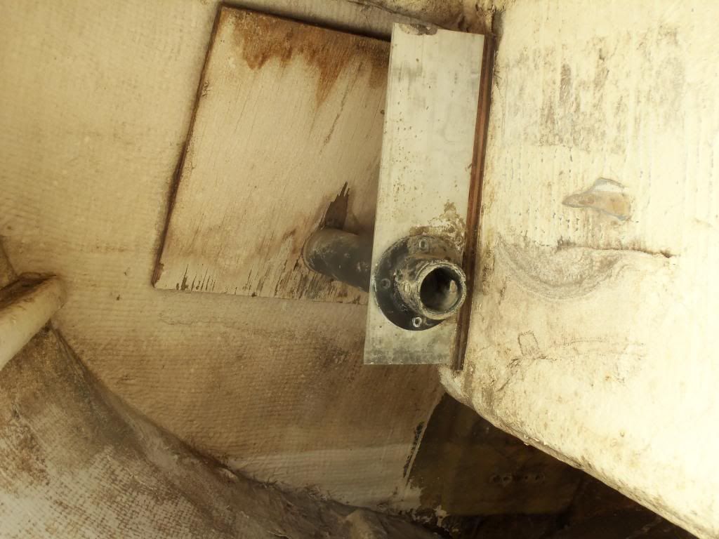

Jun 21, 2012
29
Chrysler 26 wilmington
Sorry for how dirty things look, but this old 22' has been sitting for a while. I've already removed all the collar bolts, at first thinking the collar was a different piece... oh well needed to remove them anyway to facilitate some type of repair on the cracked collar. All this section will be cleaned and painted in the coming days.
