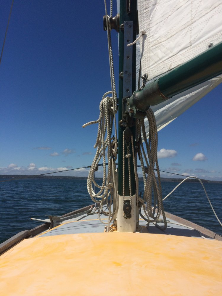

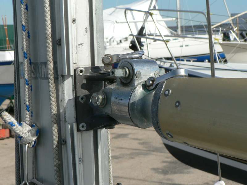

Here is a pic of my gear. Thanks for thoughtful input. Capta, I’m going to try your suggestion of lowering halyard to a set point first. Question: if that is intended procedure why have the slide on the mast at all? Couldn’t the gooseneck just be set at a fixed height?

View attachment 152240 Here is a pic of my gear. Thanks for thoughtful input. Capta, I’m going to try your suggestion of lowering halyard to a set point first. Question: if that is intended procedure why have the slide on the mast at all? Couldn’t the gooseneck just be set at a fixed height?
I have a similar set up. While I have a new main with jiffy reefing today, I used the roller boom reefing for years. I actually rolled most of my reefs in at anchor or on the mooring, without hoisting the main. Because the system is slow it can be a little tedious in any wind (which is why you're reefing). I knew how to direct the sail as I rolled to keep a good shape.
As far as rolling in a reef with a hoisted main, I did it your way and dropped the halyard until the boom hit the bottom of the track and rolled the sail up until it hit the top of the gooseneck track, repeat. The idea that the booms weight would keep the cloth taut, works. As I recall, there was about 4 turns of the crank to rotate the boom, once.
But the slide I still use, as a downhaul. It's a handier device to tension the mains luff, after hoisting, especially after tying in a reef.
