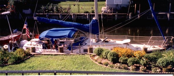

We have one and just love it. There is no pass through so the cockpit is set well down in the boat and gives a huge sense of security as well as an attractive line. Does not look like an elephant with a howdah on top. Draws only five feet. Practical Sailor had an article, which I have and would be happy to send you. I attach a photo of ours.
