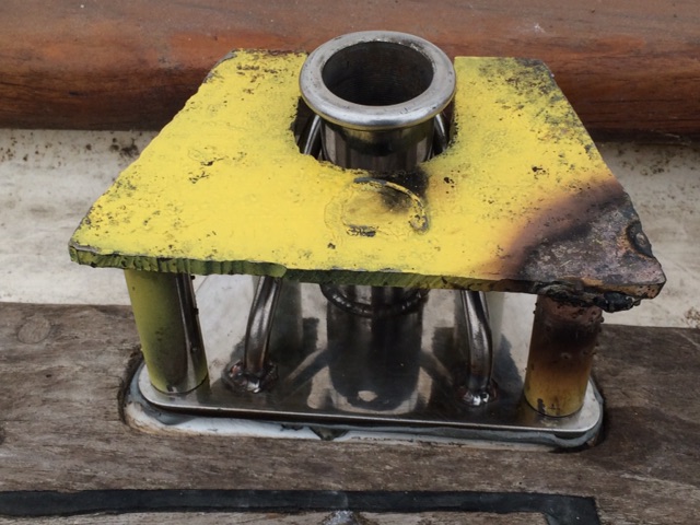

What? 4 sockets or are they Phillips head screw drivers, welded to a plate?
Ok That is cool.

They are 4 deep 6 point sockets welded to the plate. The hardest part was finding a store which had 4 the same size in stock!
