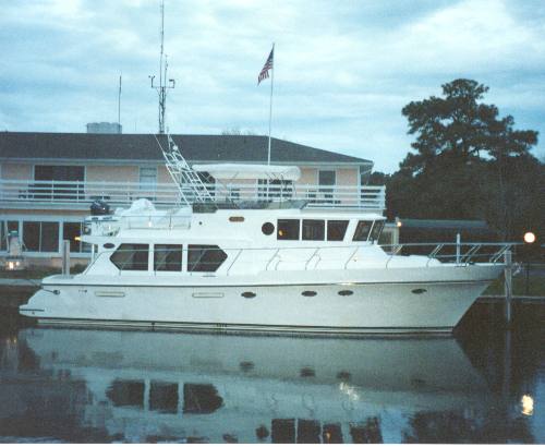

We just got this Pilothouse. Both the 50 gallon holding tank and the maserator pump are under the owner cabin sole and are below the water line. The discharge of the holding tank is also below the waterline, but only by about 3 to 4 inches. Working backwards, the discharge hose from the thru hull valve goes up vertically about 3 feet with a vented loop, then back down to the holding tank. The problem is that water sometimes syphons back to the holding tank and fills it if the valve is not closed. I know the valve should be closed and I do close it when not on the boat. It is in a location that is a real PITA. My guess is the vent in the vented loop is not working. Your expert opinion is greatly appreciated.
