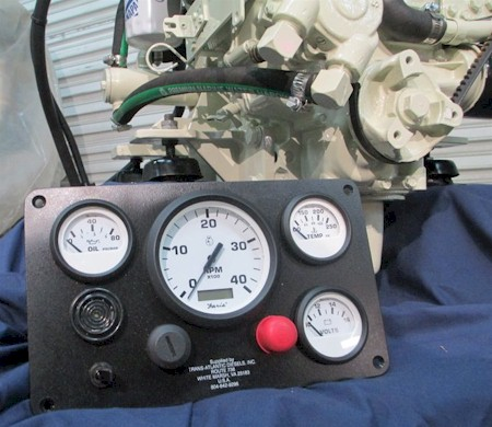

Many control panels have both an oil pressure gauge and an oil alarm. Here's an older rebuilt Universal motor with a newer control panel pic I found on the net.
So if I wanted to rem my Universal control panel ammeter and replace it with an oil pressure gauge, and keep my low/no pressure oil alarm, what type of sending unit would I need in order to feed both?
I searched sending units and came up empty. I would like to believe that there is a sender with dual outputs - not for dual station gauges but for one gauge and one alarm, and not have to plumb in a T fitting.
