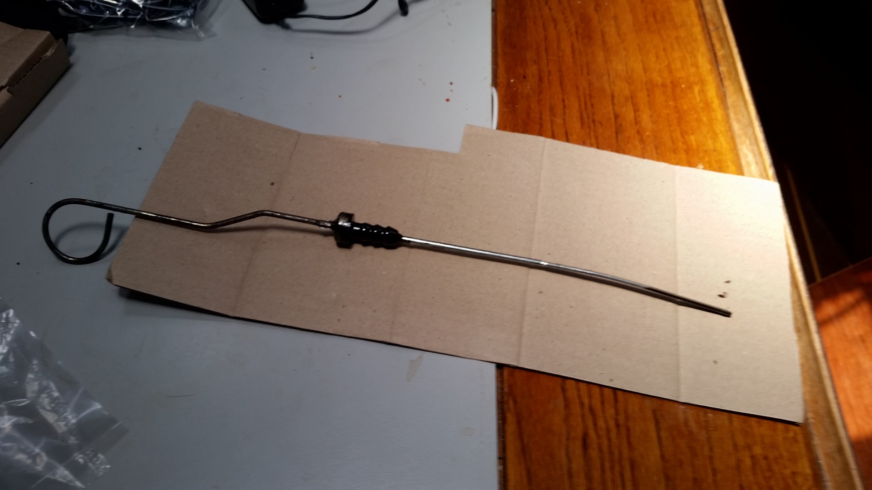

is the rubber grommet still on the stick take it out and take pic of it and post it on here so we can see what you have

Yes it still has the rubber piece. See pic. But it's odd that though it is inserted it is loose. I can wiggle it over an inch either way. When I pull it has no resistance. Which wasn't the case in past times.

can you move the grommet up and down the dip stick if you can it time to get a replacement stick ...they are not that expensive

NO the rubber doesn't move. But it is simply too small. Could there be a sleeve that should be inside the opening for the dipstick? Or the rubber shrunk? By the way a replacement dipstick is pretty pricy. 85 dollars. Though at this point I think that is what I need.

that is pricy ...i am not sure we have nailed down the problem .......if the rubber is not moving on the stick it should be ok ......do you know a marine/yanmar mechanic in the area that you can talk to...there has to be something else going on that we have not established .....if you do have a talk whit he and see if he has any ideas......

Ah Woodster. Sometimes I need a 2X4 up the side of the head. Good call. My mechanic has seen the dipstick flopping in the hole of the engine. Has replaced a few. He can't explain it either.
But I'm so lucky,,,,,,,the new dipstick is way cheaper than the one I found. A measely 75 dollars. ;-)
