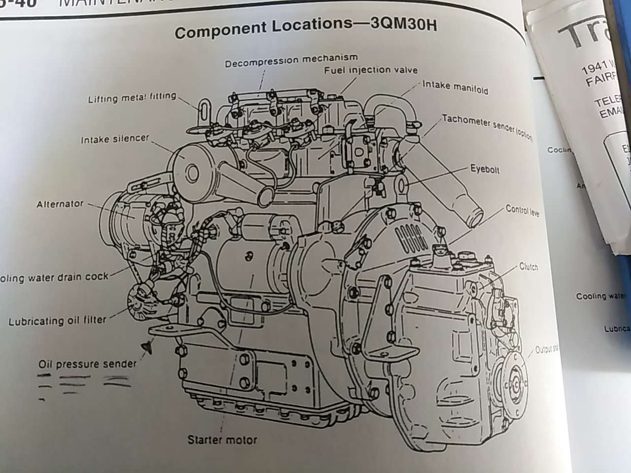

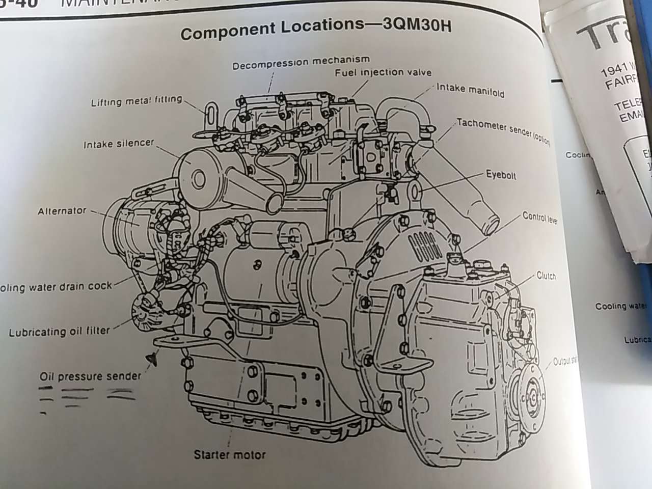

Where is oil sender located on the engine... I assume down by the oil filter... ?
3qm30h

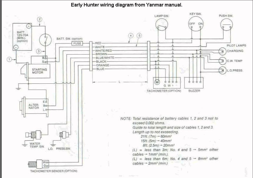

switches for idiot lights don't have a partially off feature. Soooo it is not the oil pressure switch. If you look at the wiring diagram you will notice a diode in each idiot light circuit. Those do go partially bad and pass current
