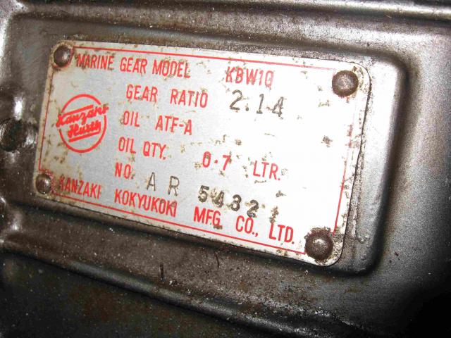

Jorge:
Also, the nameplate on the transmission that is mated to your Yanmar engine should specify the recommended lubricant for the transmission.
Here is a photo of the nameplate for the transmission that is bolted to my 2QM20 ... but best you verify the nameplate on your own boat.
regards,
rardi

Jorge:
regards,
rardi
My motor is a 2GM
May 27, 2004
2,056
J, So's mine. Please advise what you find on your tranny ID plate and post for all of us to see.
Thanks,
G.
