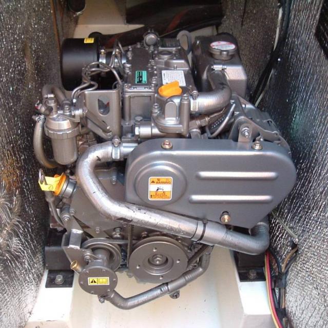

Ed how do you like the 3ym I am putting in it's baby brother on my 30. I have seen some grousing about the fresh water heat exchanger though it seems like only one frequent complainer.
As to changing the oil I always kept a bad under the old engine but it does make sense to keep one under the new I guess.
Jun 2, 2004
5,802

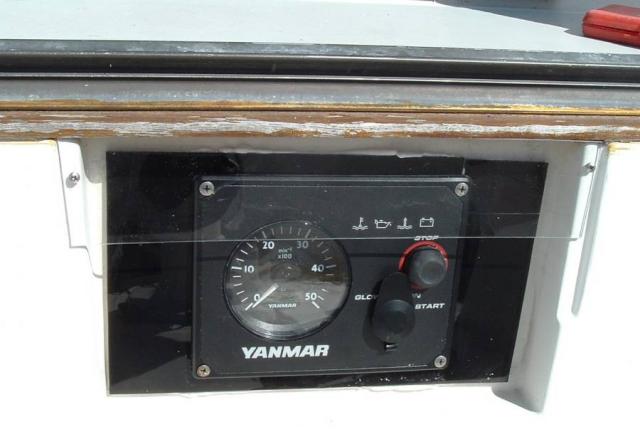

It's a sweetheart! Small, light, and smooth, it starts within a revolution. On the trip to Florida I plugged about three fuel filters. Coasting in the middle of a channel I changed the Racor, hit the starter, and maybe it took three revolutions. No bleeding is a great feature. Wish it had come with gauges though. I had a complete VDO panel with my 2QM20.
