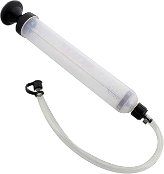

I'm not sure it's really what you are looking for but I have an oil fill syringe that I use for filling the transmission on my FJ Cruiser which is a real PITA to get at, there is NO way to get a direct pour with only a few inches clearance around the fill hole. It would take a several fills to fully load a 4.108 so may not be the most effective but it is an easy way to get a clean fill. It looks like this:
