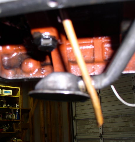

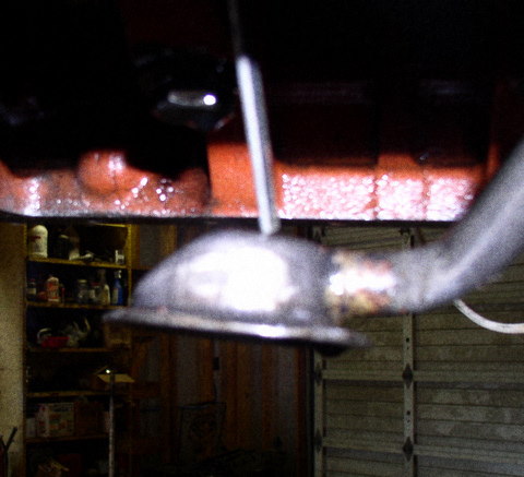

The largest tube that will fit in this hole is 5/16" outside diameter. The best tubing for this purpose is steel brake line from an auto parts store. Buy a 15-18" piece and then simply cut off the swaged fittings from each end. It is important to know that a straight piece of tubing will hit the the top of the oil pickup assembly and will not reach down to the bottom of the sump! Hand bend this tube slightly and the tube
will then slip by the oil pickup assembly and drop several inches further down to the sump bottom - where all of the oil can then be extracted.
