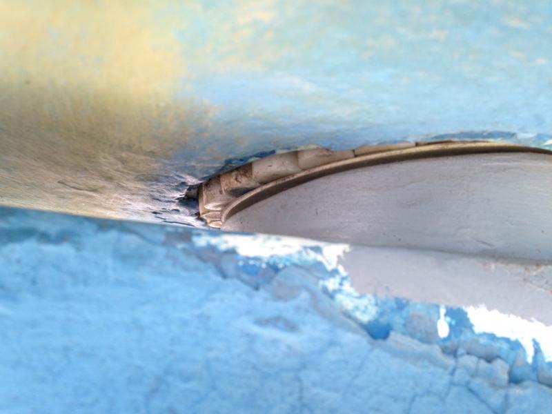

1) Ruder is loose / needs repair: After looking into this more it seems as though the shaft is worn out and the plastic roller bushings are visible from bellow. There is also play at the top and bottom of the shaft. (?Thoughts/Recommendations ?)

may i ask what the first picture in your op represents i can't make it out ...looks like a hole on the boat with i don't know what sticking through

Yes I can, the first picture is of the rudder shaft, where the rudder meets the hull of the boat. The owner had the rudder previously repaired and it was just a "temporary fix". Now the boat yard is saying I will cost about 8k to fix it right. The white cylinders hanging out are the rollers for the shaft.
