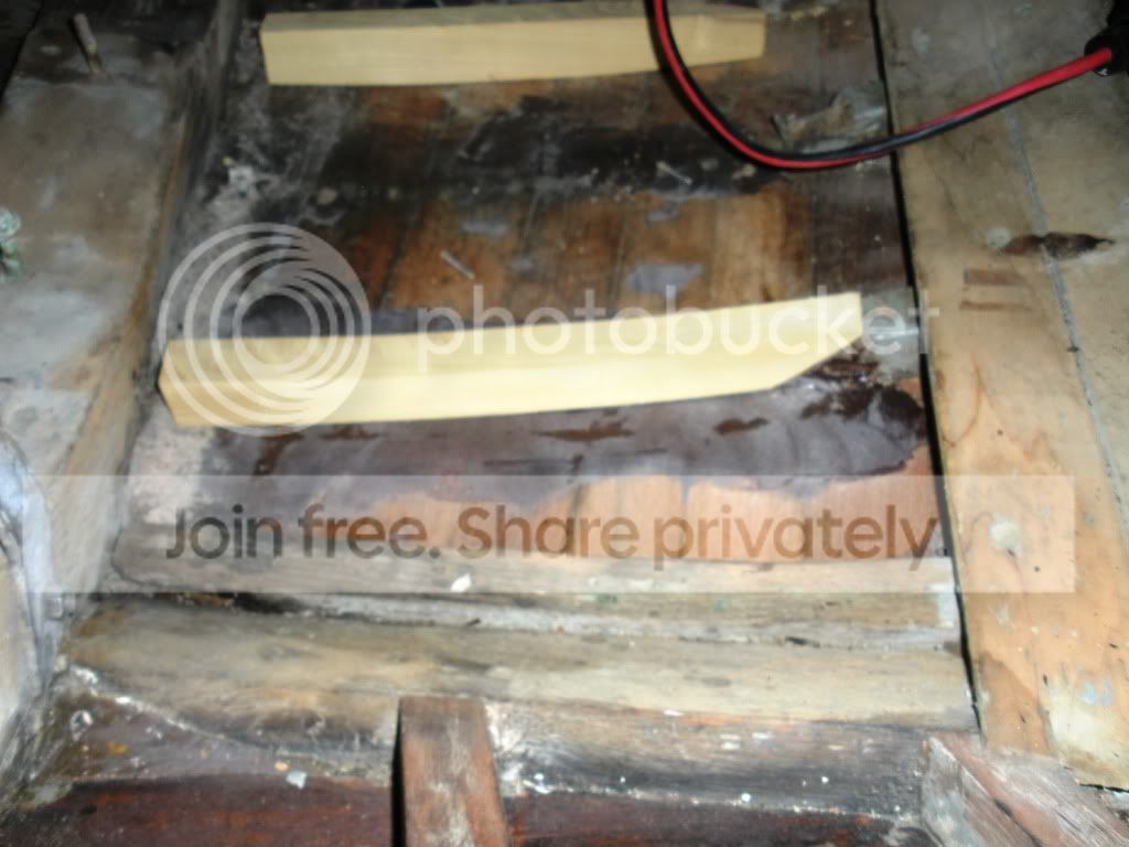

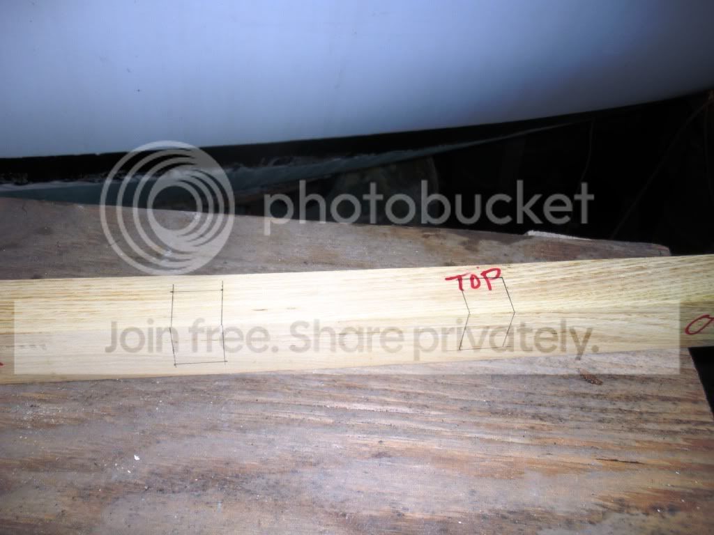

Got into the shop to finish up the cockpit shelf for the Starboard side. When setting and drilling holes for fasteners inboard yesterday, we noticed it splitting. I found a suitable piece of scrap Locust just barely big enough to fashion the piece from. It's a compound curve, both along the curve of the cockpit and fore and aft.

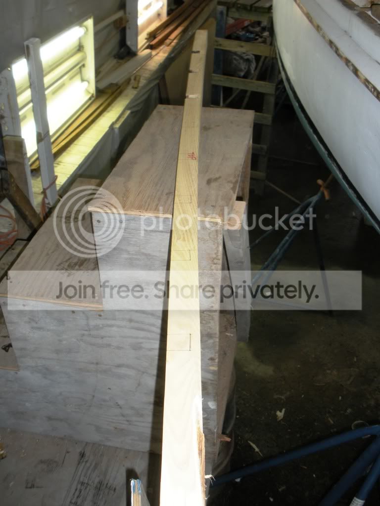

It also has notches outboard for the deck beams and one inboard aft for the mizzen deck beam. Here is a series of the slots being cut.
and

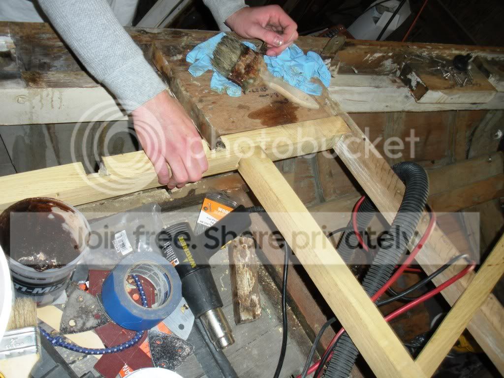

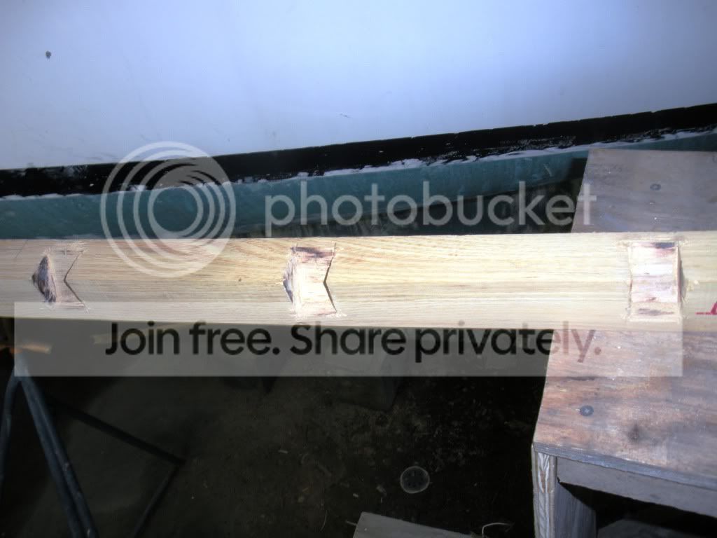

After the slots were cut, notches fore and aft were made to fit.
Finally, we got it set in and bolted up. We'll pull it, seal it and bolt it one last time.

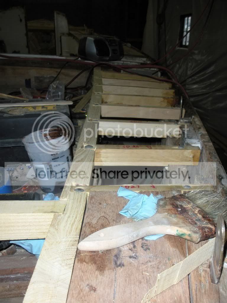

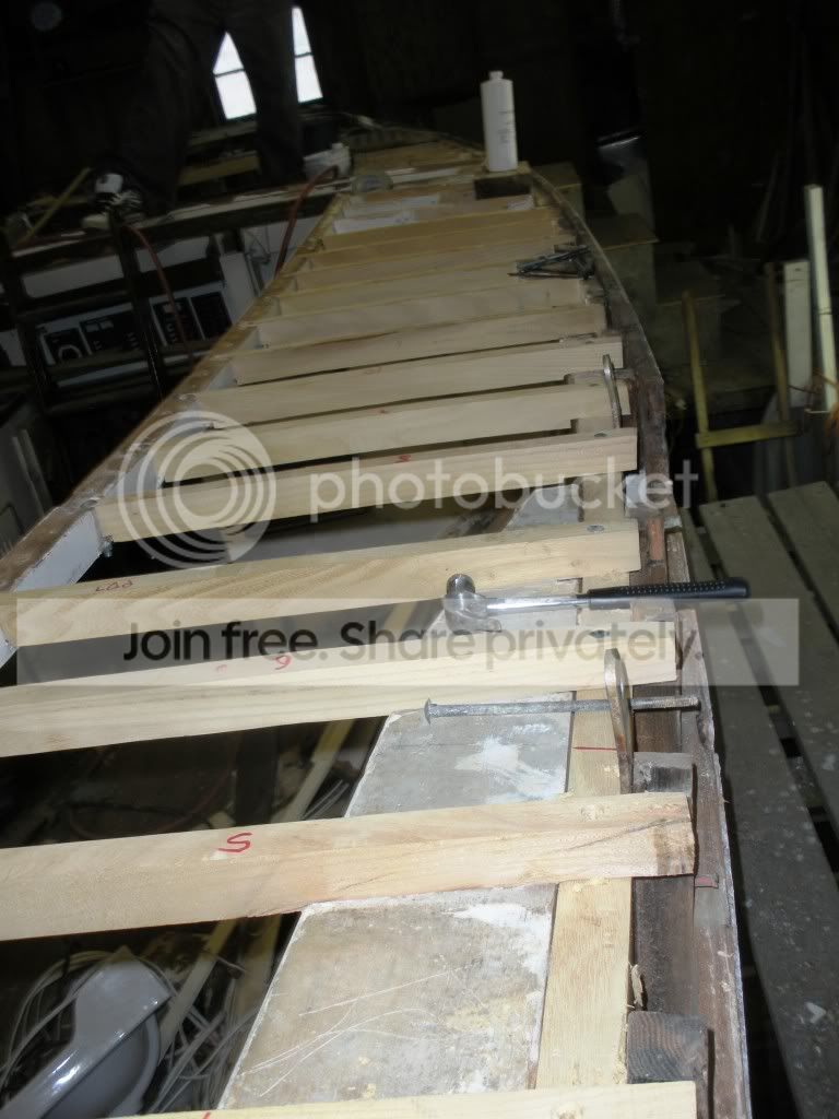

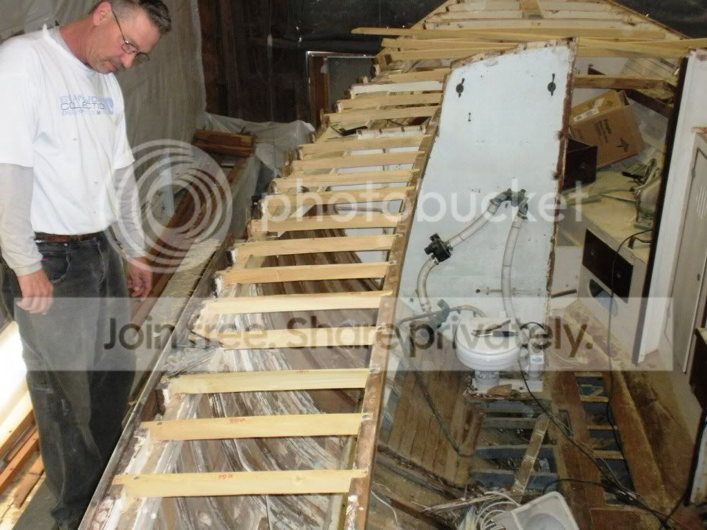

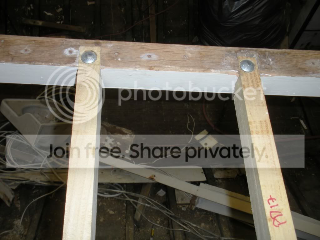

After that we set the chainplate partner in place and began work on the portside deck beams. We had to punch new holes through the new clamp for the 6" carraige bolts. We also had to punch new holes inboard for the new bolts that hold the beams fastened to the shelf (house beams) and countersink the heads flush.
Some detail
Looking forward

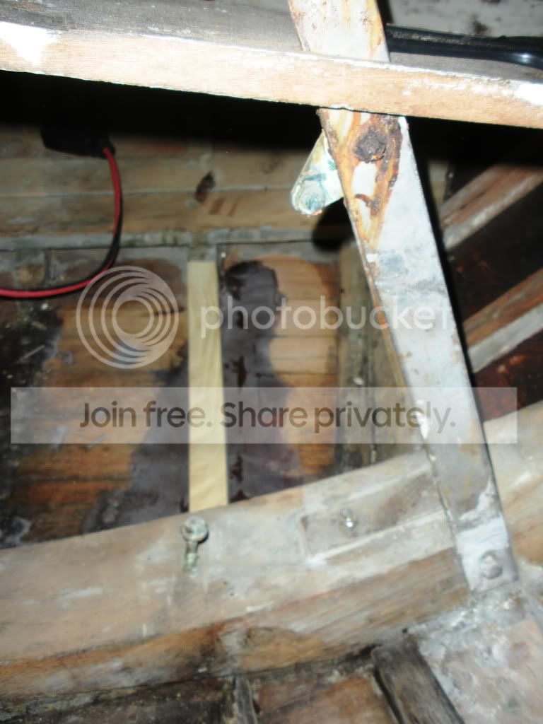

Lastly, while waiting for drill batteries to recharge. I cut and fit the first sawn rib section aft.
Some detail

The difference is startling actually... No pounding, regardless of conditions to windward. Nice and quiet. She just digs in, lays over and goes. No wavelet popping on the hook. She should be even stiffer when I'm done. Those big bolts on the inboard side of the beams are my touch. They were held by angled screws before but I wanted something more substantial.
