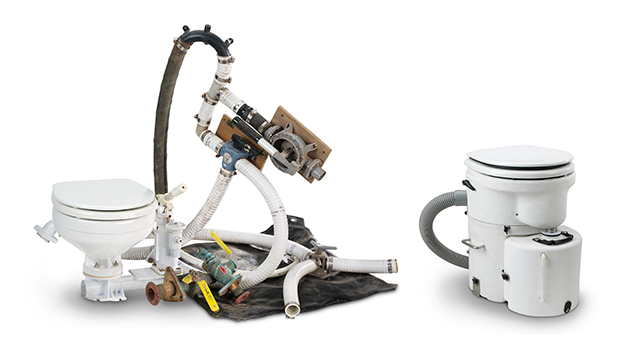

It took me about 5 times longer to remove the old system that it did to install the new one. You have to get kind of inventive when you are trying to remove a used toilet system with material still in the lines. I installed my system about 2 years ago that included using rigid PVC (worked extreamly well), a larger tank and rebuilt the toilet pump. Installation of the OGO was 4 screws. The only issue I had was that my fiberglass platform was not completely flat and the bottom of the toilet is so I had to shim it up in a corner. I would recommend they add adjustable pads on the bottom like a washing machine to beable to level it so it doesn't rock back and forth. Ran the power to my panel with a 7.5 amp fuse and charged it with the furnished material. I have decided to see how the charcoal filters work before driliing a hole for the vent. I barely felt any air movement without the filters out and didn't feel anything with them in. I'm a little concerned on the ability of the fan but we will see.
Build quality appears to be very high. The mechanism for the auger, the auger itself and the hatch mechanism for access to the auger is very sturdy and appears to be well fabricated. I do have some concern with the pull handle for the hatch. Having it pull forward right at your leg doesn't seem to be the greatest location but to be fair, it doesn't come out far enough to touch.

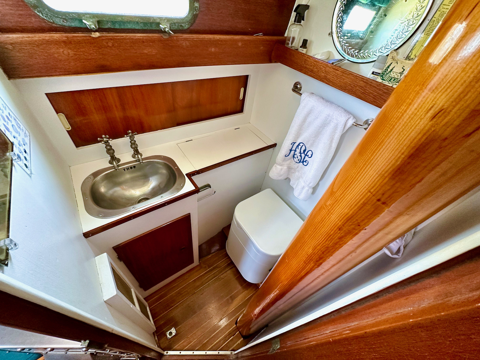

After our second full season with the OGO, my mate still says it's the best thing we've put on board in a long time.
It is the first head that hasn't had a 'head' smell, and we've had a ton of them on different boats over the years.
I think the vent helps. I have it wired to run 24/7 (no switch) as it has so little draw. With 2 onboard for around 40 days a season, I find the process, easy.

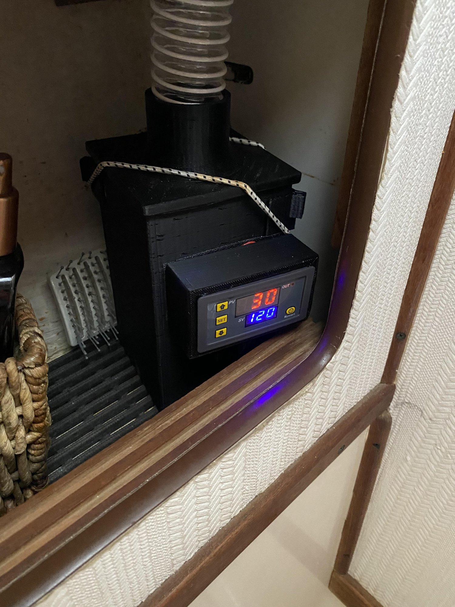

I am currently fabricating a external fan system to draw more air through the toilet. I'll post pictures when done but designing it on Autocad and printing on my 3d printer. The fan box will sit in a compartment behind the toilet and will exhaust through the existing toilet pump out hole through a Wallace closable exhaust port. It will have a digital controller that can be programmed to run for specific length of times and/or cycle on and off on a schedule. The box uses a high output computer fan. It should work well but takes days to print.
Dec 28, 2015
1,912
got it all done and installed today. I didn't take pictures of the inside but can attach CAD drawings if there is a huge need. Essentially it is a square box with 3d printed cones feeding into and out of a high output computer fan in the middle, nipples on both ends with the lid being held on with shock cord. The controller is off of Amazon that has 6 different program modes were you can program it to turn on for a given second, minute or hour and stay off for the same. It has a button to start the cycle at any time which will be nice when the augur is activated. I 3d printed a mount for it. I installed a power switch so I can turn it off while keeping power going to the toilet auger. It moves quit a bit of air and draws about .8 amps when running. I have it set to 30 minutes on 2 hours off for now. I think its going to work great.
