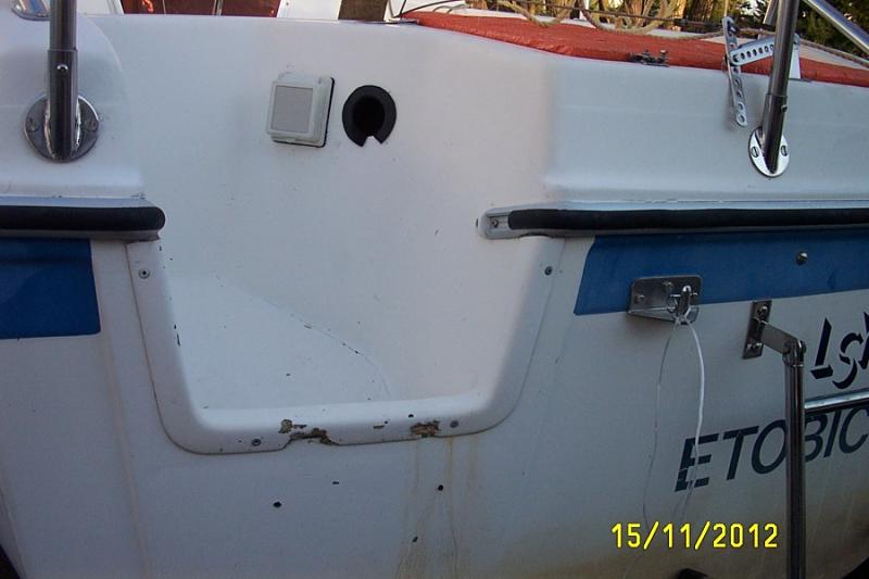

Hi C_witch. I don't think there is a specific hose hook up that goes through the deck. The best you may get is having a short hose from the motor going to a male attachment at the deck. (Just like the one on the tank.) I can see this being a problem. Not that it can't be done, I just think it may be a extra source of water or air into the system. (Not the pretty-st either.) Have you seen Sumners mods? I think he has it figured out. I have almost the same idea. (Hose comes through cabin and hooks to motor. There is a clam shell vent cover over the hole ware the hose comes out. I can push the hose in until the female end hits the clam shell vent. Keeps the open end facing down.)

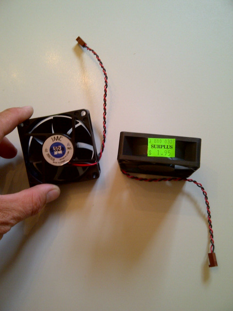

As for putting the fuel tank in the boat... You have to have it vented. Both the area the tank is stored in and the tank.
I vent my laserette with a 3" muffin fan and flexible dryer hose going to a 3" round louvered vent. Very low amp draw and it runs all the time. (My 18v solar panel keeps the battery topped up.)
Pic 1 muffin fans, 2 motor well on another boat...see the big hole? Mine has a clam vent over it. The thing beside that is for shore power.
