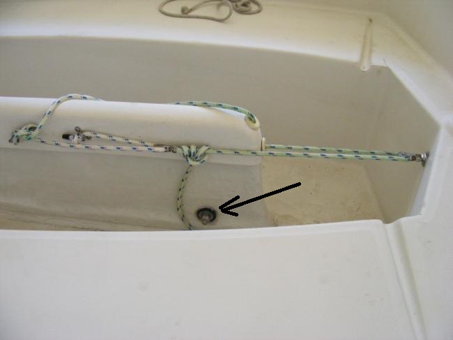

The centerboard pivot gaskets are right on the sides of the CB trunk and are easy to replace, but they should not be leaking into the inner bilge from what I've seen on any Widgeon. I had an older Widgeon (1969) and kept her on a mooring every Summer for the 8 years that I had her. There is plenty of foam inside to prevent sinking, and your newer one should be even better. Rain is more of a problem, rain and strong wind...... look out!
Anyway, D&R Marine www.drmarine.com has those gaskets. I'll include a picture below of where they should be, you may have a crack in the hull somewhere, or is the bilge drain plug in the transom leaking? The little screw-in plug, not the 1" rubber stopper.

Part of why I posted the original entry was for replies like this one - I honestly don't know where the leak is coming from. I thought the centerboard gaskets would be a place to start. Thank you for including the picture - I guess it would make sense that if those gaskets were leaking, the water would end up in the main seating area and not the inner bilge.
I wouldn't quite know where to start if it were a crack in the hull. From a basic inspection on the outside, I can't see anything that looks like an obvious place water would get in.

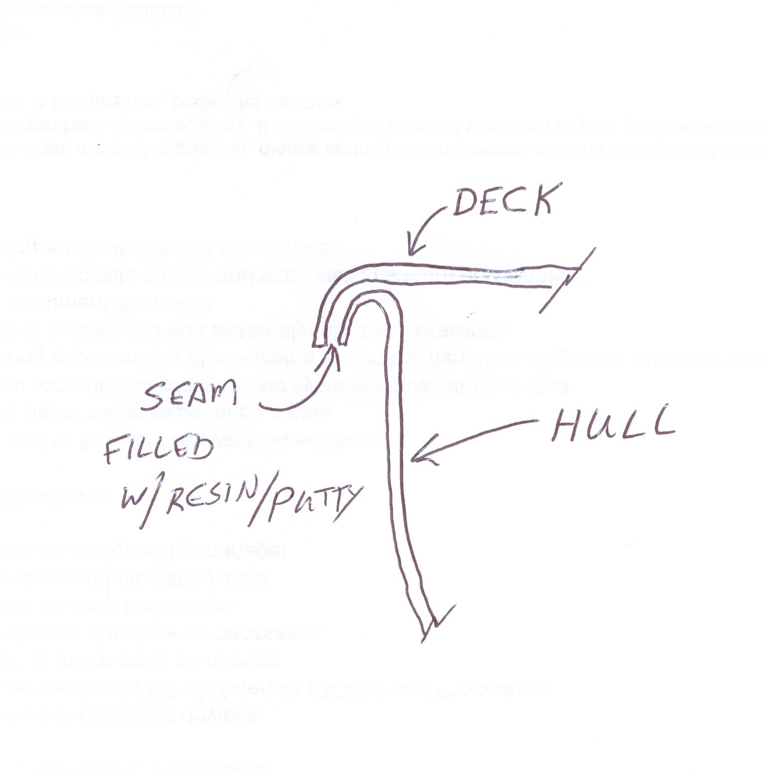

Hull-Deck joint_small O'Day models.jpg Did you see my answer on the main forum page? On second thought, I suspect a hull-deck joint leak. See below for a diagram of how the joint is made.

I googled some photos to find the term "rubrail" and got the idea from there.
Last night in my driveway I took a garden hose and filled the hull with water. There were no leaks from the bottom of the hull - centerboard gaskets included. The one place there was a faint trickle was from the aft hull plug. On the Widgeon it's a screw plug with a gasket that's just about shot. I thought the pressure from screwing it in tightly made up for the deteriorated padding there, but it seems like that might be a place water is getting in from - albeit a very little bit at a time.
I'm a little skeptical that such a small leak would be the source of the amount of water that ends up in the hull after a few hours on the lake, but I'll fix it and take it out and see if that does the trick.
In the meantime, I'll inspect the hull/deck joint and see if I can find anything there, too. That leak wouldn't show as easily by flooding the hull with a garden hose.
