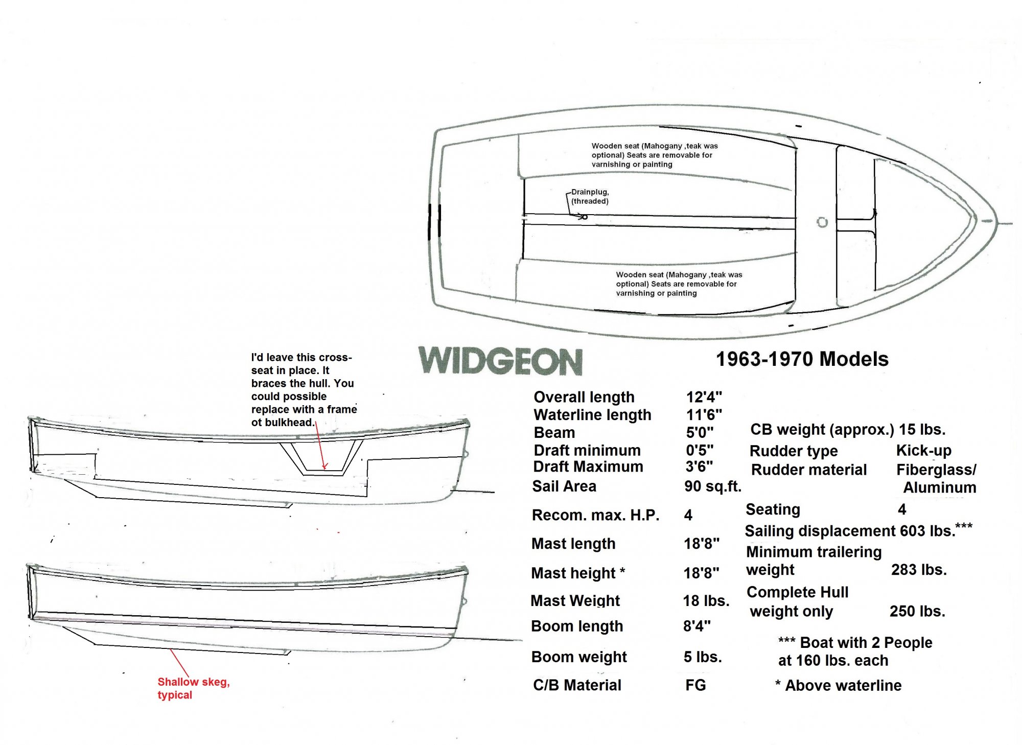

if I can figure out how to lower the centerboard maybe I’ll use this when I’m underway or working on the bit to stabilize..
I would not lower the CB much if it is still there, better to remove it and add the shallow skeg like in my sketch, the CB if lowered too far increases drag and draft, plus you will get water surging up into the CB trunk, adding turbulance and drag (remember when I mentioned having played around one day without the mast on my boat? <GRIN!>) The Cb will also bang back and forth side to side without the sideways forces that sailing exerts on it. I don't see the lever to operate the CB in your pictures. See below for a pic of what should be there.
