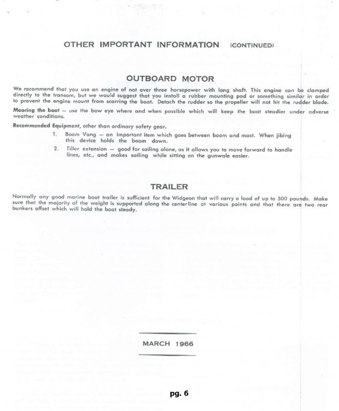

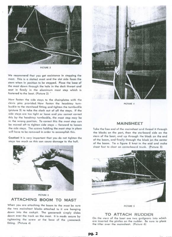

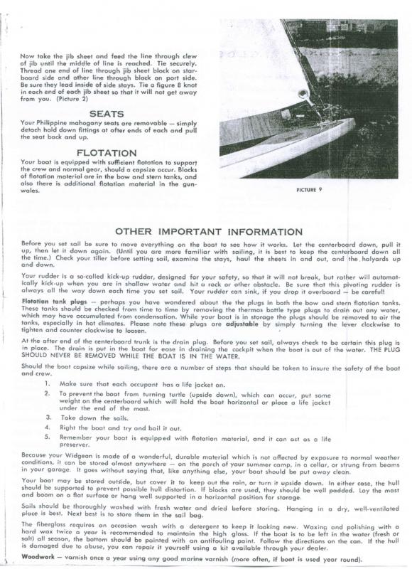

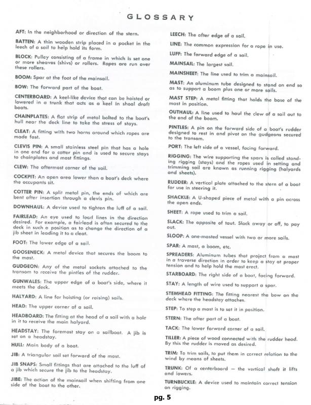

If not... I'll look through my Sprite pics and see if I find anything more helpful ( I'll post a 1966 copy of the Widgeon instructions below, although not exactly matching the Sprite, they may help).
